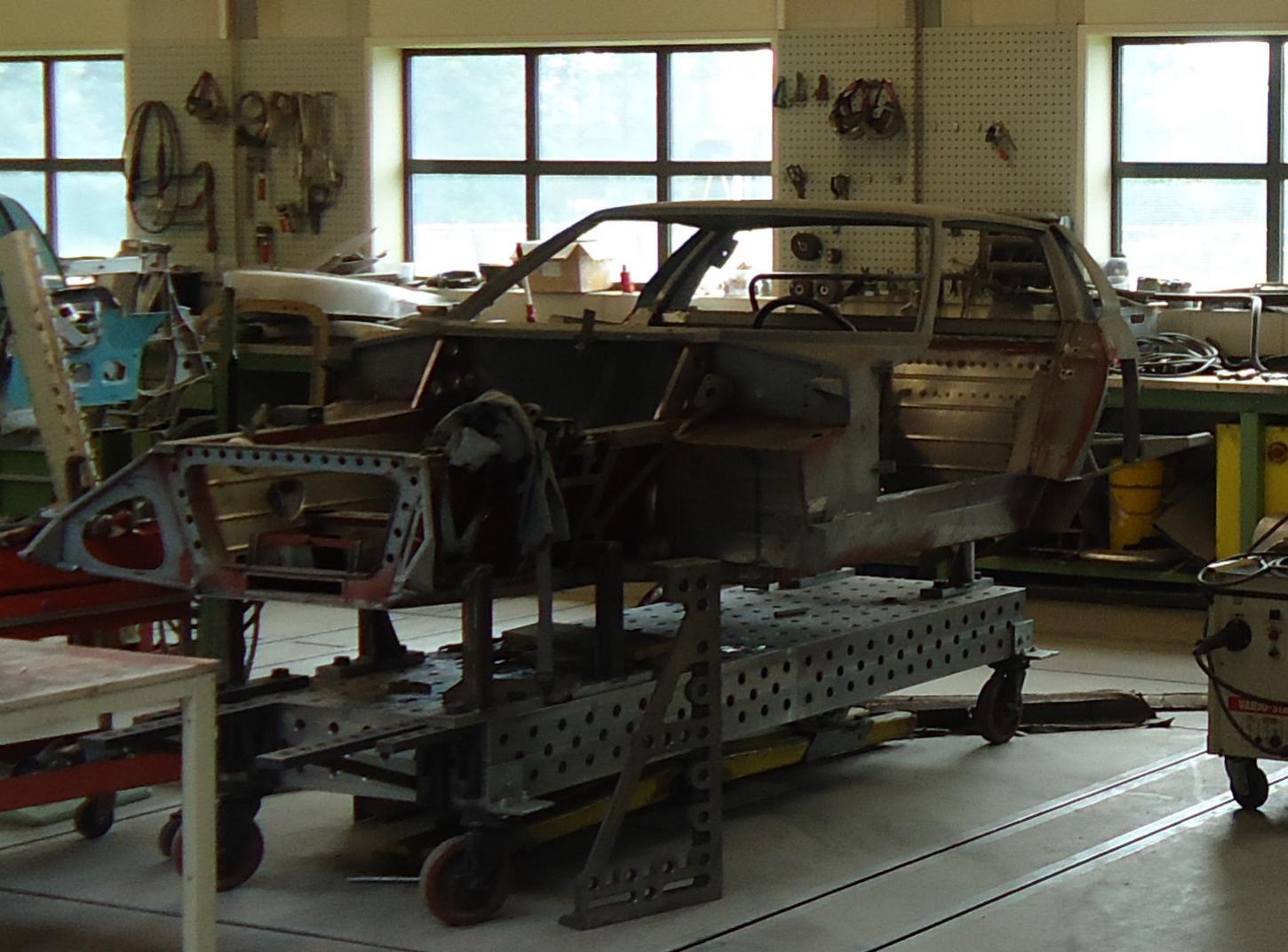

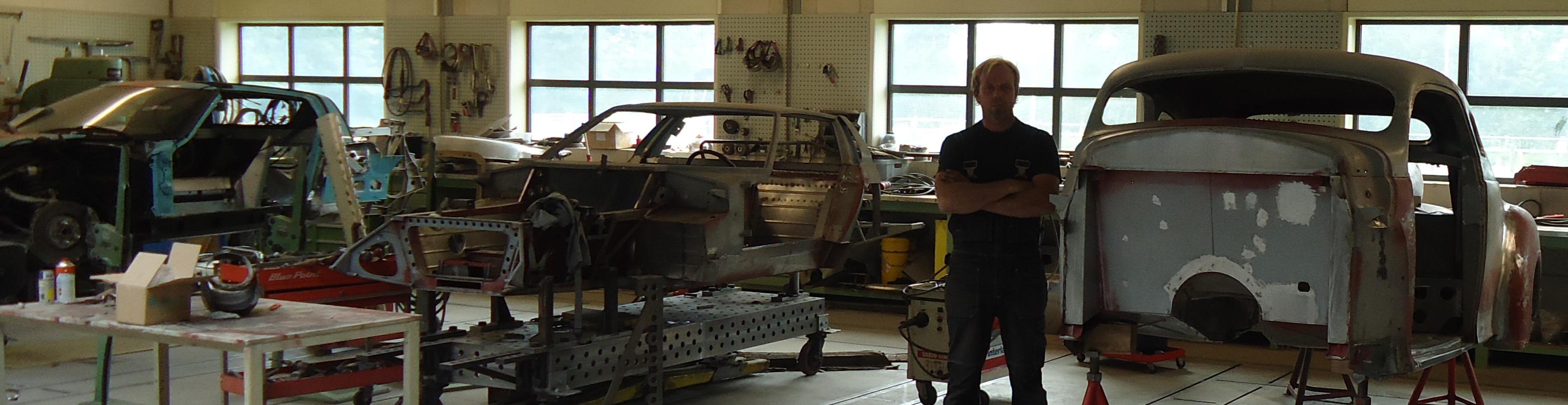

    By the way, the Plymouth and I are in good company: a Lamborghini Miura and a Ford GT. I know they are O/T, but cool all the same. ;)

    Thanks Griznant! This Miura is being fully restored, should be killer when it's finished!

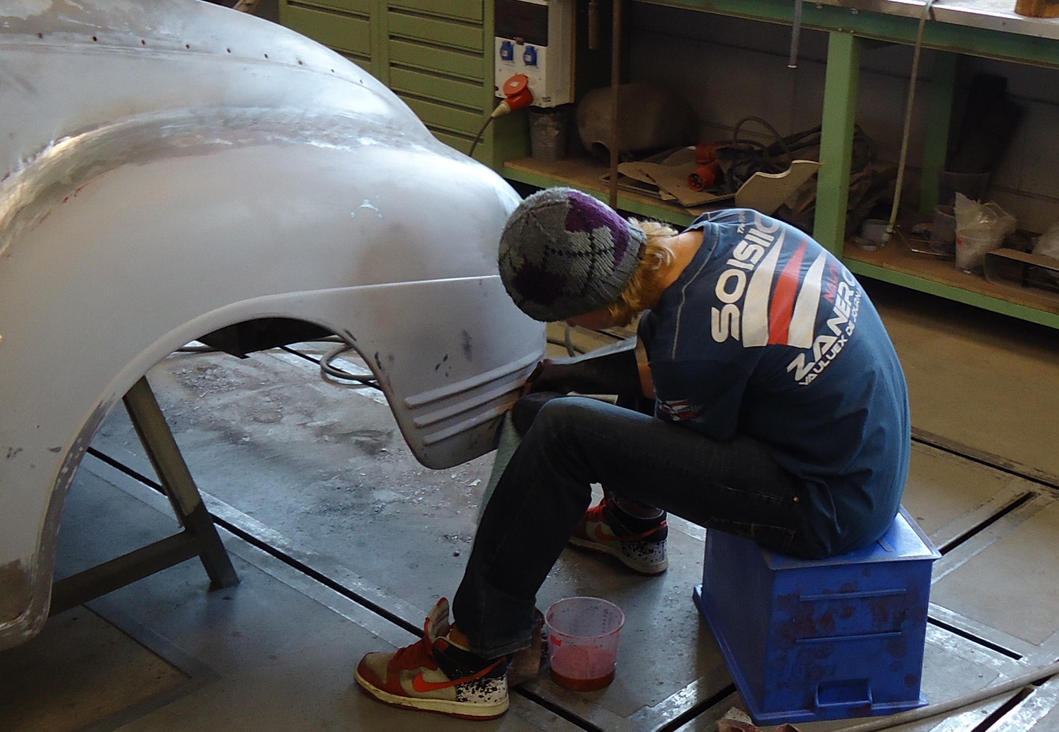

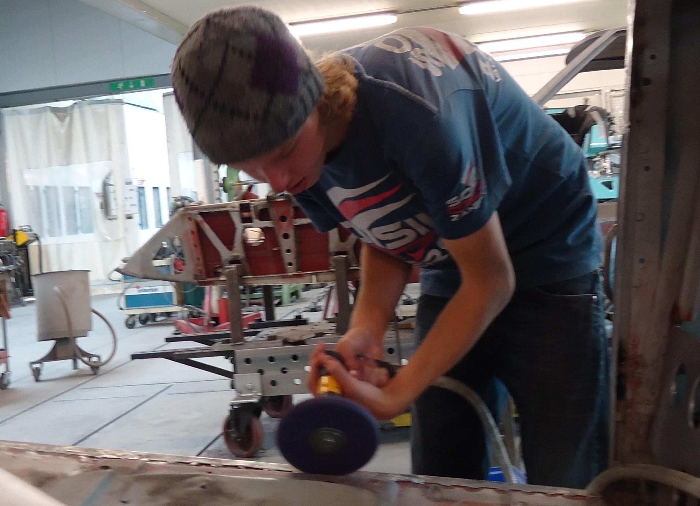

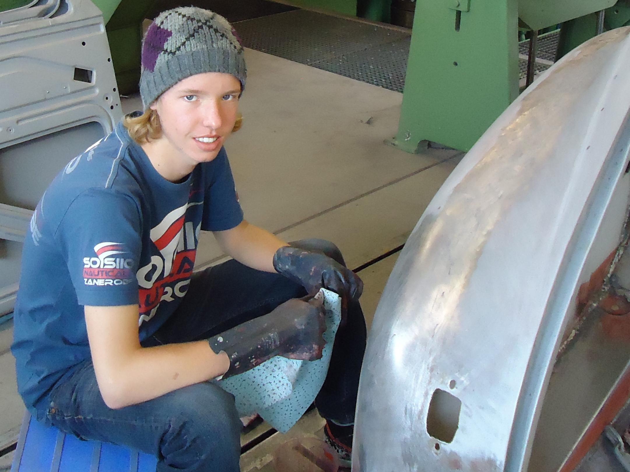

    Considering today was the last day I was able to work on the car before my 2 week vacation, I took my son Julian along to help me. He cleaned up most of the red primer on the outside and underneath the body. I was great to spend some time with him. I'll make a rodder and customizer out of him someday.;)

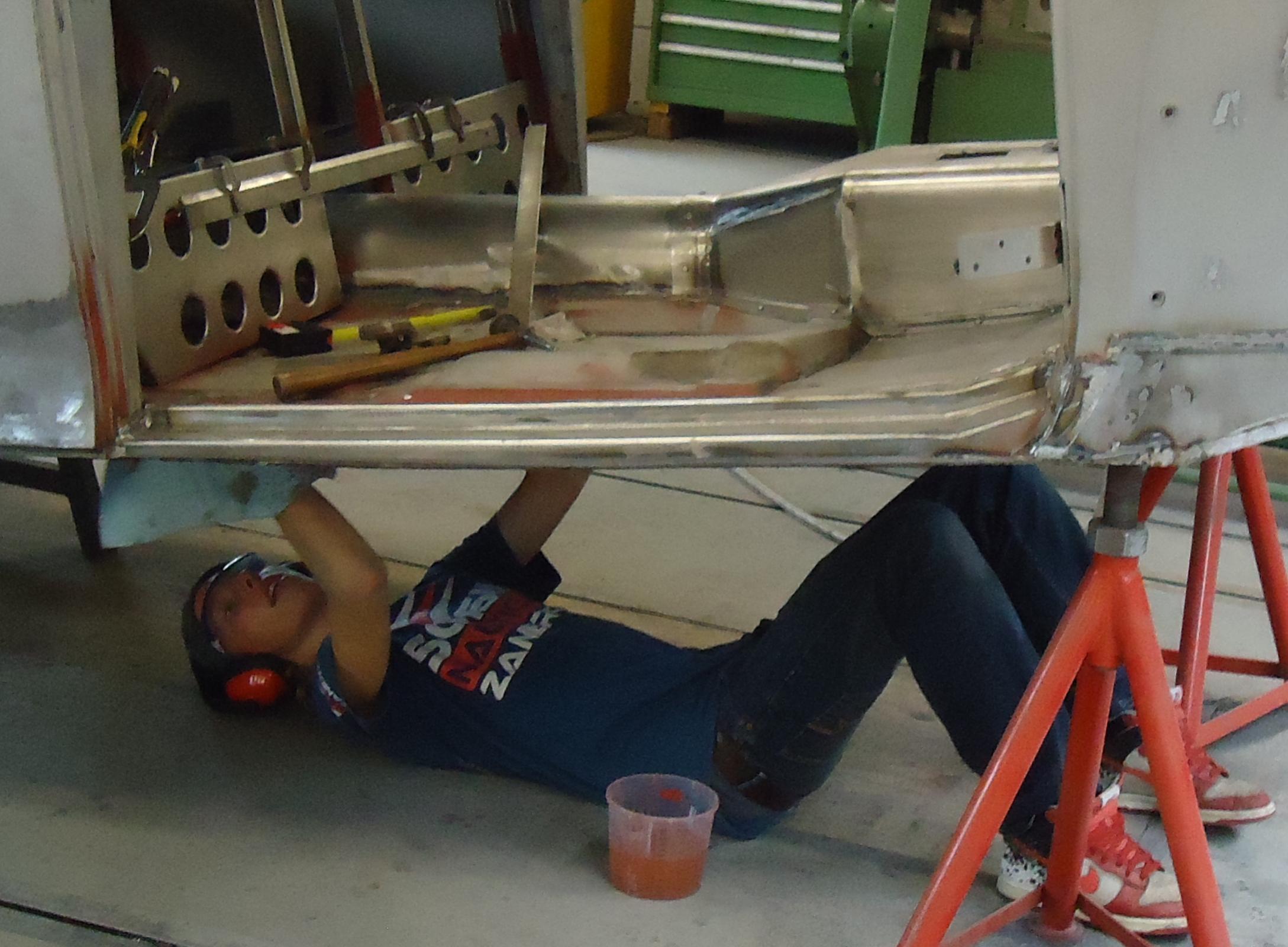

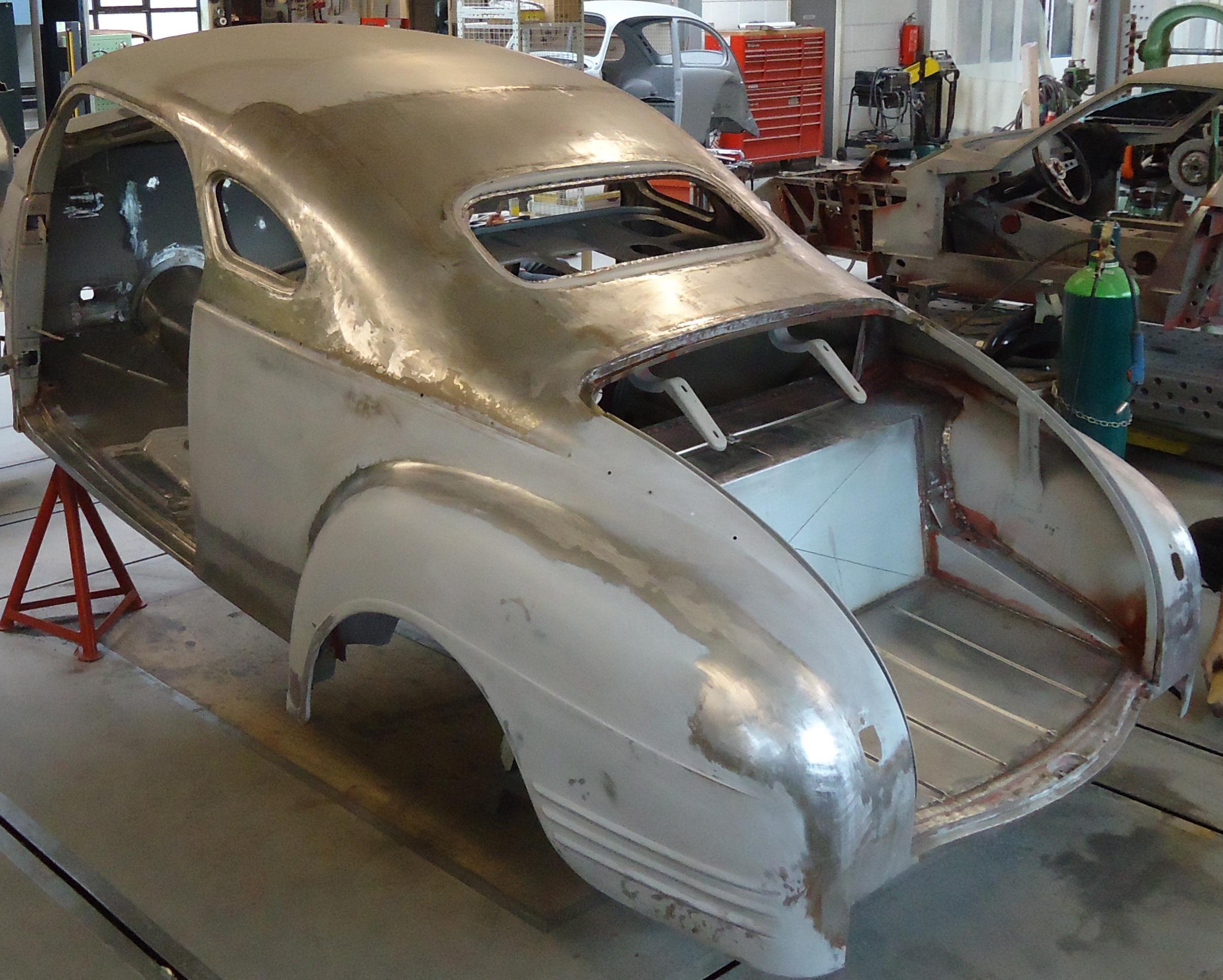

    farmer12

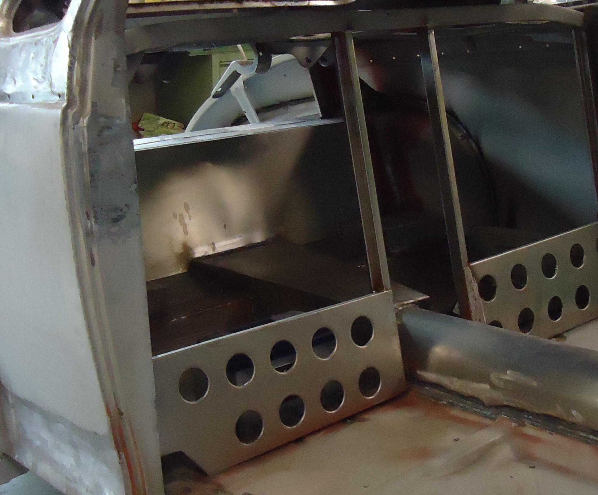

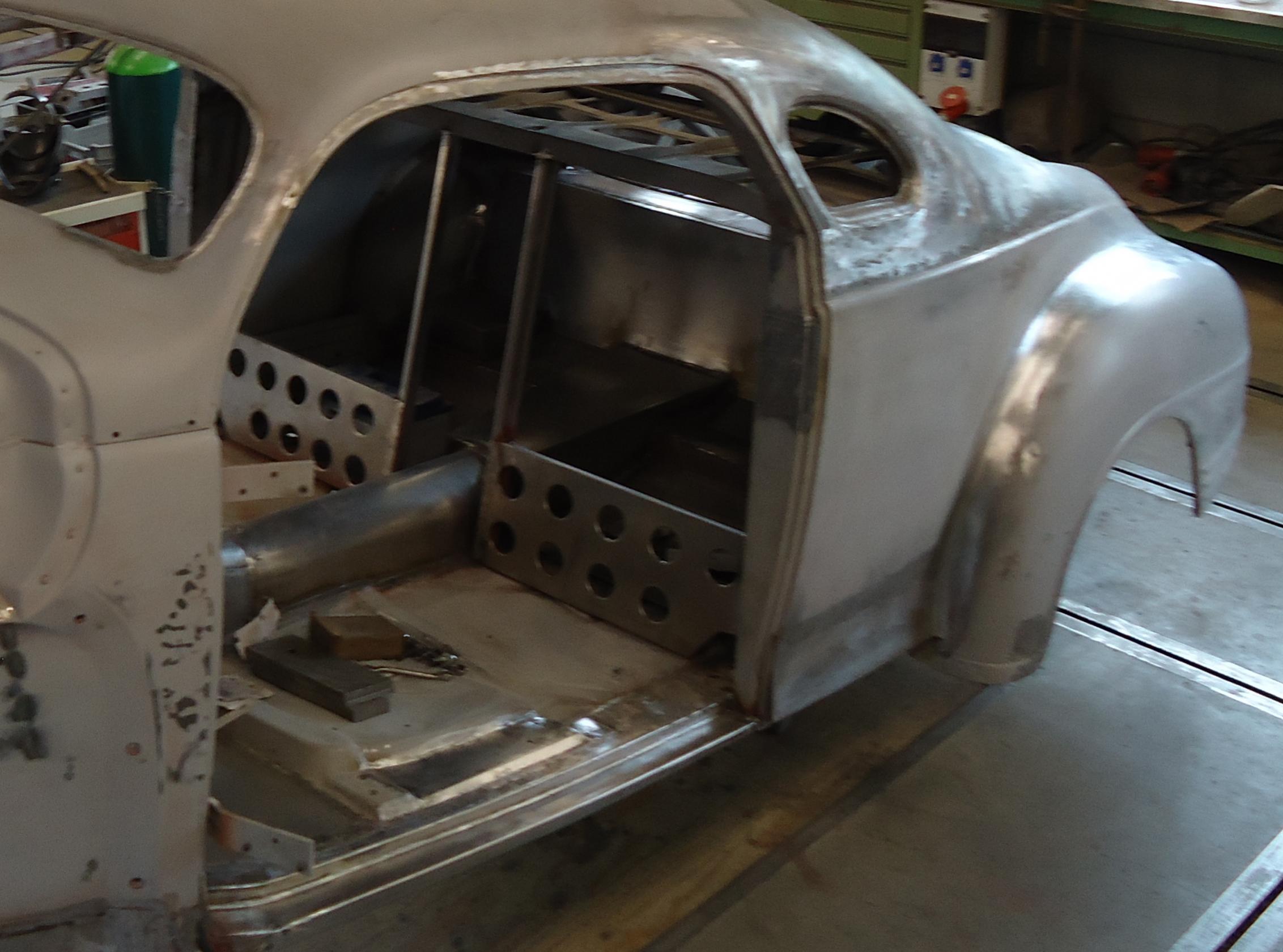

    While Julian was cleaning the underneath, I fabricated the last piece for the top of the c-notch. Welded it and got the angle grinder out to clean it up.
    Next I welded the support behind the passenger seat in place. The shape of the floor has changed slightly when I bolted the transmission cover in place, so a little modification was required.

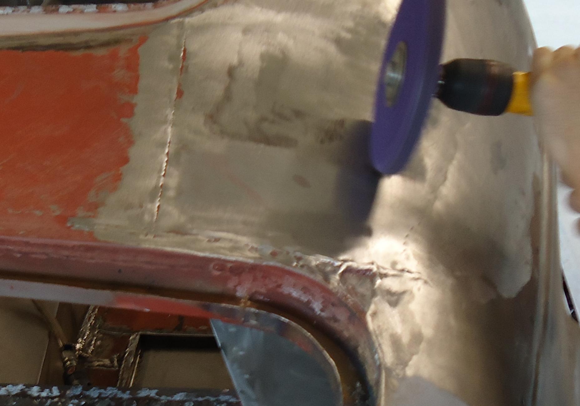

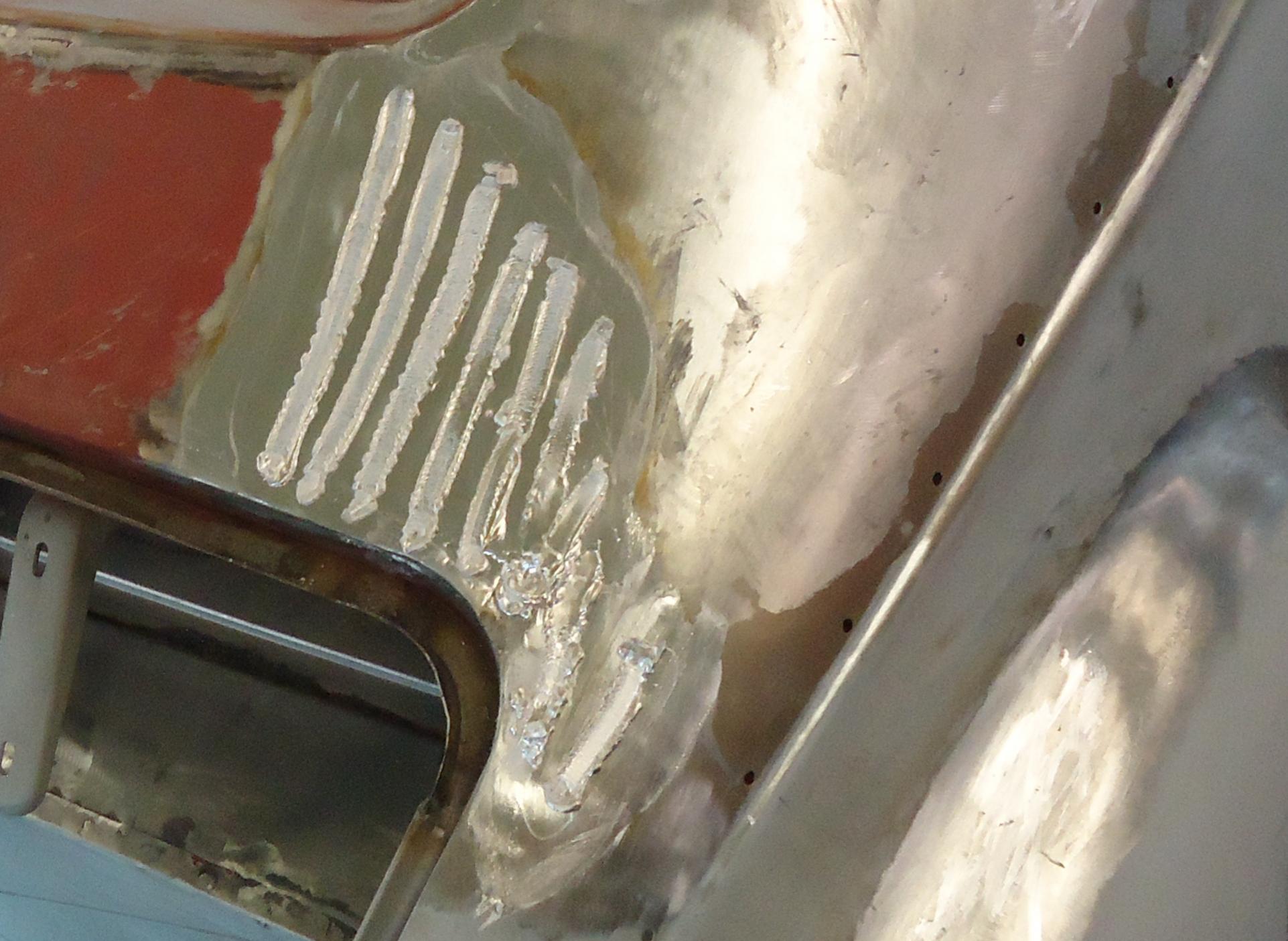

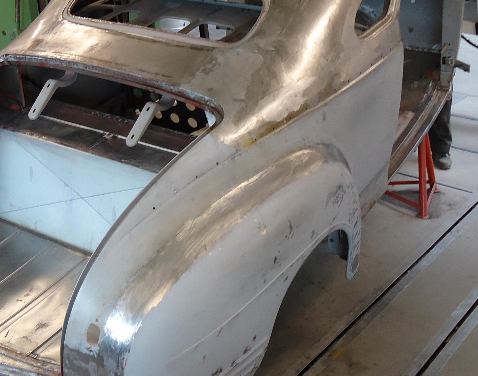

    The area above the trunk was still rough and needed some lead. Cleaned the area and got some lead on there. After shaving the excess off and smoothing it out with sandpaper, the end result was good.
    This is a difficult area as it is the spot where there is a "valley" longitudinally but also a rounded area where it follows the line from side to side. At least I know what I mean!:rolleyes: I think.........
