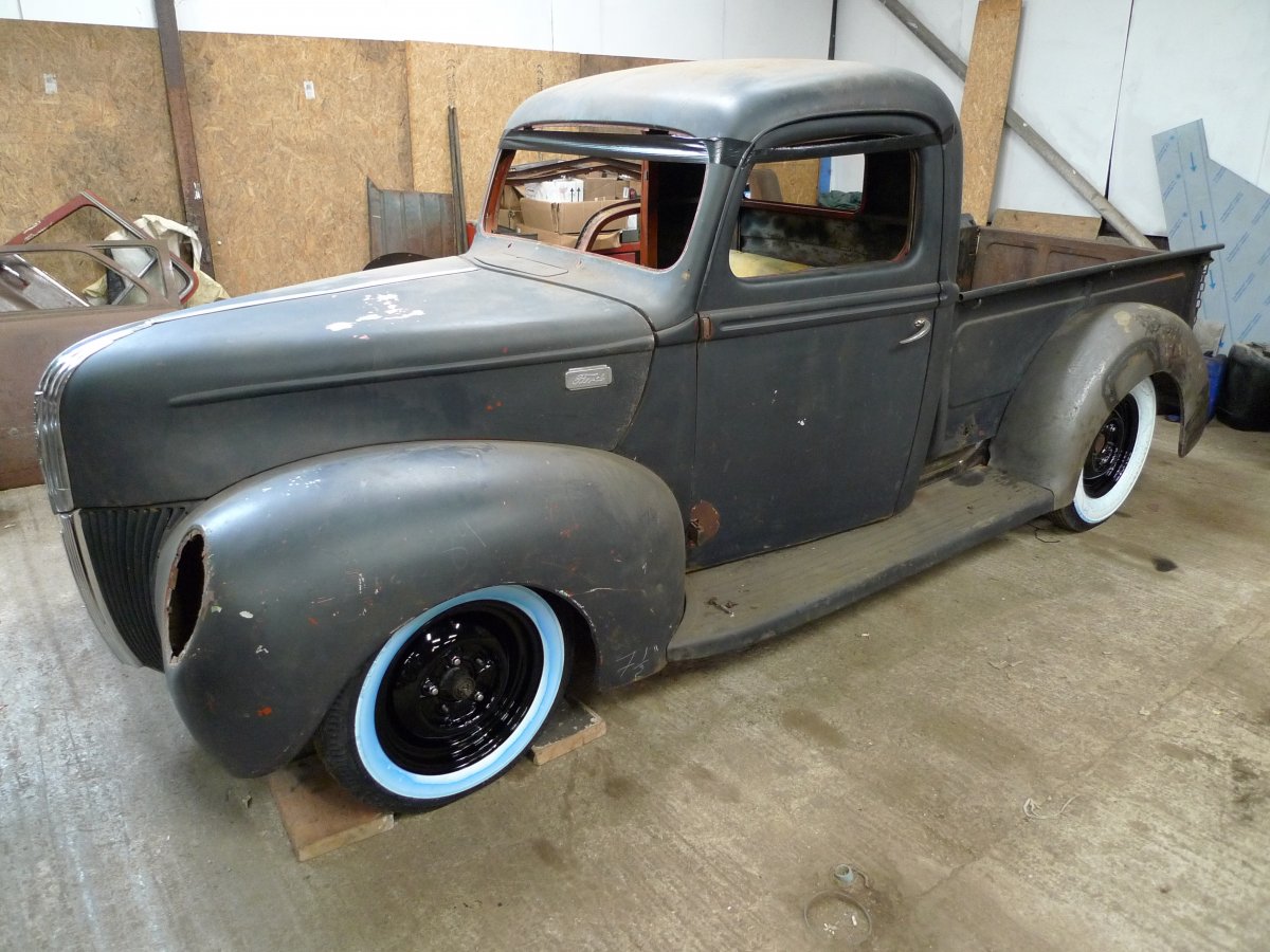

    I have a 41 Ford pickup and am about to rebuild my 283 engine. I’ve been to the machine shop and was told that I need the pistons bored to +0.040 and mains/ends will be +0.010. I don’t want the fastest truck in the world, nor the slowest. I just want it to sound good when at idle! But don’t we all.
    A little bit about the truck. I’m going for a traditional look. I will be putting in a 40 Ford car dash and a 39 opening wind screen, with a 40 Ford column, shifter and steering wheel. I’ve got an early 9-inch back axle with a 3.73 lock out. I will mainly be using it for going to hotrod events and going on the strip for fun. It’s never going to be a daily driver.

    This what she looks like at the moment:
    30TudorSedan, slim38, 1lucky1 and 2 others like this.
