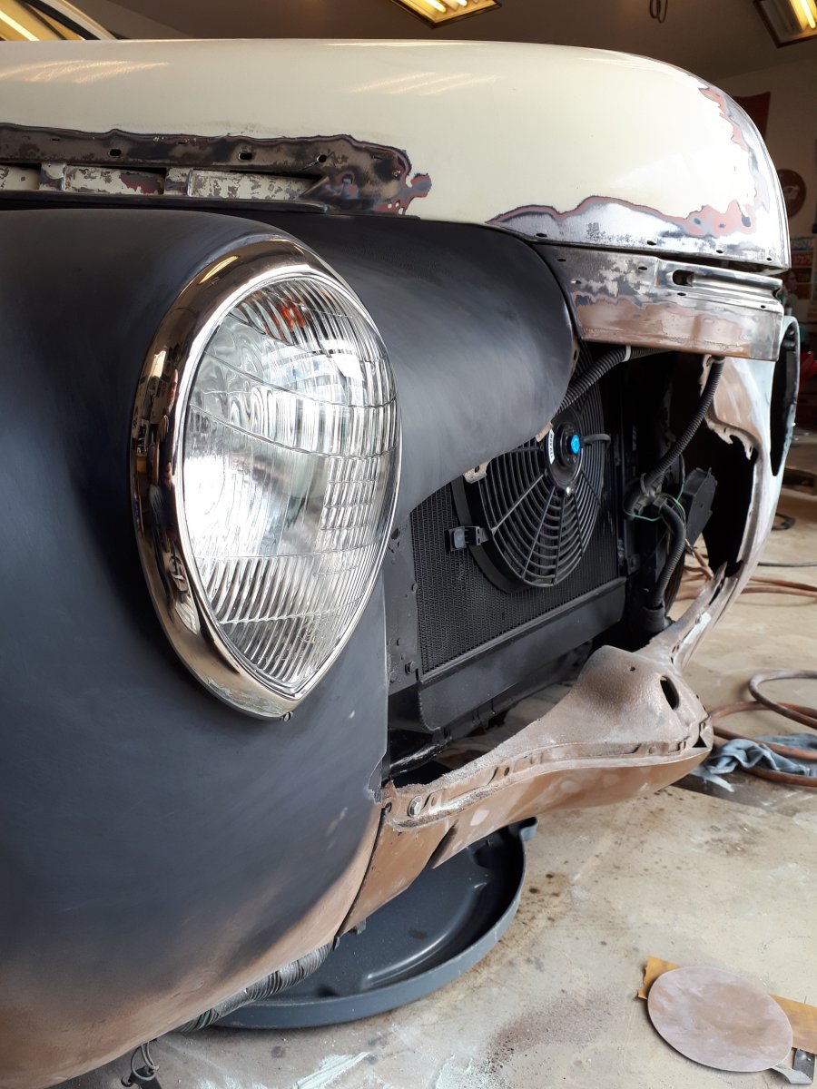

    Wow, you don't waste any time. Looks great.

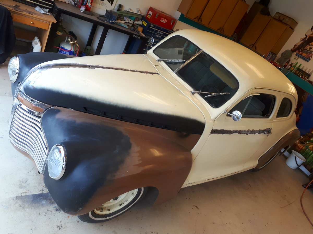

    20180411_120807.jpg onto some mechanical this weekend.
    what a difference it makes in the look. $_59.jpg 20180411_120637.jpg 20180411_120637.jpg 20180411_120712.jpg 20180411_120735.jpg Grrrrrr.

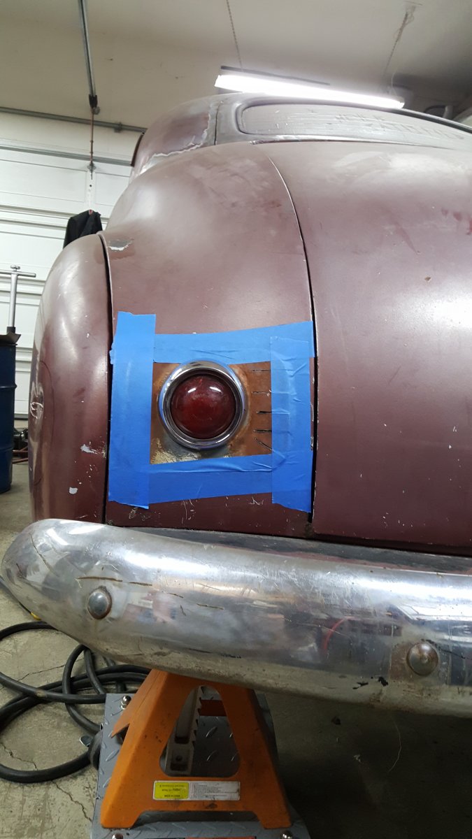

    I think tomorrow I'll pull the rear bumper and have a look at placement of them ventura tailtights.
