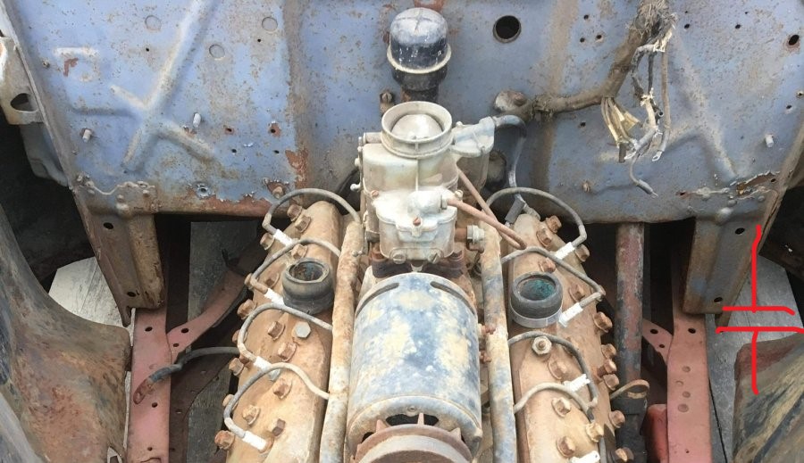

    I am tore down for paint so I can't help with measurements but here is a pic of the cab on the blocks mounted to the frame. Maybe it helps.

    I went back and looked at your thread, just to catch up. On my frame/cab that gap is zero. I think there may be a webbing (1/16 or 1/8 in. thick) and if it helped the front sheetmetal alignment maybe a thin shim. I have a complete new floor stamping for my cab and lays on the frame on top of the blocks . IMG_1990.JPG IMG_1991.JPG IMG_1992.JPG IMG_1995.JPG The second pic shows the "A" pillar mount bo0lt location and that's the most forward mounting point that sits on a block. In the last pic, you can see the distance between the A pillar and the firewall "foot" mount. I think I'd look at the cab floor before I shaved the wood blocks. If that is a '47 cab, it sat on a completely different frame and maybe no blocks. ( don't know the later, ladder frames).

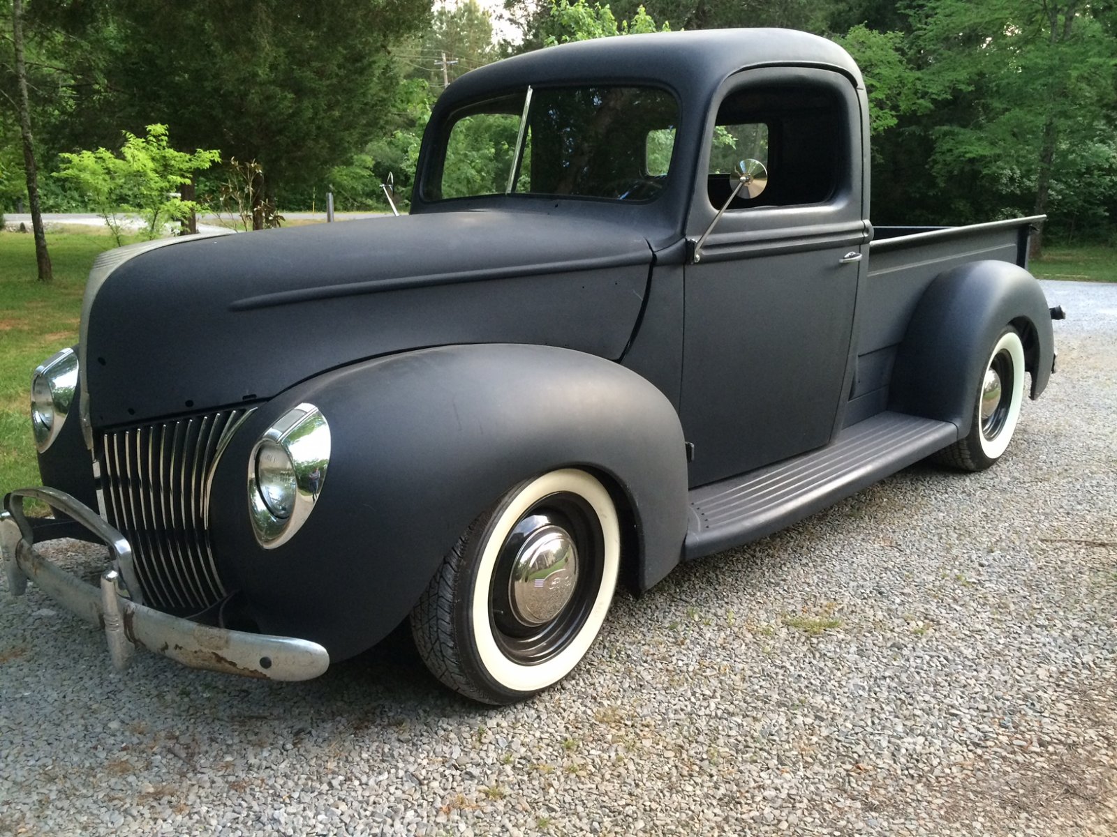

    1. Virginia HAMB(ers)
    It's been awhile but I recall a problem using 40-41 pickup mounting wood with a 47 cab. I vividly remember the smell of burning wood as I used my 4.5" grinder with what I call the slap face course sand paper. I think I just had to taper the top of the wood, along the side, to allow the wood to properly seat on the bottom of the cab. I think the floor of the 47 dropped down sooner and more than a stock 40-41 as it had the gas tank under the seat. Trimmed the wood to fit around the drop for the gas tank and it worked fine as I recall.
    Maybe this will help.
    Good luck,
    Al
    Here's the pickup... wasn't pretty but it was fun! BTW, it had 39 Ford car front fender and grille... yeah, some say they don't fit. I believe Henry Ford had a saying along the lines..."Nothing is impossible as long as you are not smart enough to realize it can't be done."
    Guy that got it after me spruced it up a bit but he confessed he loved the patina that came on it and drove it like that for some time before making it pretty. It was a fun old truck that I built from parts of 14 cars and 12 trucks as I recall.
