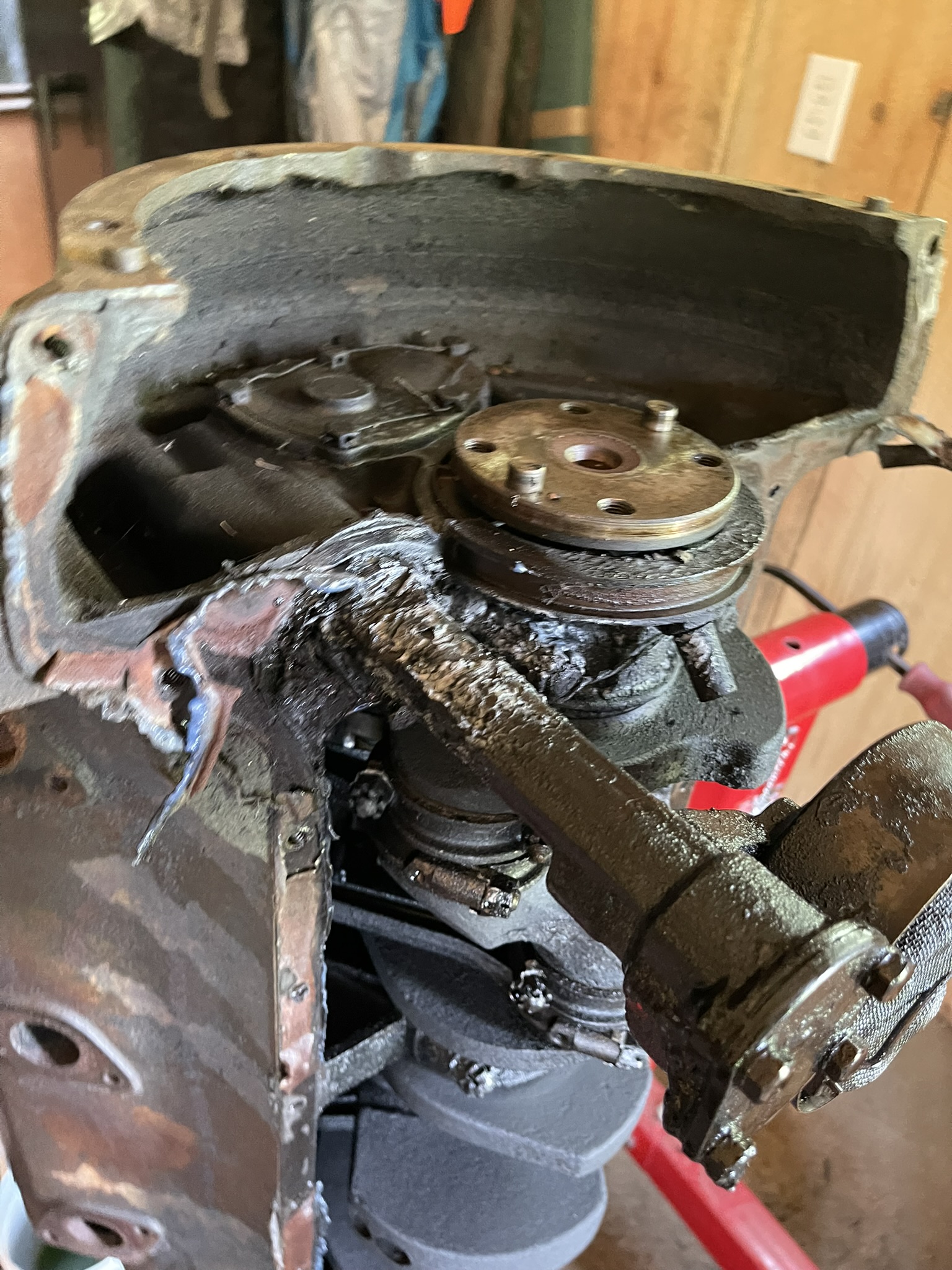

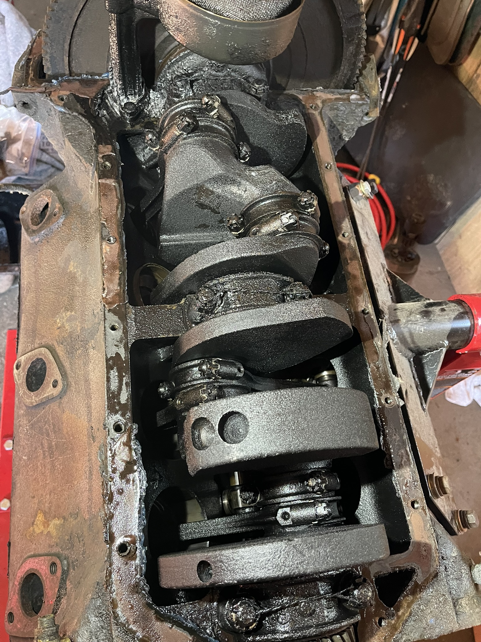

    Oil pan off. Someone liked the blue gunk!

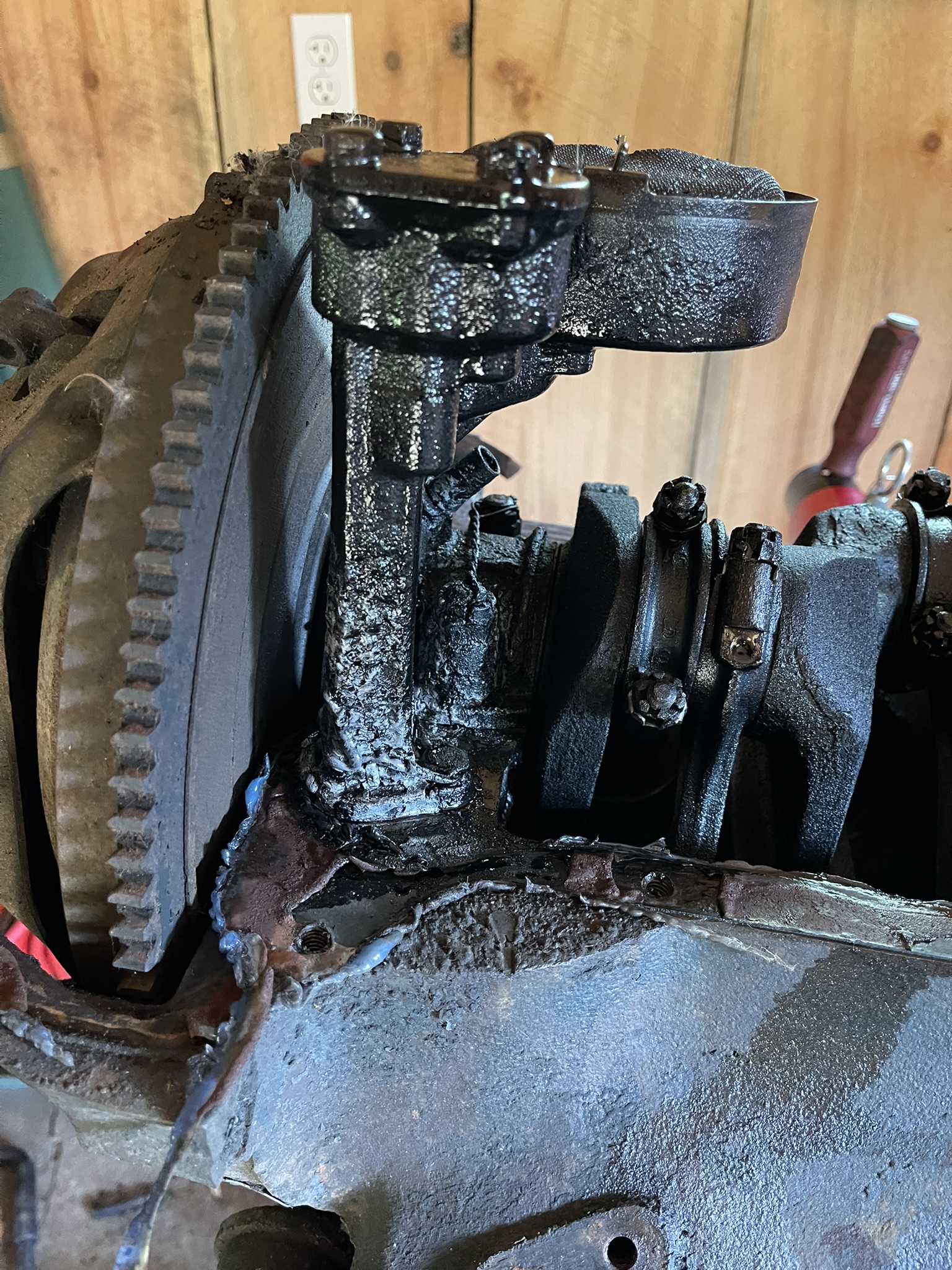

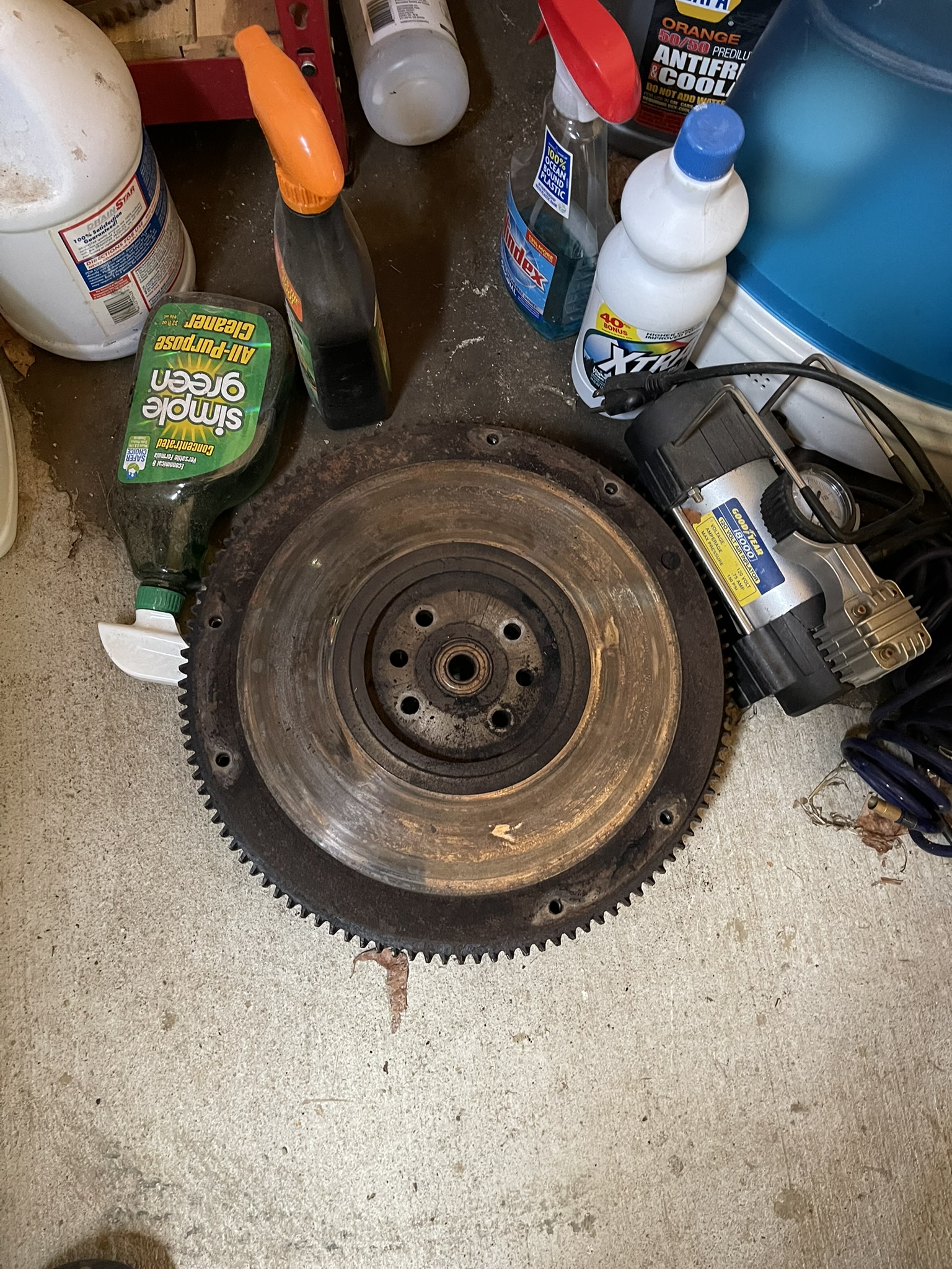

    next is to see if I can drop the flywheel on my foot. I know, rotate the block till the flywheel is on top, then take it off.

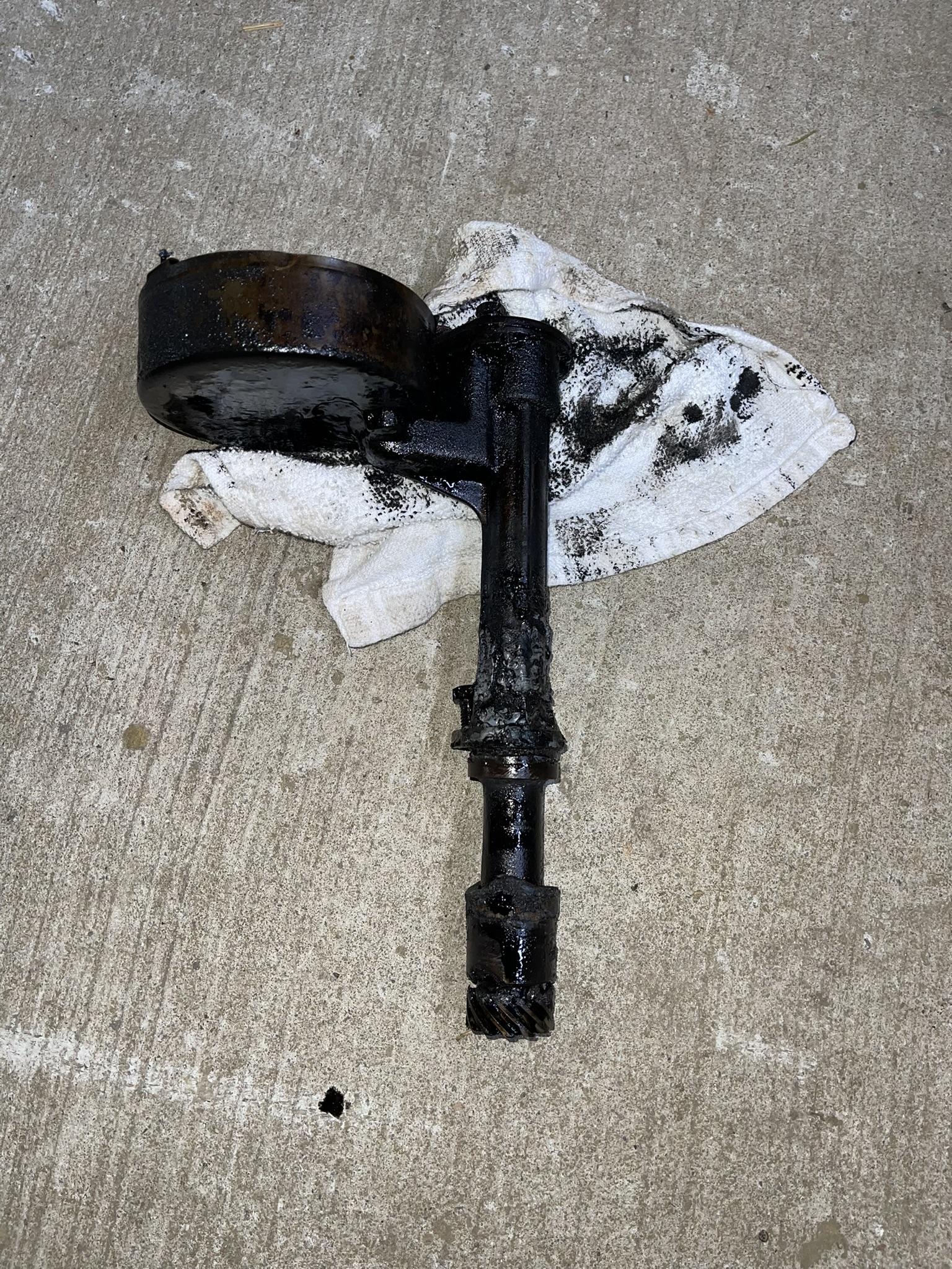

    OK on to the fun job of getting the oil pump off. Who ever rebuilt this was damn good at wiring bolt heads. IMG_8359.JPEG IMG_8360.JPEG
  5. jim1932
    Joined: Jan 26, 2011
    Posts: 1,160
    jim1932
    1. Ford A and B speed
    Researched on the HAMB the difficulties getting pump off. I used a towel for protection and a pipe wrench a couple twists and it worked right out.. into the diesel bucket it goes.

    OH.... if anyone is reading this on how to tear town a flathead. There is an annoying pan bolt on the opposite side by the starter.

    Much lighter than a Model B flywheel.

    OK...... advice needed. I am kind of at a point of no retern between cleaning it up and running it as is, or doing a full rebuild. How do you determine if it is sound enough to run? Story is it was pulled out of a truck. makes sense, not tons of wear, but typical 80 years of old oil.

  10. Grumpy ole A
    Joined: Jun 22, 2023
    Posts: 250
    Grumpy ole A
    To me it depends on the main and rod bearing wear and the cylinder wall wear.
    winduptoy and Outback like this.
  11. plastic-gage and micrometers are your friend.

  14. winduptoy
    Joined: Feb 19, 2013
    Posts: 3,974
    winduptoy
    I'm a hack...and this is a local build for you.
    just 'overhauled' engines that have gotten me a lot more smiles....$/fun ratio and going to cruise, pose, not race....assembled so it doesn't leak oil...though that can be a dust suppressant and rust inhibitor
    not too much cylinder bore scoring or wear indicated by ridges...'reasonable' journal to main clearance
    no cracks in the engine deck
    what kind of ridge do you have in the cylinders?
    what do the crank journals, rods and mains visually appear like? how dirty/scored are the bearings
    same goes for the lifters and cams...a good looking at, has someone put adjustable lifters in it, a sign it was internally worked on at some point
    valves appear good....
    mic the rod and main journals on the crank...how close are they to the dimension for stock diameter, .010" under, .020" etc... then....
    I have used the tin foil method to check crank/rod to journal clearance
    this works best if you have all rods out for checking the mains...and leave the main caps off all but the one you are checking
    then check rods one at a time...keep track of what came out of where
    most foil is .0015" thick...measure it though...I cut a square patch out, place it on the journal and re-torque to spec.
    try to turn the engine over, if it turns freely you have more than .0015" clearance
    add another square, making sure you don't wrinkle or fold any edges over...re torque...if the crank turns freely, the clearance is larger than .003" if it locks up, your clearance is between .0015" and .003" wonderful
    get the idea.....
    with your bore gages, taper or out of round is going to be cause for ponder....though I use inside micrometer that I got on the cheap in a antique shop...I am an admitted hack that has gotten away with a lot of shade tree stuff over the years depending on how far from home I was going to travel with the set up....I won't go into the 220 Silver Diamond IH engine 'overhaul' in my Hough loader that never leaves the property
    hope this helps and good luck and this is worth what it cost you
    Larry

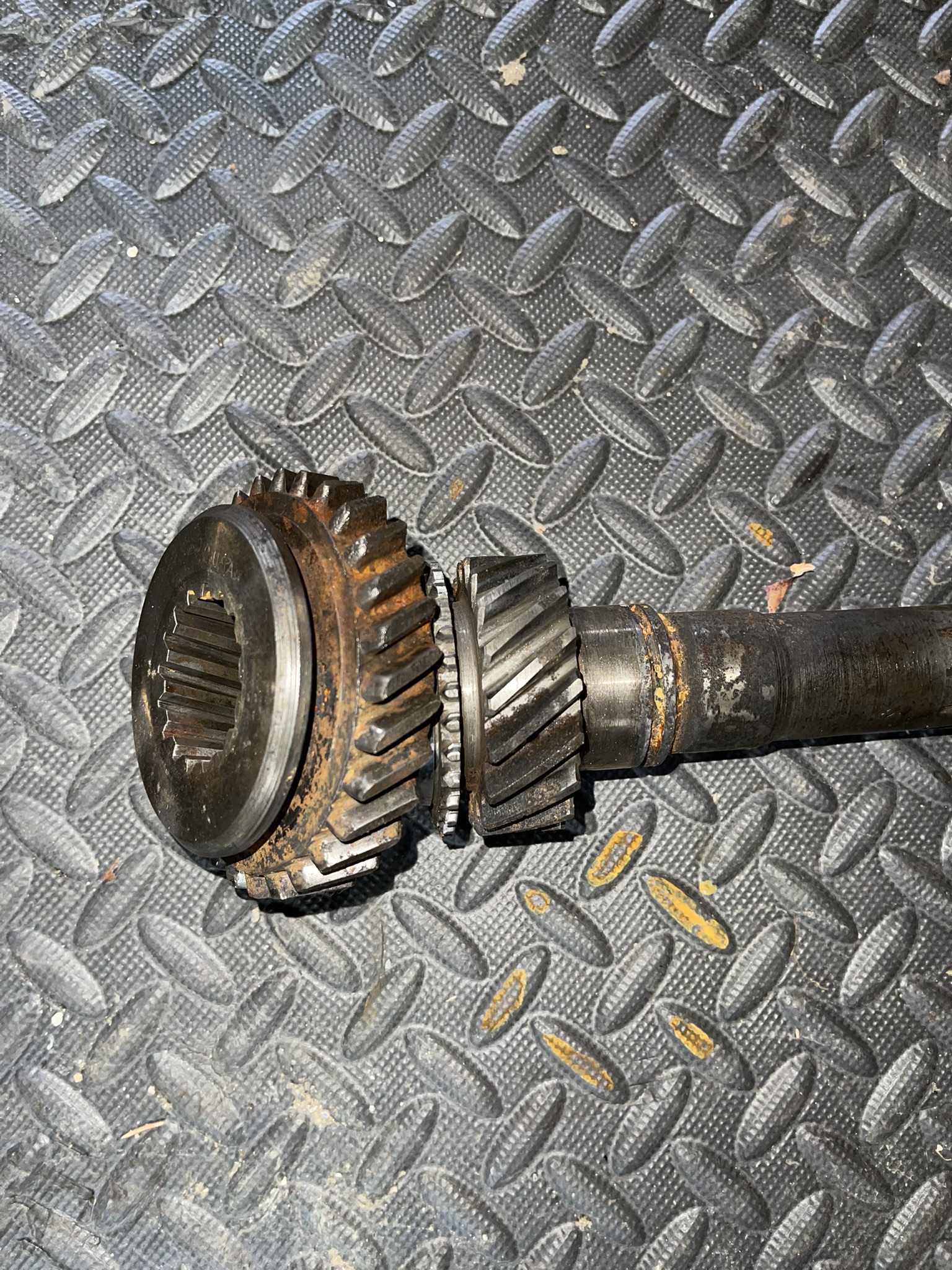

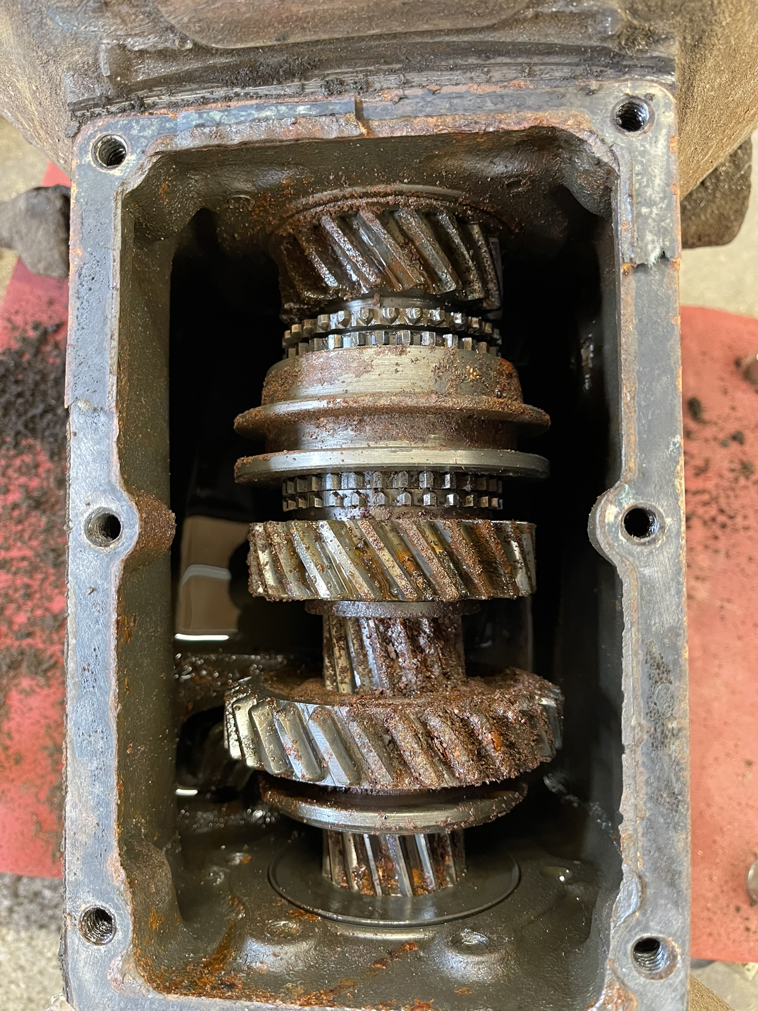

    It looks rough!
  16. jim1932
    Posts: 1,160
    jim1932
    Yeah, forgot to post that. Gears are all pitted.

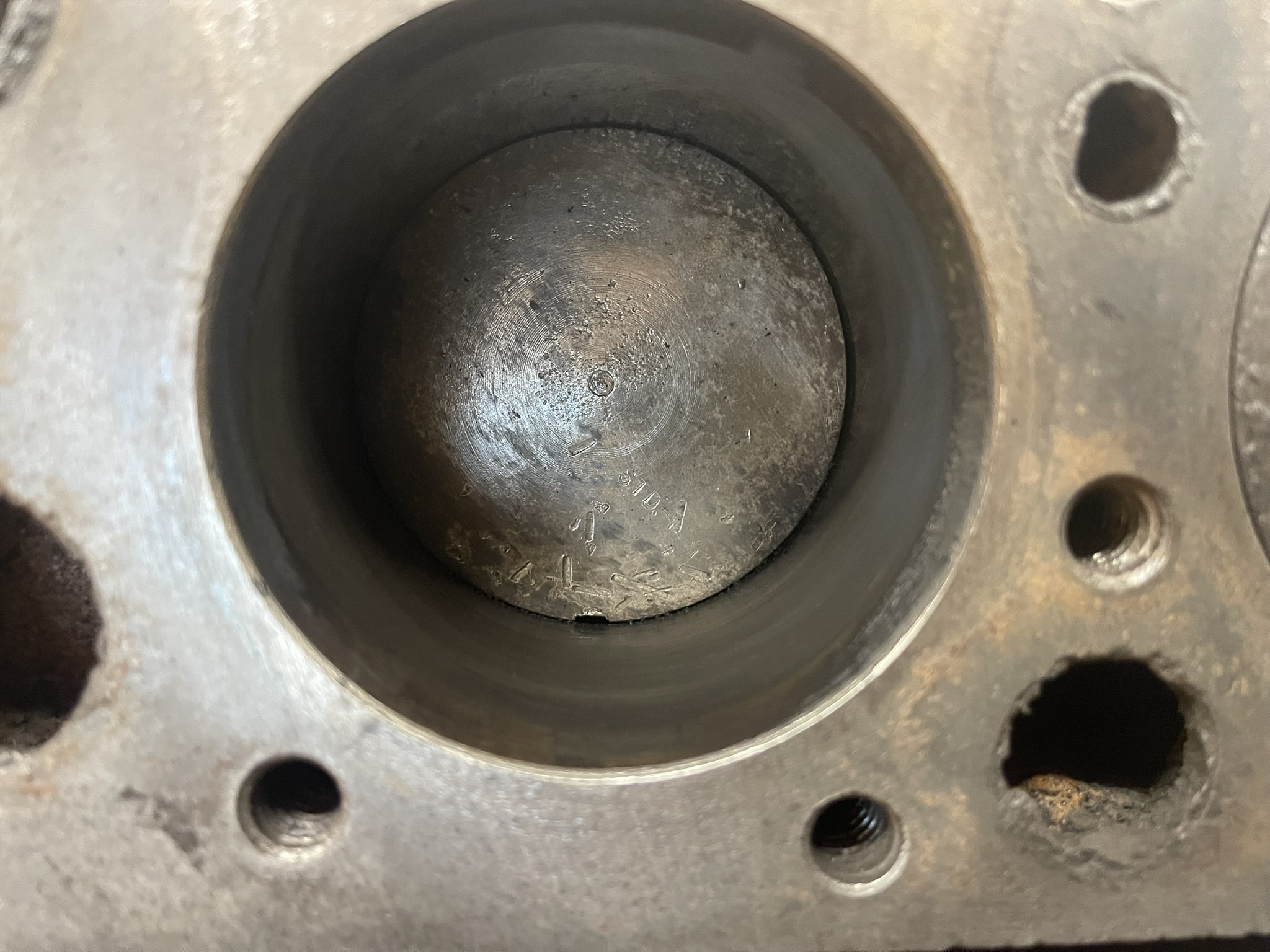

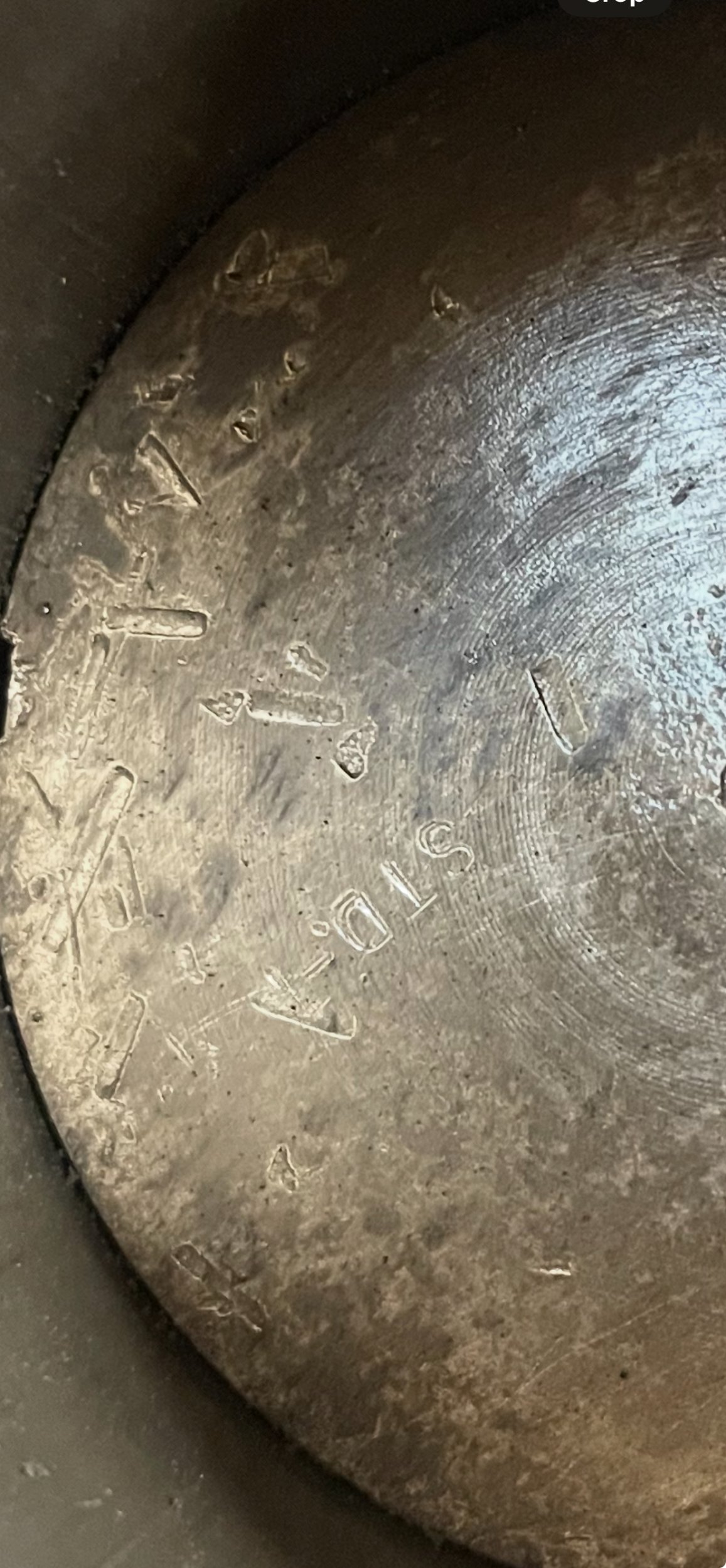

    OK So no matter what, I am tearing it down and marking what came from each cylinder. So time to go after the valvetrain. the pistons say STD so I am wondering if this cylinder broke a ring. Walls look good though.
  18. winduptoy
    Posts: 3,974
    winduptoy
    something got down the intake....
    that bore looks good....real good....I have a feeling you are going to get lucky

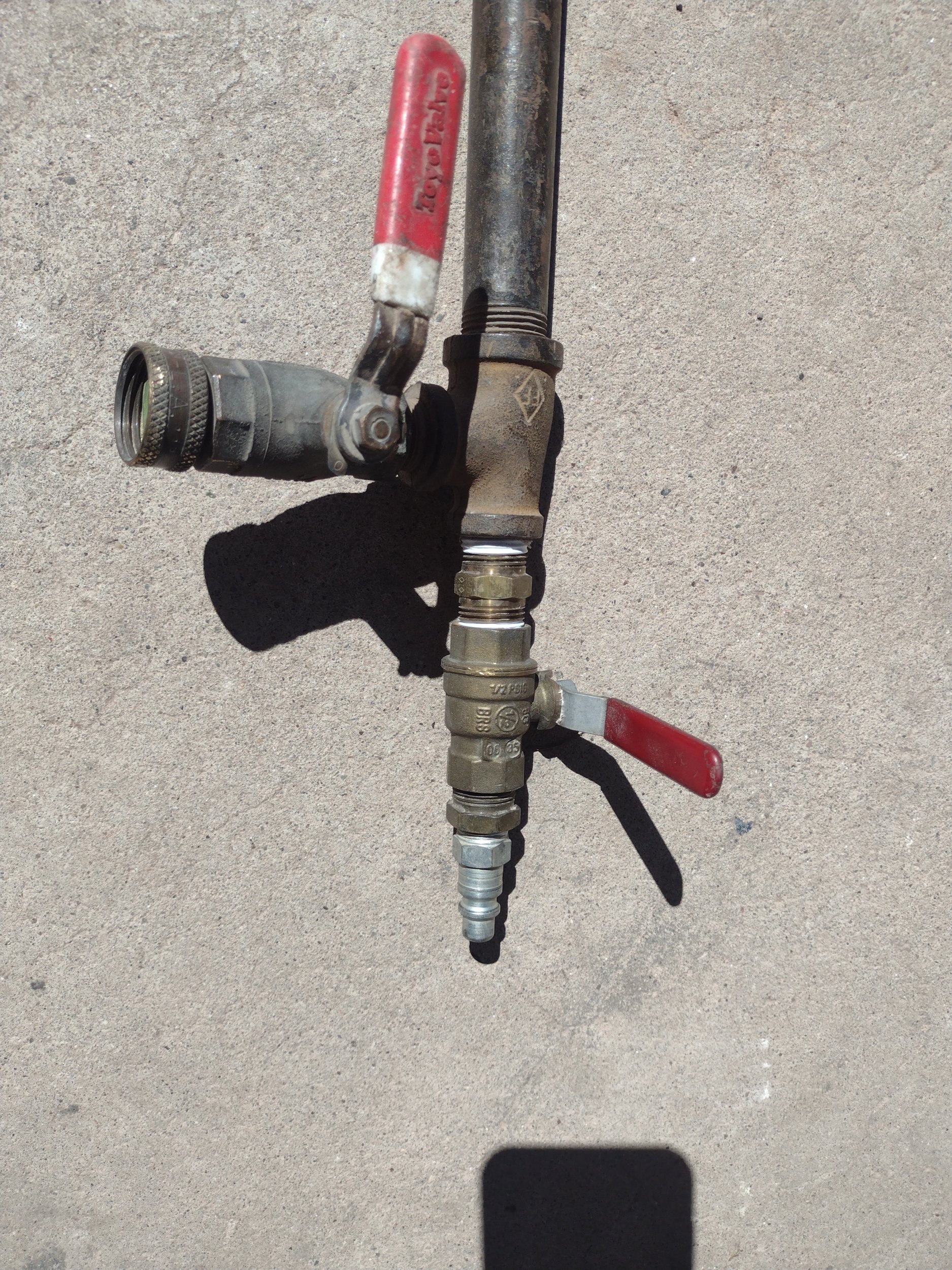

    I hear you big time....I might just be inclined to deep clean all internals with diesel fuel, verify everything doesn't look like it is going to fly apart, three stone hone and cast iron ring it... using the standard pistons in it....you do have a groove cleaner....every local builder needs one
    then back flush the cooling system after you get everything together in the car, I'll take a picture of my local build, backflush set up.... use Iron Tite cooling system cleaner after it is ready to run....drive it....drain and re-back flush
    thinking out loud.....it is $/fun ratio
