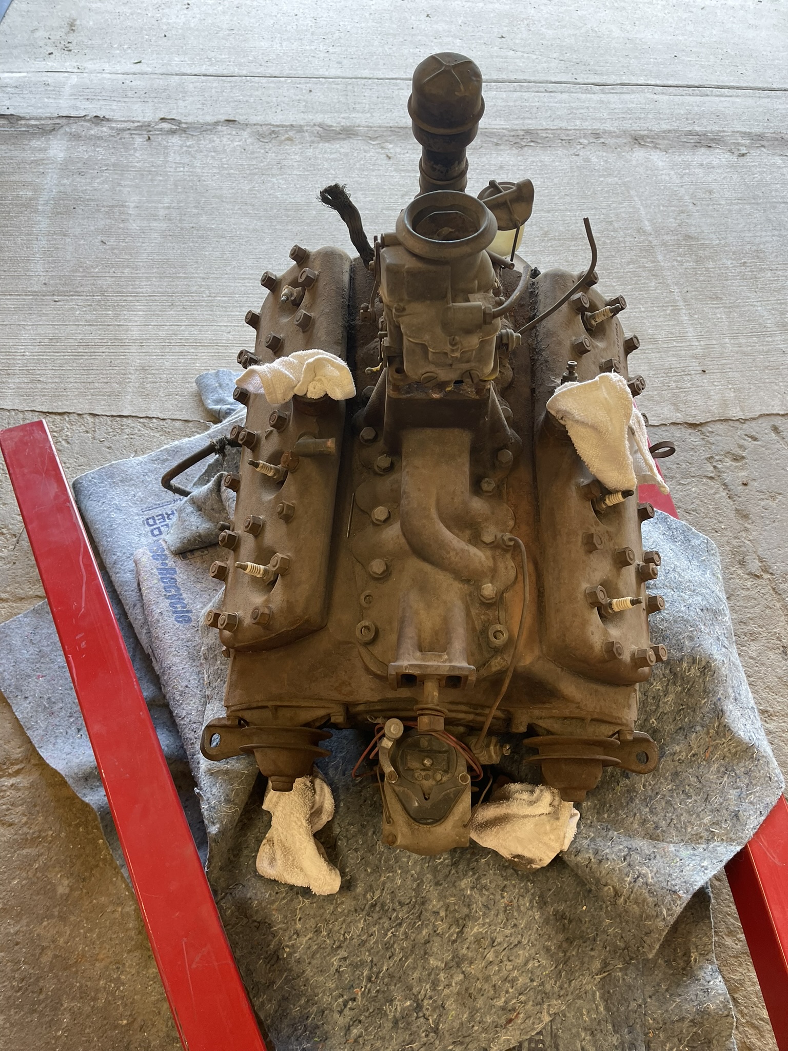

    So, not sure I can live up to the title, but I found a motor and 39 trans on marketplace 4 miles from my house.

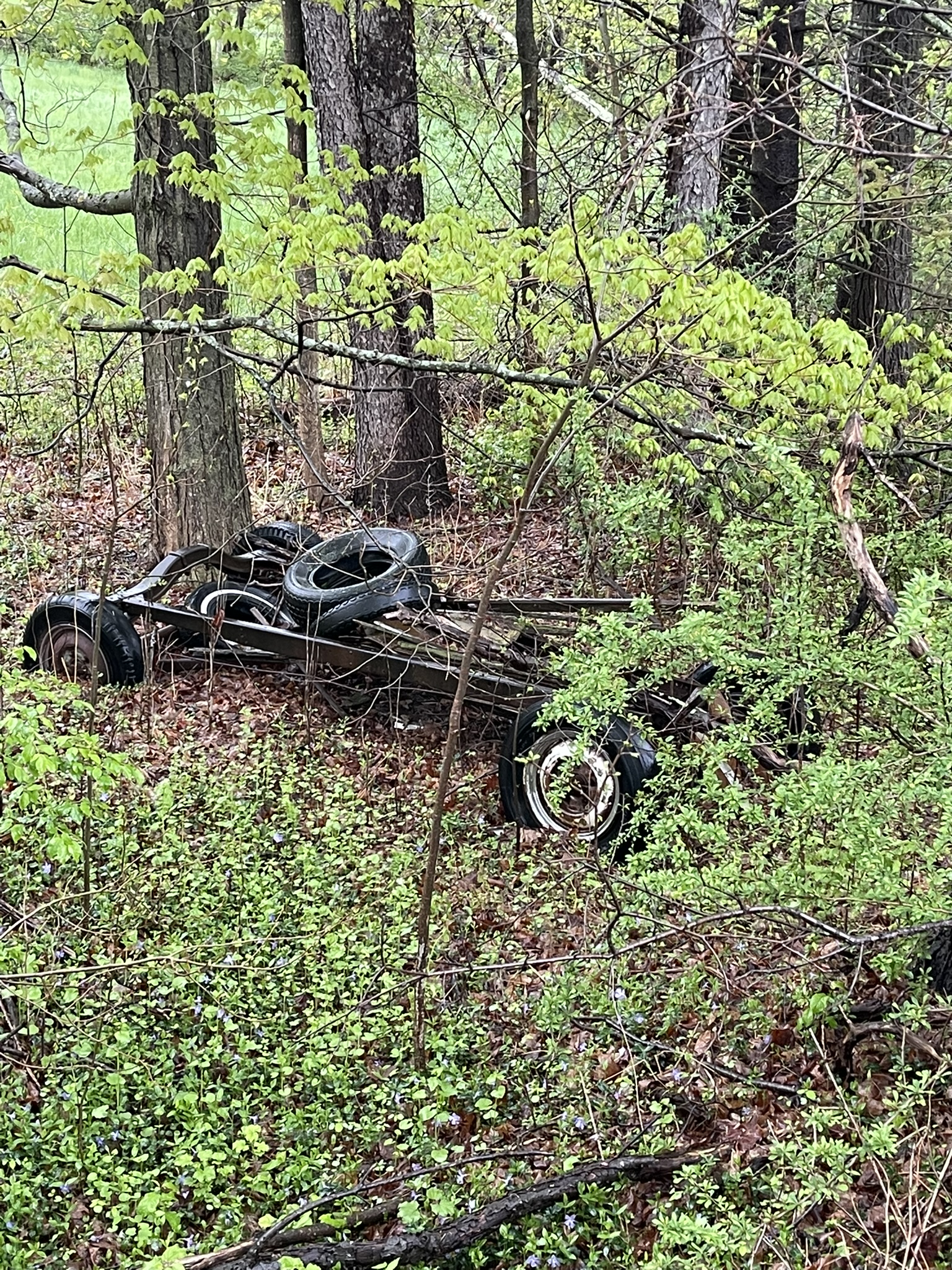

    IMG_8292.JPEG IMG_8277.JPEG couple days later took my tractor to the cemetary a mile down the road ot clean up some stuff and saw this over the bank. The owner of the property indroduced my parents. Pretty sure it will be "Free just drag it out". The car gods are shining on this one.

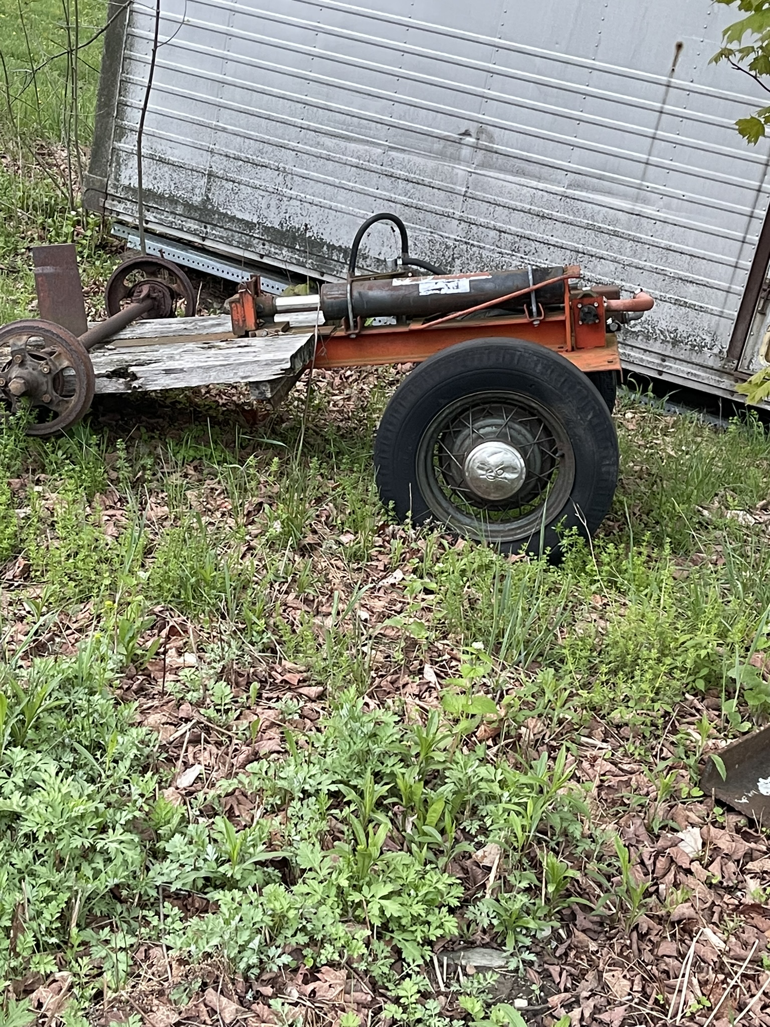

    Just registered this trailer my next door neighbor gave me 3 years ago. I may need to open it up to see if it is viable for the car....... if not al least there are two wheels and hubs LOL

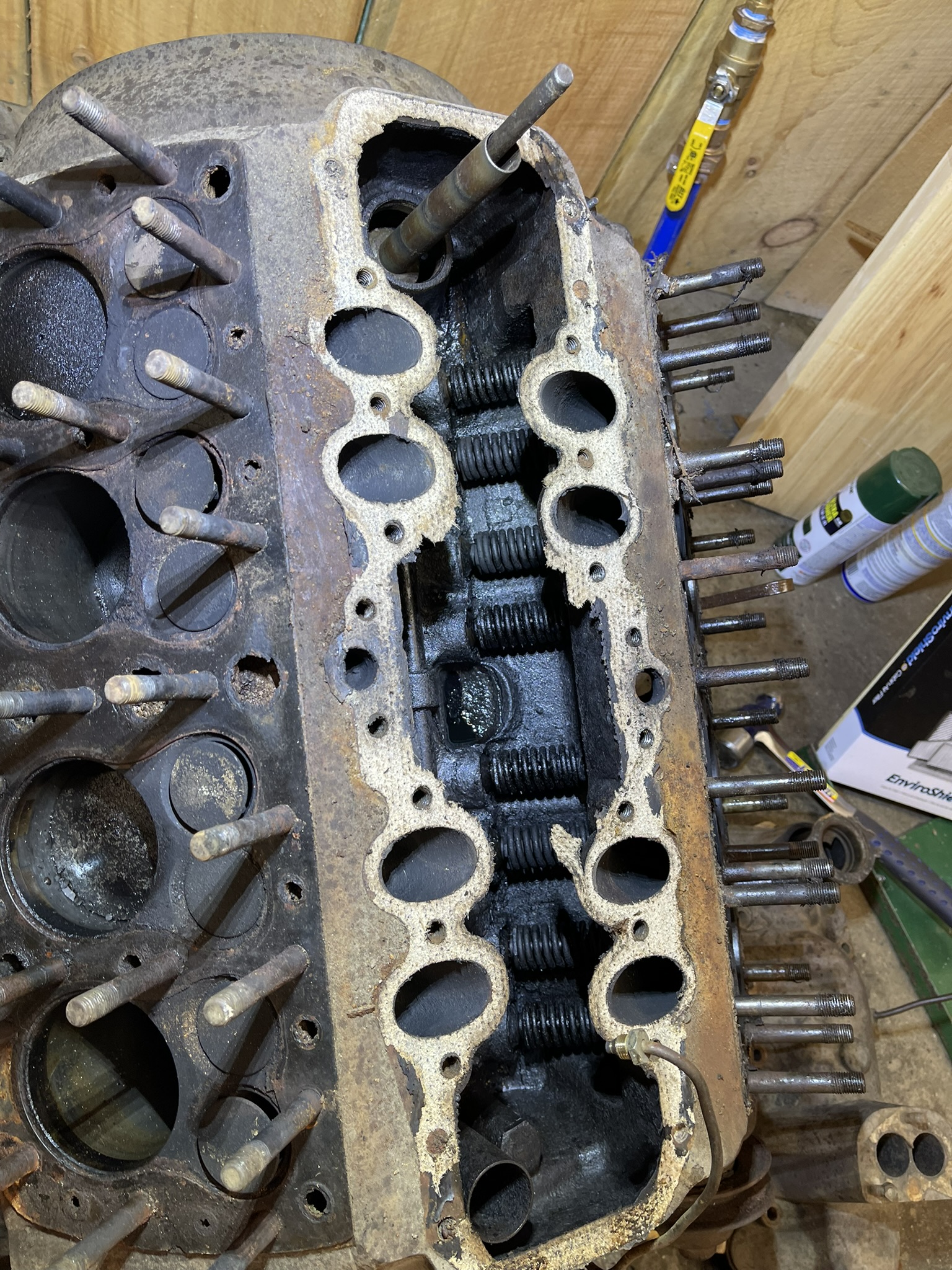

    exercising patience on the one stubborn stud on this side, but motor looks good so far. The rtv on the head gasket on the other side is worrisome, but we will see.

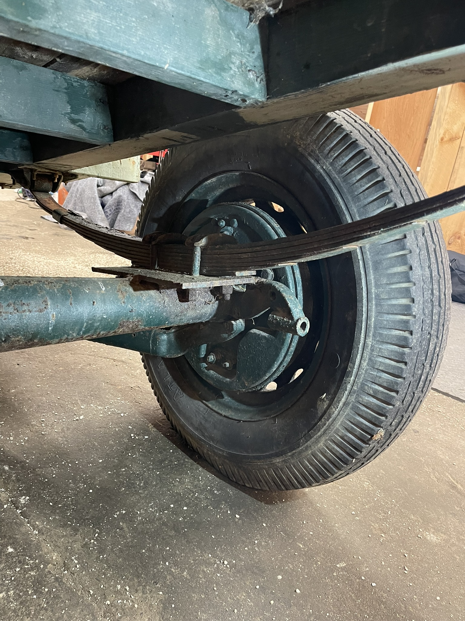

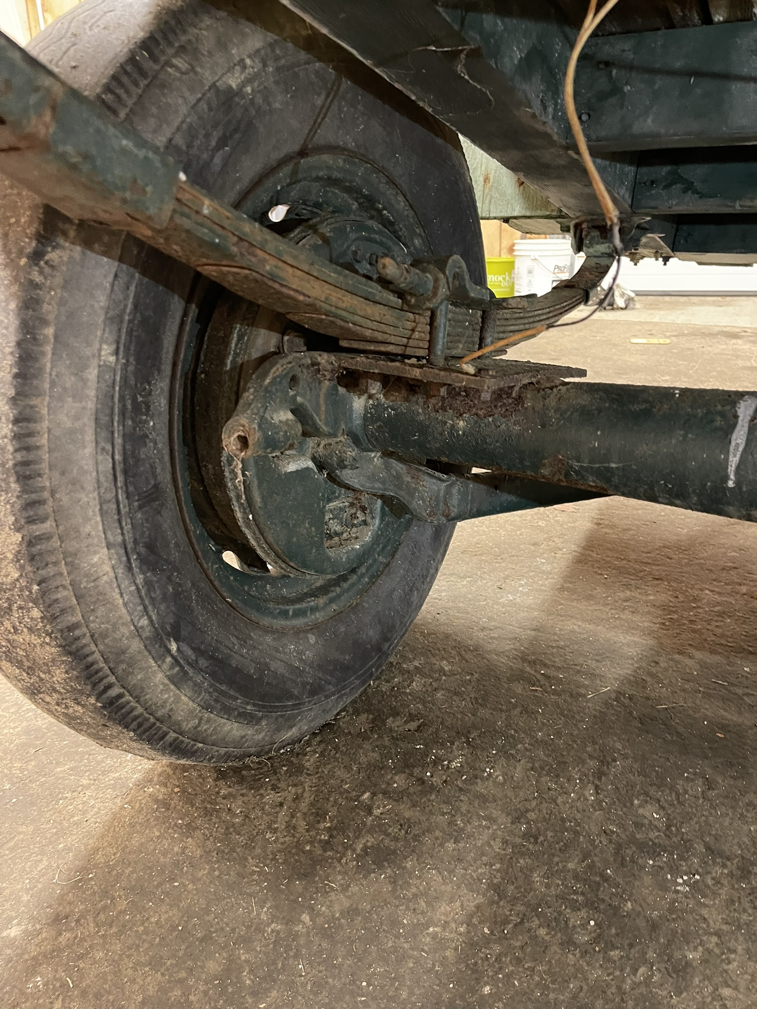

  12. From here i can just see the shadow of hydraulic style brake backing plate so that makes it a 1939 Ford rear end. Finding everything so close to home is a blessing in this day and age. Time saving at its best.
    of course there are no gears in it and the springs are welded on........
    IMG_8315.JPEG IMG_8314.JPEG Nothing but water in the rearend. No gears either though. Wheels are good and have all the hub cap clips.

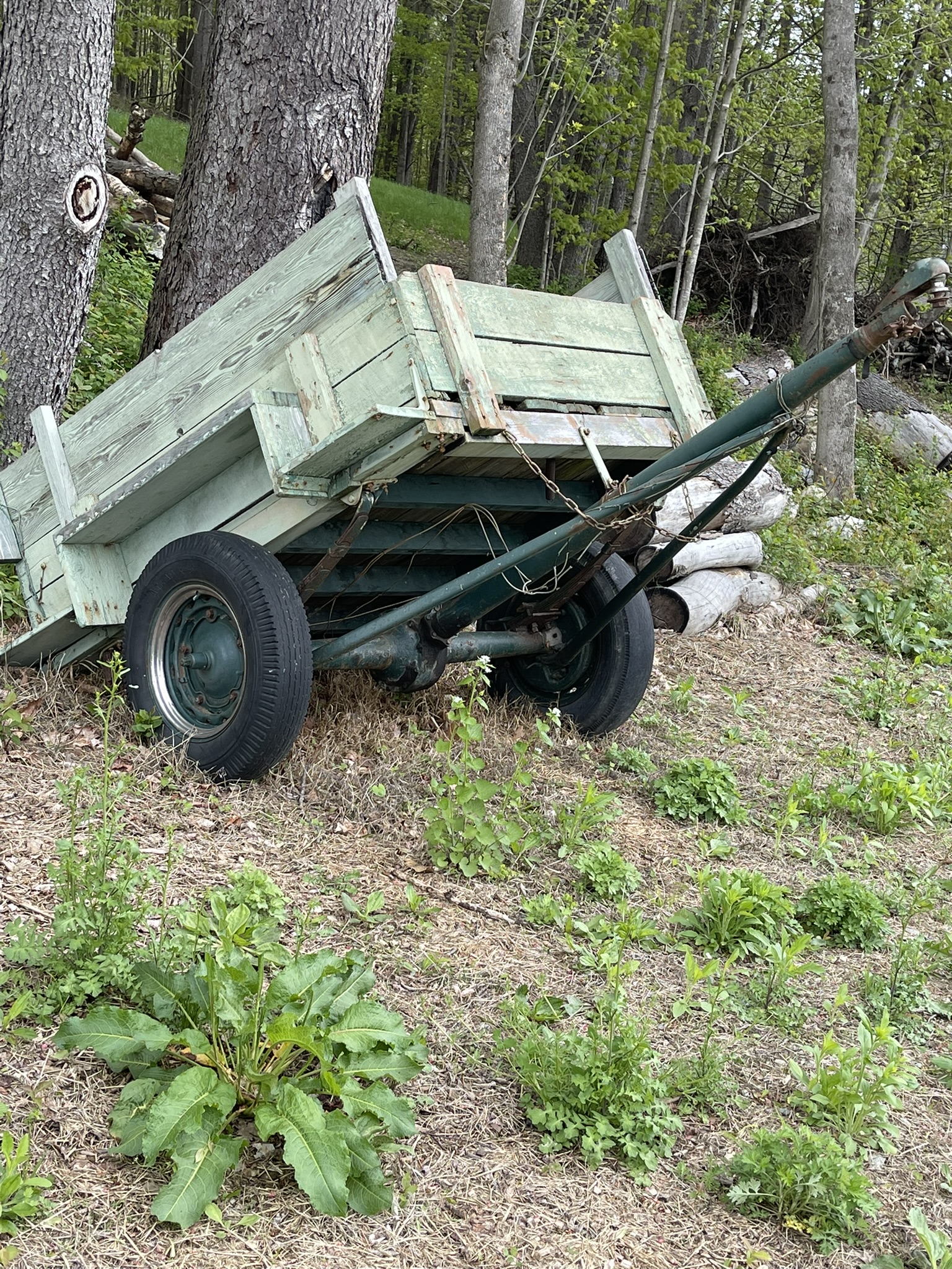

    Unless I run the wheels form the old wood splitter......LOL gotta love resourceful New England farmers.

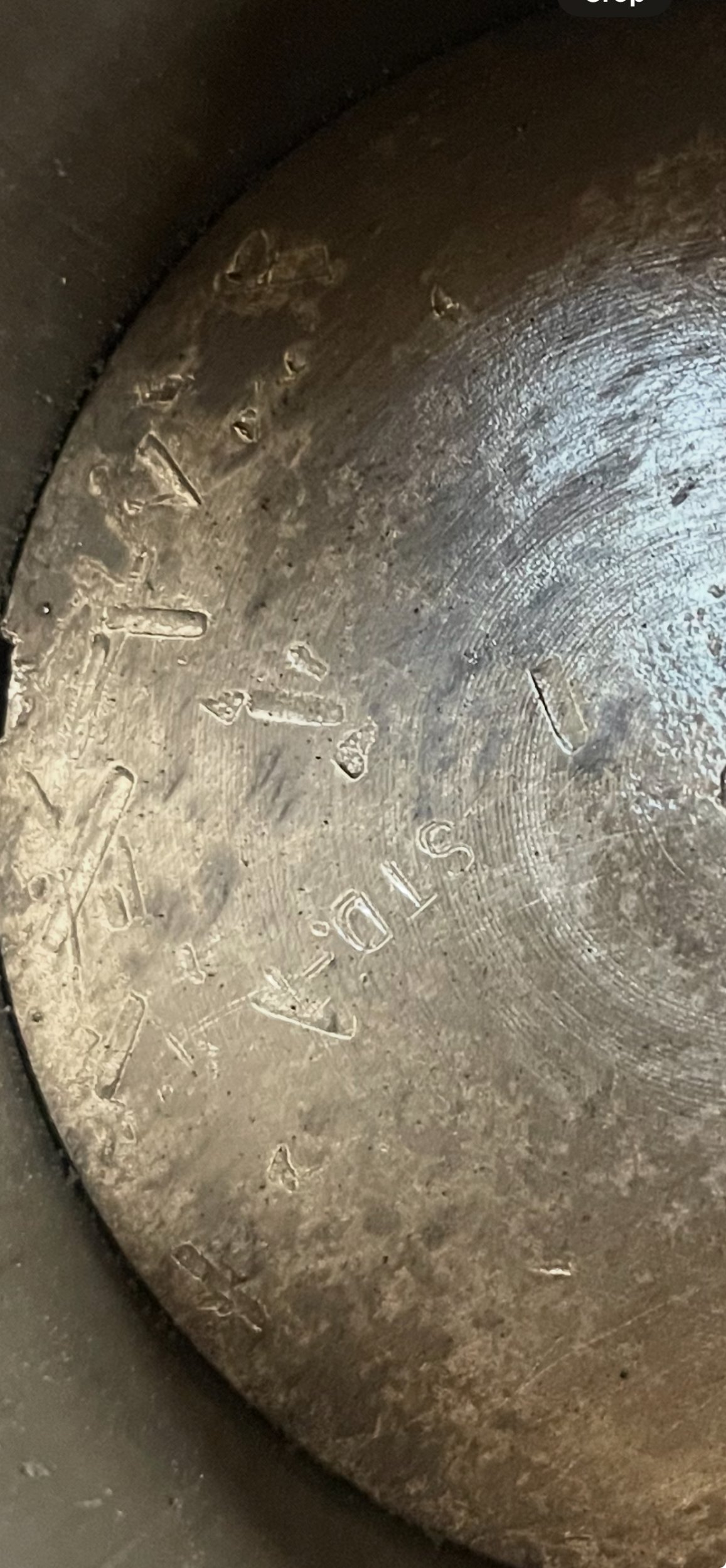

    wonder what this was.......

    My guess was a long sitting motor that they tossed new antifreeze in and got it running then pulled. Pretty green antifreeze, then this........ water pumps turn and look ok though.

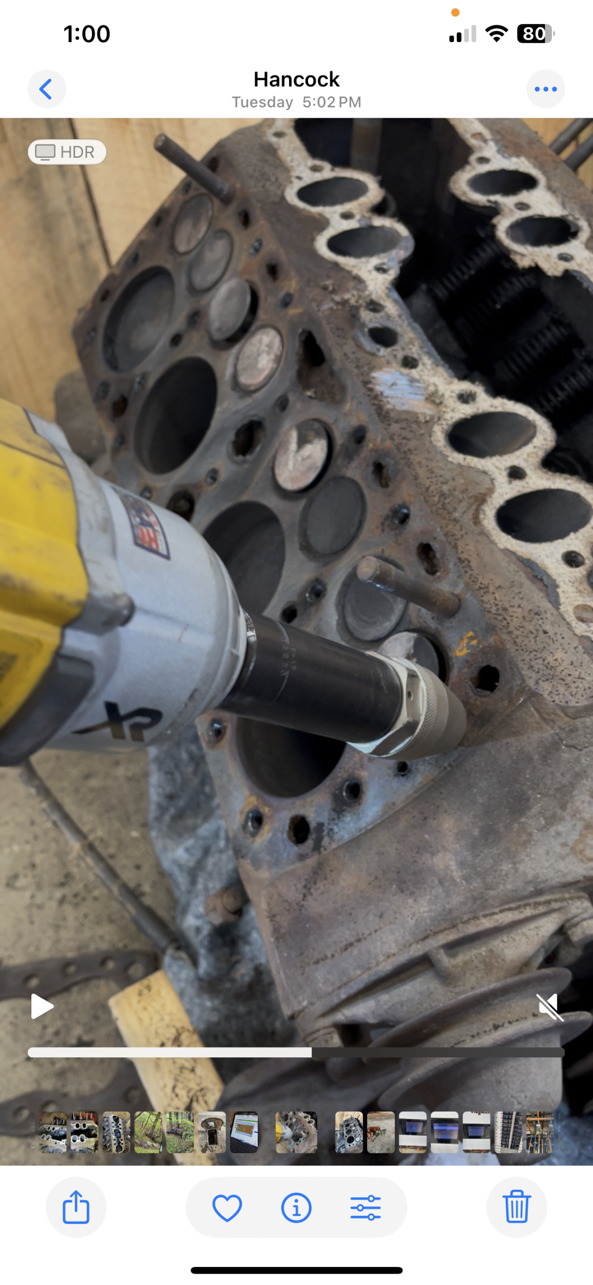

    1. Ford A and B speed
    I did get the stubborn stud out and 4 on the other side, then my stud puller fell apart. it did about 5 engines before breaking, so I wordered another. (Not that I have built 5 Engines, I took 5 apart, LOL).

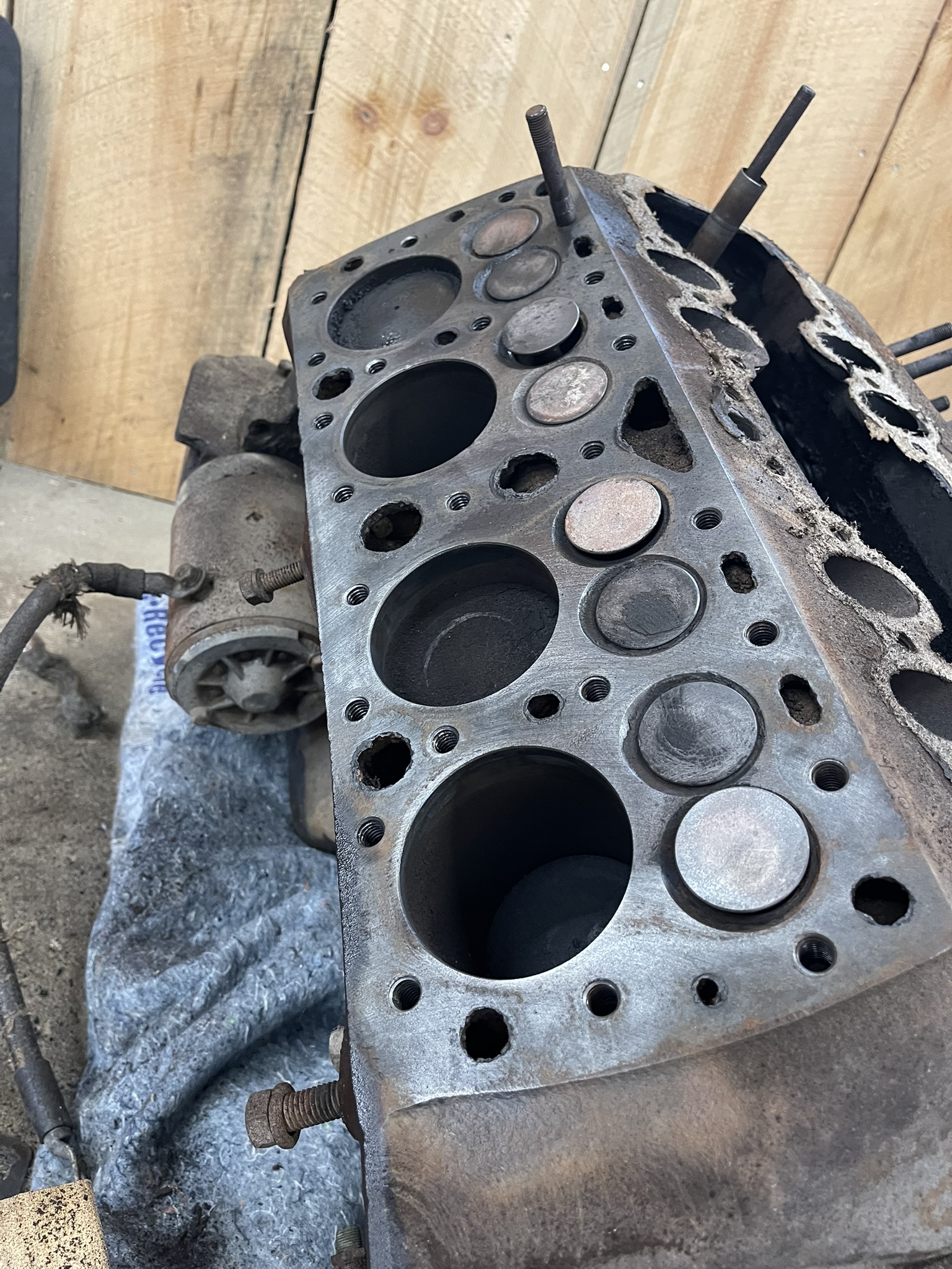

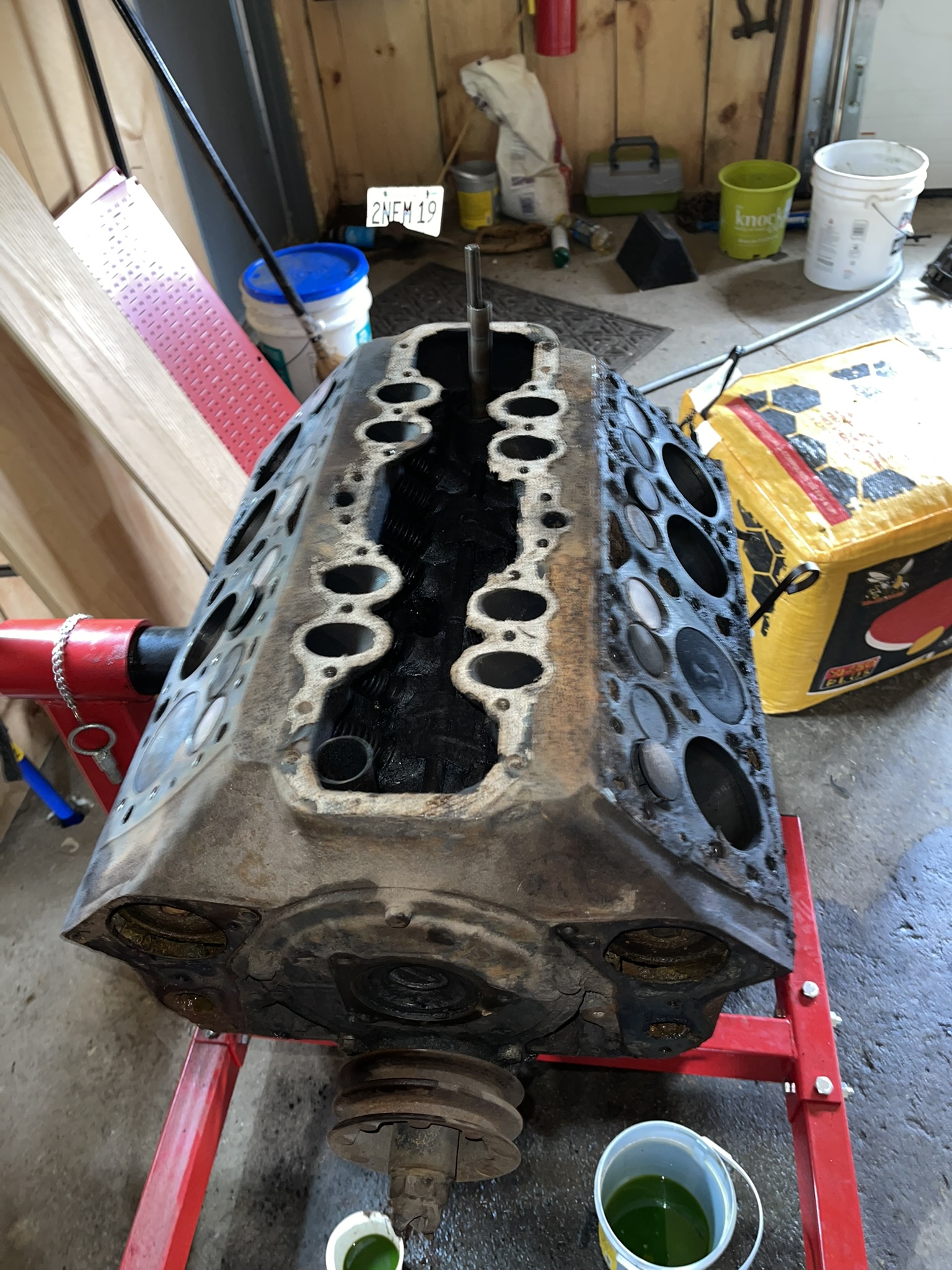

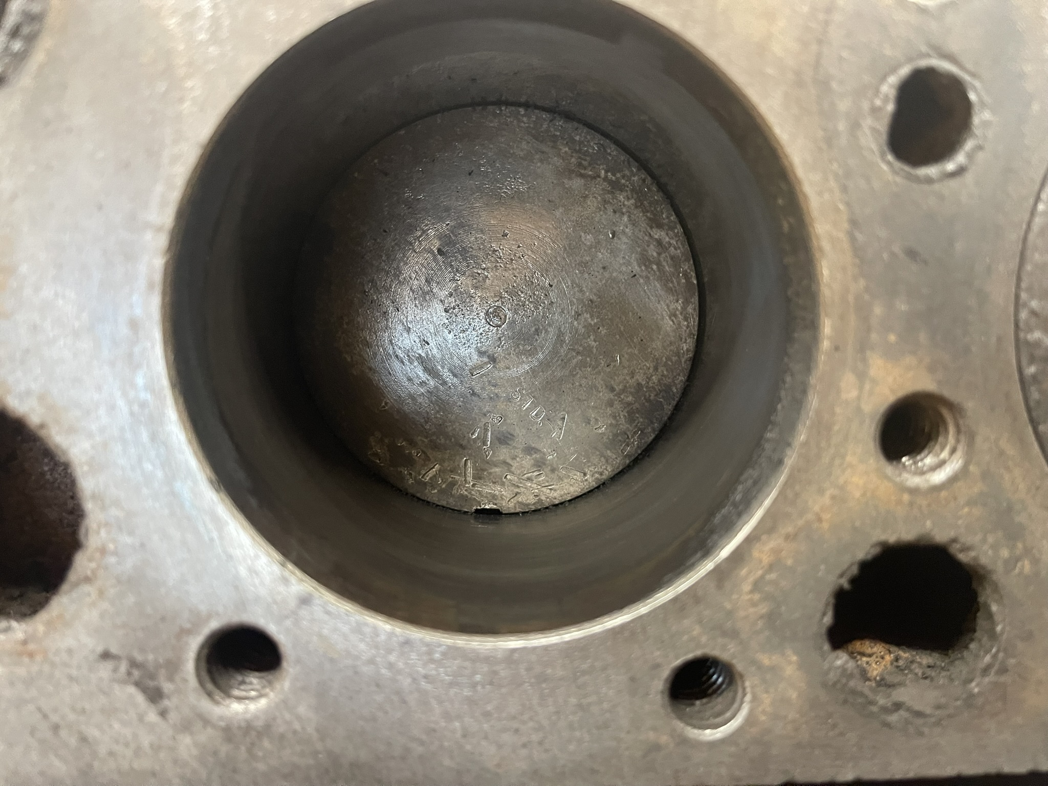

    Slowly tearing down the motor. All 48 studs came out. I did break one stud removal tool...LOL
    Looks like Standard pistons. Grabbed my hand crank and everything rotates like it should. The oil looked OK, not sludge filled. Dropping the oil pan next so I can get the pressure plate and fly wheel off. At that point I will decide if I take it all the way down and get it dipped and checked. I am not sure it will end up a "Budget" build, but certainly not a show build. I want something to play in the dirt with.
