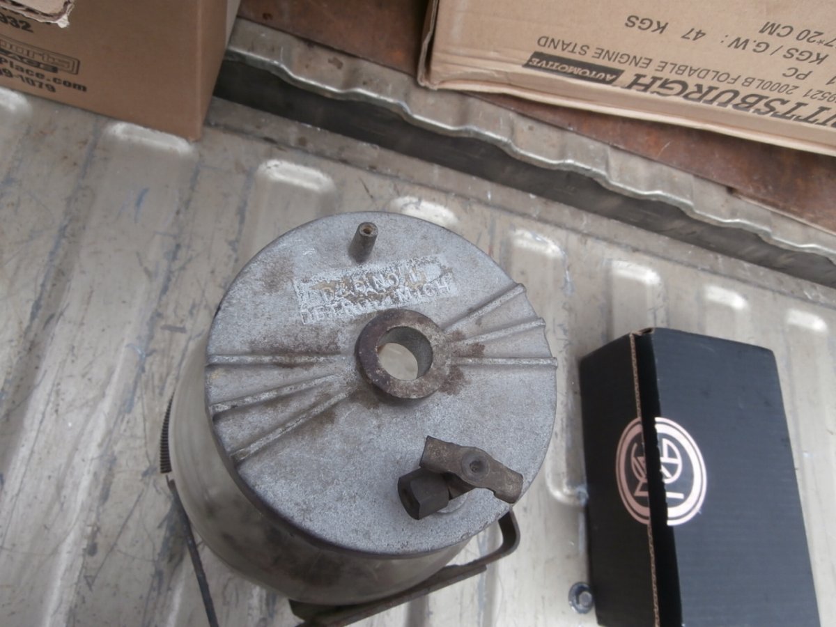

    Hey ,just picked this up with a bunch of 49 olds parts.Not a stock wiper fluid jar for that car,this is twice as big. Looks like home made bracket. Alum top that reads D&D #1 Detroit Michigan. Water injection setup jar??? water injection pics 002.JPG water injection pics 003.JPG water injection pics 004.JPG water injection pics 005.JPG
    oldsjoe likes this.
