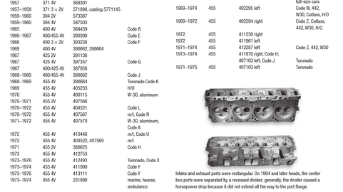

  11. mgtstumpy
    Joined: Jul 20, 2006
    Posts: 9,214
    mgtstumpy
    upload_2017-4-12_16-49-47.png Here are the Olds engine and casting number series. The engine number should assist to identify it.
    Deuces likes this.

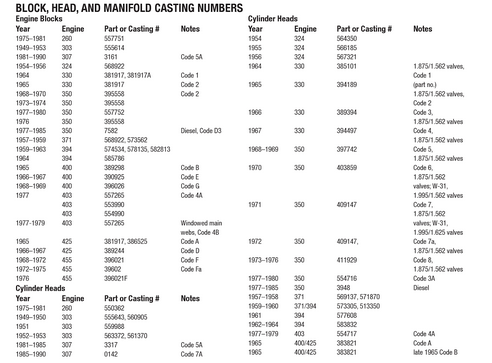

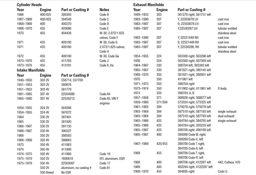

  12. mgtstumpy
    Posts: 9,214
    mgtstumpy
    Here's a bit more casting information.
    Deuces likes this.
