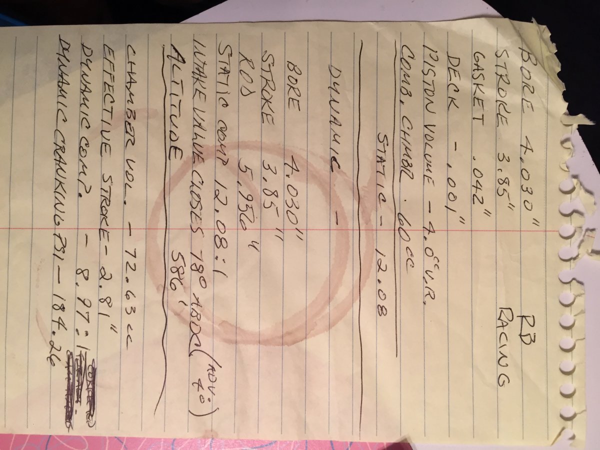

    New comp springs. I used procomp bare castings and put good stuff in. 4 degrees advanced on the cam. 8.97 cranking pressure. Valve overlap is hurting things some I know

    Could you post your cam card ? Something is holding your combo back . Can you borrow a larger carb to try ? Are you saying 8.97 is your compression ratio ? I asked if you had done a compression test to see if the rings are leaking compression. Do you have access to a leak down tester ?

    The 8.97 would be the dynamic compression. Which is borderline for a pump gas motor. I would first mount a fuel pressure gauge to start with, then test. Dont do a bunch of things at once, then it's easy to start losing track of what worked and what didn't.

    He said it's a race engine so he should be running race gas. So that should not be an issue unless he has retarded the timing to where it is just lazy.

    Sorry it took so long. Been very busy. Don't have access to another carb. 8.97 is dynamic compression. Have not done a compression test or leak down. Shop crammed full of other people's stuff. No room to get car in now. Have to wait. Am looking into building 1 3/4" headers. Any benefit to collector over individual primaries like " boom tubes"?
