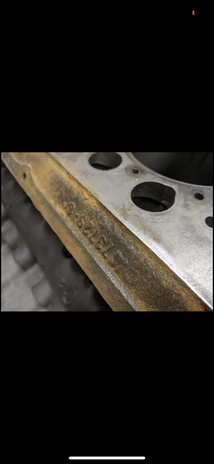

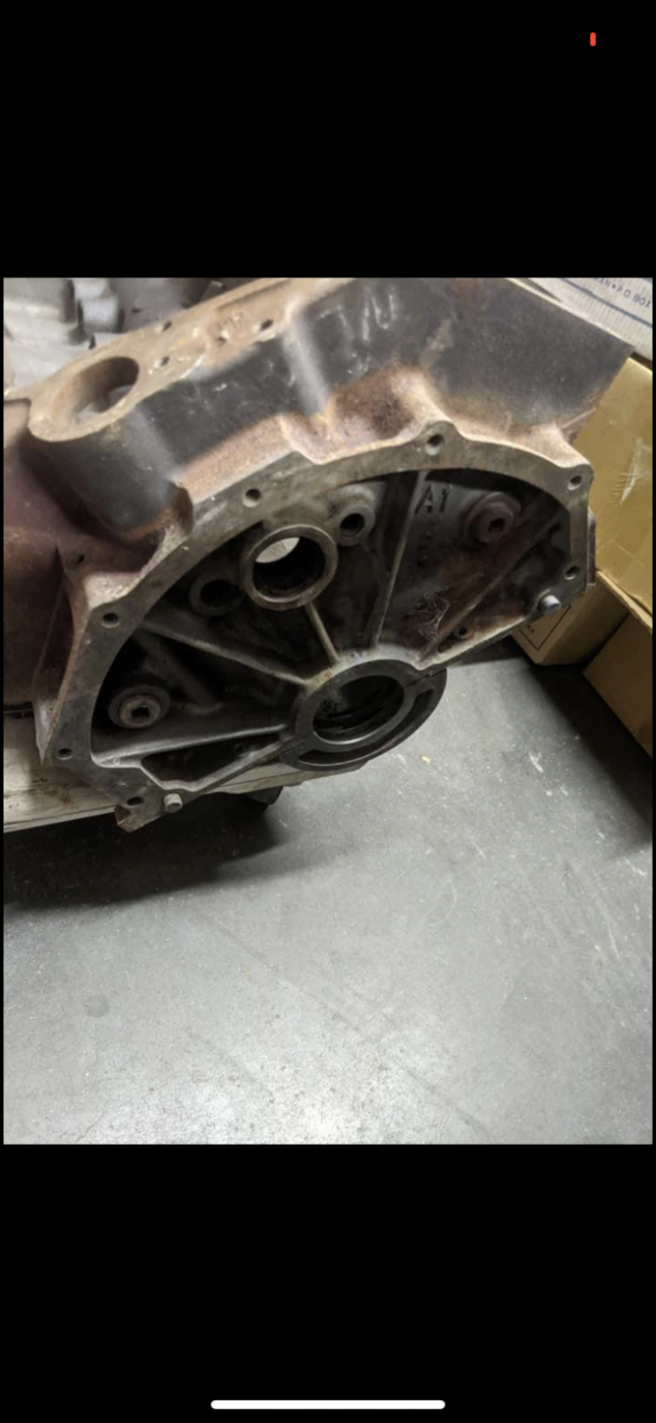

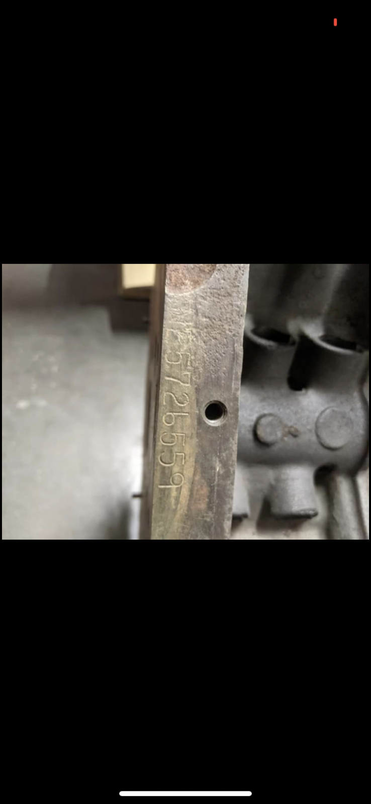

    Hi so I've found a 392 hemi block and wanted your guys take on it
    its an “A1 block” not sure if thats a bonus?
    here is the add and pics, thoughts please its $1500
    thanks in advance
    “”392 hemi from a 57 New Yorker. It was bored .030 years ago and never built. My machinist says it's been honed but is still on the tight side so it can be finish honed to your specs. A set of vintage Milodon aluminum main caps are included but haven't been fitted/line honed. The deck surfaces have not been surfaced. I'd rather not ship””
  2. The A-1 stories about it being a better block are just that stories. Its not true. Its a foundry marking.
    I would not run the aluminum caps. Get steel caps from hot heads if you want to go that route. Blocks are getting expensive. Its all about what you can find in your area.

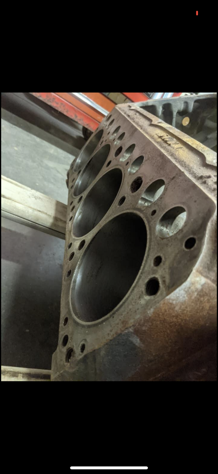

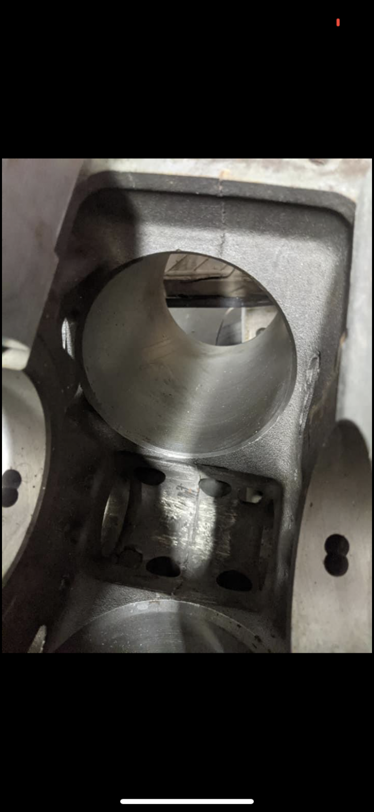

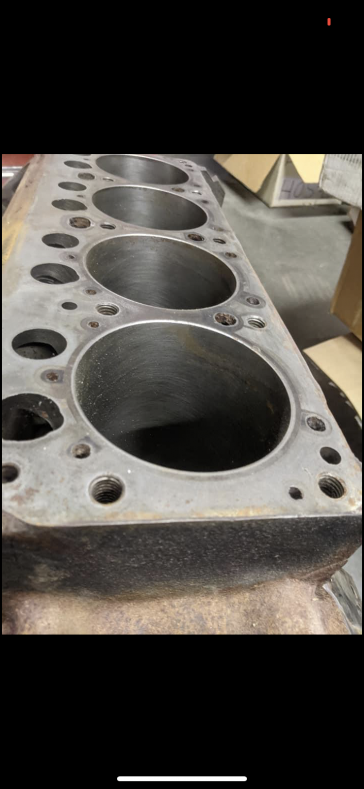

    It maybe the pic but the bores almost look like the engine ran on them and there’s some pitting in one. As long as it’s just a shadow and the bores can be finish honed to your pistons then i don’t see a problem. Is there any documentation on magnafluxing/pressure testing? And what’s your intentions ?do you need the Milodon caps? If you purchase it do you have a shop that can align BORE the block as honing can’t be done with those caps in most cases. As far as the A1 designation some people say there better and some say there not.

  5. That doesn’t look like a 1500 dollar block to me .
    Those bores are showing a fair amount of pitting,,,it was bored before,,,and sat for years looks like .
    The bores have recently been honed to remove all the surface rust,,,,that’s all .
    It will require at least a few thousandths removed to clean them well .
    You can have custom pistons made to whatever bore size you need,,,,but those bores there need attention .
    And the outside looks like crap as well .
    There are several others for sell elsewhere that are complete and you would have most of the parts you would need then.
    This block is pretty much a block that was cleaned and forgotten about.
    It is still very usable,,,,,but not for 1500 .
    Keep looking,,,or negotiate it down some .
