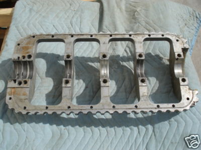

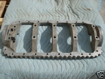

  20. TR Waters
    Joined: Nov 18, 2006
    Posts: 1,439
    TR Waters
    from Vermont
    1. Early Hemi Tech
    These are pictures I have had for some time. No idea who made it. I think its a great idea, but would be very costly to produce...either in cast or billet. I think that one core could be made to be machined for either a low or high deck.
    The problem with this type is the same as with a Donovan. Changing main bearings. Not a concern for the most of us, but probably the reason this idea never took off.
    All of these ideas, including mine, are a band-aid to help a block made to produce 300 hp survive 600 or more hp.
    Now....when the new aluminum early hemi block is finished....some of these problem will be addressed. ;)
    kidcampbell71 likes this.

  23. BashingTin
    Joined: Feb 15, 2010
    Posts: 270
    BashingTin
    Hey TR,
    I could be wrong, my eyes are not what they used to be, but is that girdle machined to accept another main bearing at the rear cap? It sort of looks like two bearing inserts there....
    David
  24. TR Waters
    Posts: 1,439
    TR Waters
    from Vermont
    1. Early Hemi Tech
    :D If you look close, you'll see that someone has the #1 bearing in where the rear main seal is.
    I am not doing a block, but have it on pretty good authority that one is in the works. These things always take lots of time and even more money.
  25. BashingTin
    Posts: 270
    BashingTin
    Ah, I see it now. Thanks!
    So someone is working on an aluminum block... :rolleyes: I hope they go with a 4.25" bore. There is just enough room. Combine that with a 5/8" arm and you'll get something close to 513 cubic inches. :)
    David
