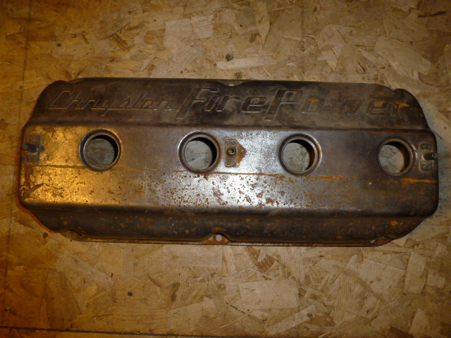

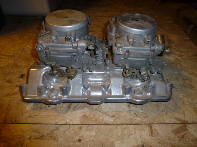

    Picked up a very complete (but completely disassembled) 331 Hemi this week. It was apparently disassembled in the 80's for a rebuild but never was completed. It has new pistons installed onto the con rods, and the block was supposedly bored .030. Its sat so long there is surface rust on the cylinder bores & some corrosion on the pistons from sitting in a cardboard box too long. I'll have it checked to see if its usable or if it needs bored again and new pistons. The block is still in Colorado Springs, I have to go back to get it. I brought home everything else. The crank was turned & the cam reground, but both have storage rust too. The valve covers are in very nice shape, has a dizzy, bellhousing chunks, pulley/generator/rebuild original water pump. I'm reading up on everything I can about these motors.
    The kicker is the old school, ceramic coated, "SAY WHY-AND" dual quad intake and 2 64/65 Corvette AFB carbs. From what I've read the intake sounds like it could feed way more air than the old 51 heads can flow. But I guess it will look cool regardless. Maybe some day I'll upgrade to a better head.
    I'll admit I had already bought a 5.9L Dodge Magnum motor & trans to use. I had a very short list of "dream" motors I would abandon the EFI motor for. I found the hemi on my Colorado Bronco forum, I wasn't really looking for one. I am going to see if I can get the 46RE trans from the Dodge truck to work. I was planning on using the ECU to run the EFI motor & trans, but now need to see if the ECU can just run the trans. I know its not entirely Hamb friendly, but I'm sure there are lots of guys here glad I didn't screw up my old car with the 5.9L EFI motor. I've gained a lot of appreciation for the look of the old motors and really look forward to using this hemi. I really didn't think I'd have an easy opportunity to get my hands on something like this. I live in the sticks. Finding parts, and getting them to my town can be expensive or a PITA, since I don't have a pick up truck.
