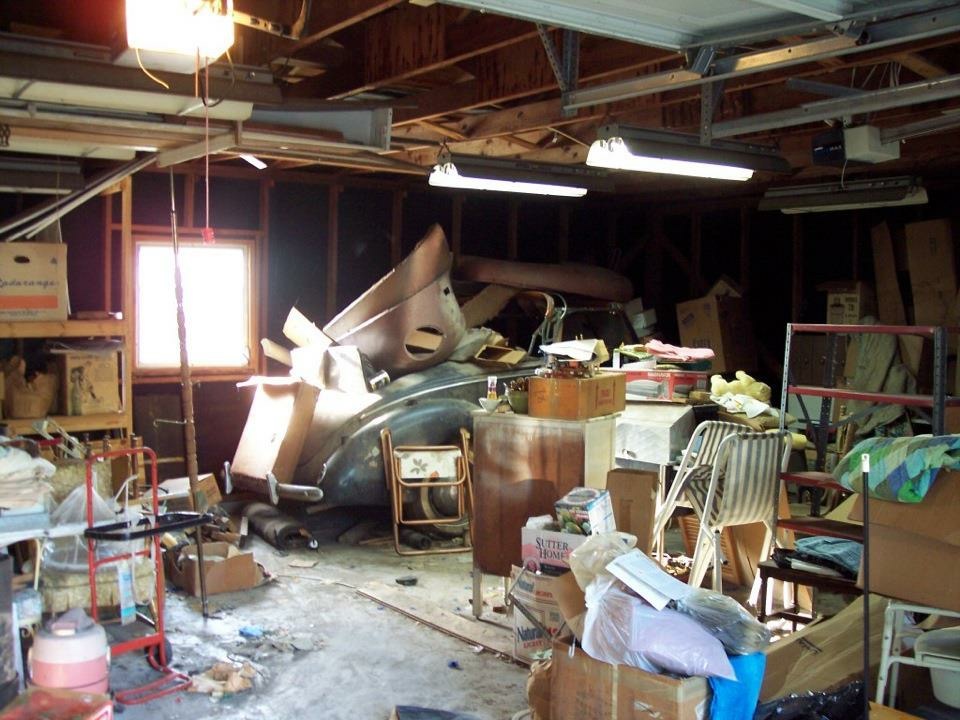

    I finally hauled my ol 39 Ford Conv from my house to my shop to get started tearing it down and rebuilding it. Someone asked me recently how long I’d had it, and I said, I don’t know, probably 4 years or so. Well, or so was right. More like 8 years. Lol. Anyway, I started a thread when I bought the car, (39 Ford Conv garage find) if you want to search to get the back story. I’ll take up where I left off with the car awaiting a trip to town to my shop. F1C943E5-7DC8-49F6-A23E-5B5DE35D3A8F.jpeg
    It was starting to look like it did when I picked it up in Texas.
    Me and my brother in law got her loaded up and hauled to town to my shop. Hopefully this stay will be shorter than it’s slumber in Texas which lasted from 1961 till 2012 when I bought it. 6E5FEB05-6558-40BF-8EB3-40DD2A1CF5EE.jpeg D048B6A7-F386-45F4-80BF-B5F5E2791CF7.jpeg B4A94764-87C6-4F55-ACB7-2446DAB0790E.jpeg
    I’ll be adding pics periodically to catch up to where I’m at presently.
