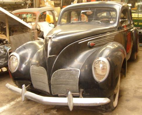

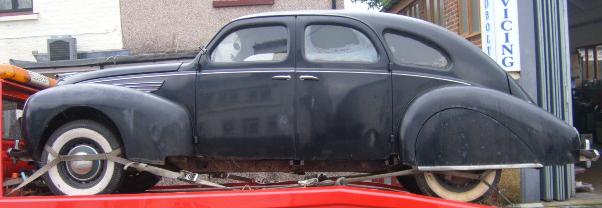

Thanks James , yep dropping the original beam is an option and i might go that way , and yes there are a lot of leaves in the spring pack so i'd already decided to lose a few , i just noticed that the perch and kingpin measurements were pretty close and wondered if anyone had tried the ford axle , Got the old beast running last week and the v12 sounds pretty good , i've got a stack of reciepts from 1941 to 1961 and it did 90,000 miles in that time , had an engine rebuild 20.000 miles ago so that's probably why it sounds so good , Thanks for replying

Thanks James , just getting a list together of what it needs ,the body is good and straight but it's been stood on grass by the looks of things so the floors etc are toast , i might channel it too as i'm going to have to remove pretty much all the floor , I'll post some pics when i get a chance
