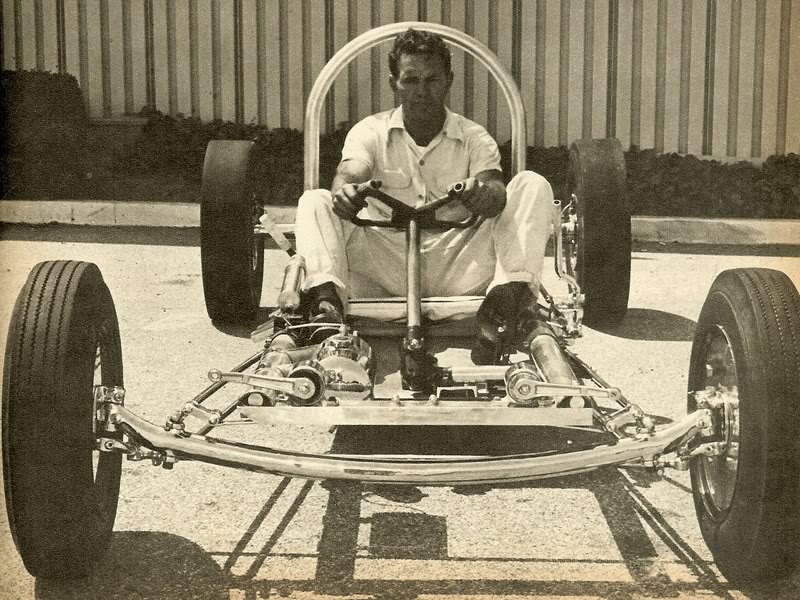

    HROTY-57.jpg scan0026-1.jpg NiekampHeadon.jpg How can dropping them improve their looks? Beautiful axles in stock form, even better in chrome:)

    why drop a v8 60 axle when you can buy a drop tube axle cheaper.don't ruin a rare ford part that others would love to have,including me.

    These were heavily used by circle track racers, probably before rodders even, and so frequently used with proper period 4-bars just as on the Grbowski and Ivo T-buckets...
    Bars were built up from tie rods and tie rod ends...
    On dropping, I agree that the drop ruins the lines and doesn't even give much lowering in return. If it's too high as-is with a top spring, note that most cars using it used a suicide type spring setup to get the low. I think its use on stock setup type early Fords with spring on top and crossmember where Ford put it is marginal in terms of possible lowering.

    In the '50s, Bell Auto Parts' Roy Richter stocked dropped tube axles, '37-'40 tubes with dropped ductile ends welded in, on an exchange basis. They were shaped to perfection, netted a 2-1/2" drop. Ads were run in HRM, (didn't Alex Xydias also sell them thru So-Cal Speed Shop at that time?)
