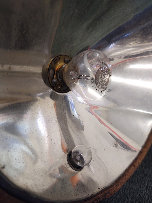

    My left headlight bucket was in good shape except it was egg shaped like someone sat on it?! The headlight bezel was rust pitted bad, and I wanted to chrome both bezels. IMG_20220205_120345985.jpg IMG_20220205_120353371.jpg IMG_20220205_121153490.jpg IMG_20220205_120619175.jpg But I found a NOS complete assembly!!!! Cool! hard to believe there are still parts out there like this?!

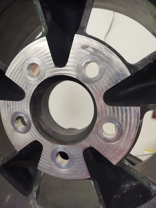

    The second set of 15"x10" American MAG wheels I found were in very good shape, except for one thing!!! I took the gamble on buying them with the damage from someone trying to plug the lug holes with aluminum, then welding in, to redrill and change the bolt pattern?!?!?! UGH!!!! I guess when they figured out it wasn't going to work they stopped. IMG_20220110_131334747.jpg IMG_20220110_131440721.jpg IMG_20220110_131456098.jpg

    I had a machinist buddy help me out! Made some 7075 aluminum sleeves with a flange, then machined the minimum out of the lug holes to remove the damaged area. Then put the alum pcs in the freezer, and warmed the wheel, and pressed the slugs in with a thou and a half of press. Then spot faced the lug washer areas, and trued up the mounting flange. IMG_20220124_193527673.jpg IMG_20220124_193454768.jpg IMG_20220124_194010325.jpg

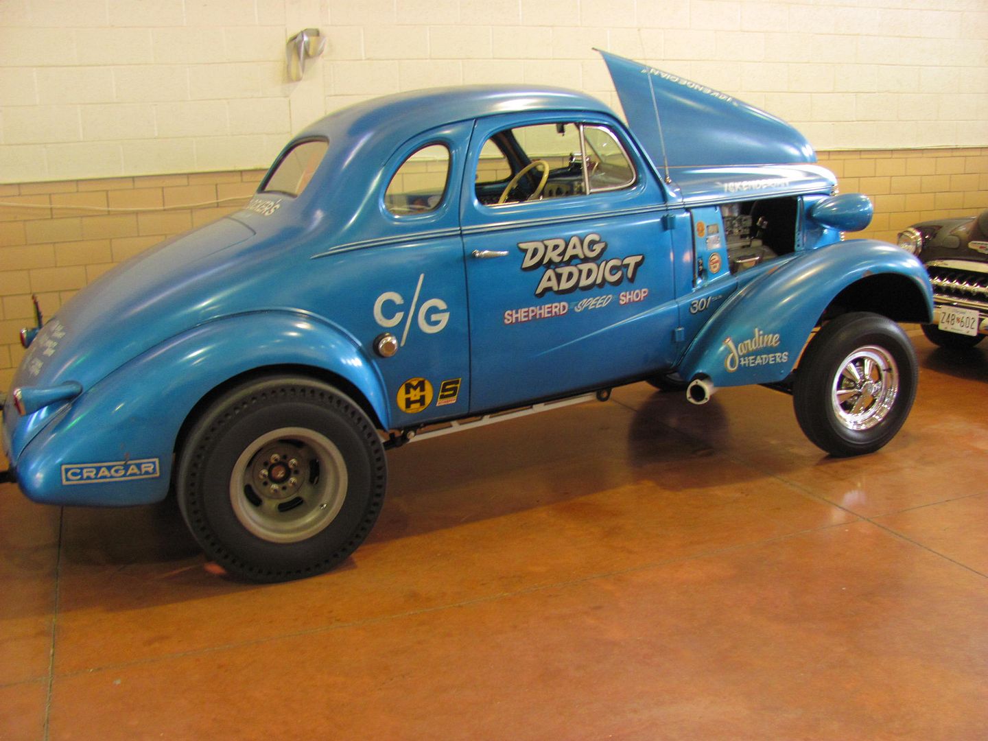

    Nice old red 37 Chevy coupe from back in the old days. I have an old film that I took in 1959 at Lion’s Dragstrip. It was from my collection of films of the Gas Coupe and Sedan class. Specifically, the B/Gas and C/Gas Class that So Cal local, Doug Cook was a consistent winner almost every week.
    To us, he was a hard-working, lightning quick reaction time driver, excellent mechanic/builder and friendly to us teenagers with tons of answers to our questions. We saw his 1937 Tahitian Red color Chevy Coupe almost every week we were at Lion’s Dragstrip, racing during those 58-60 time periods.

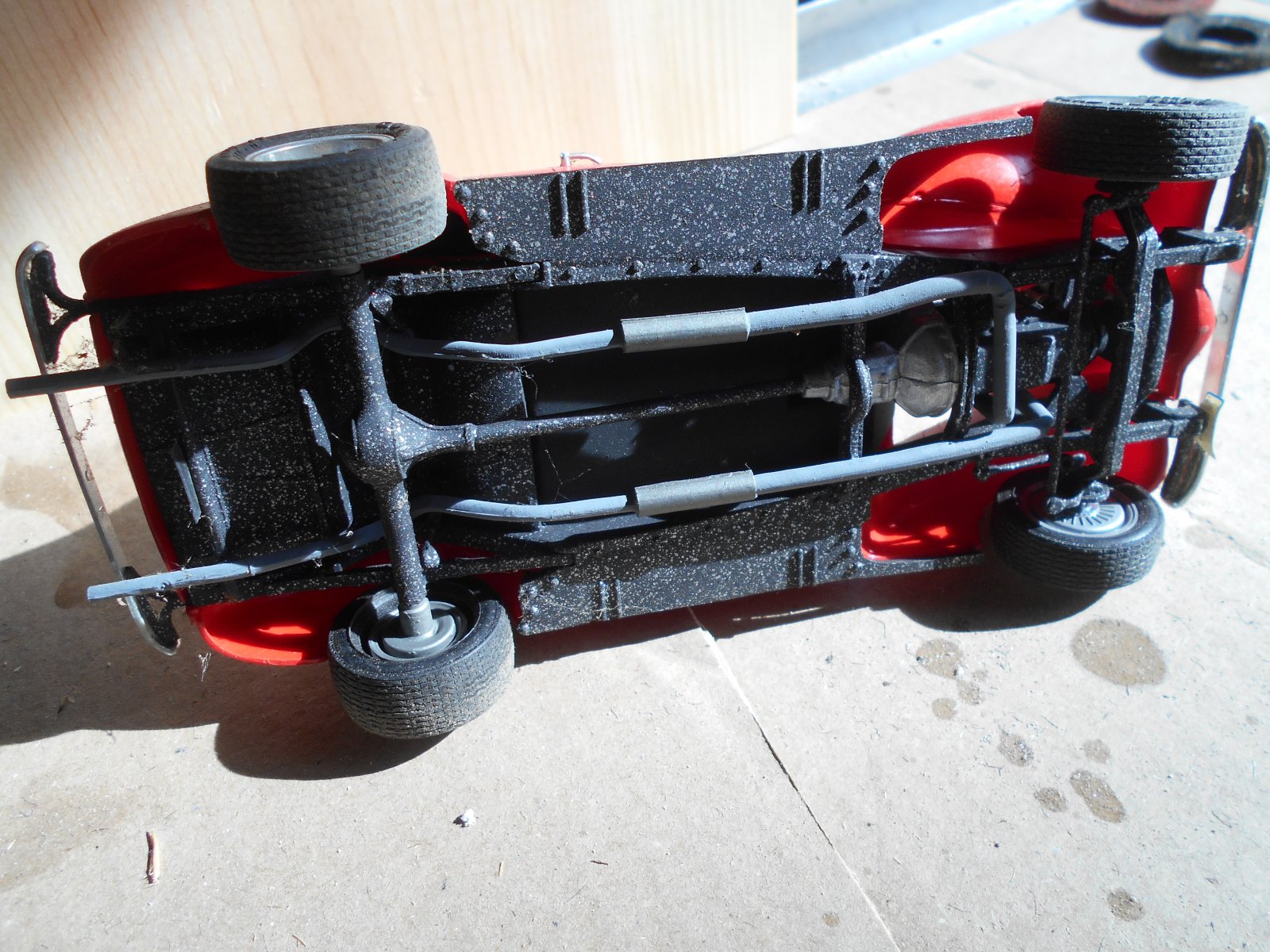

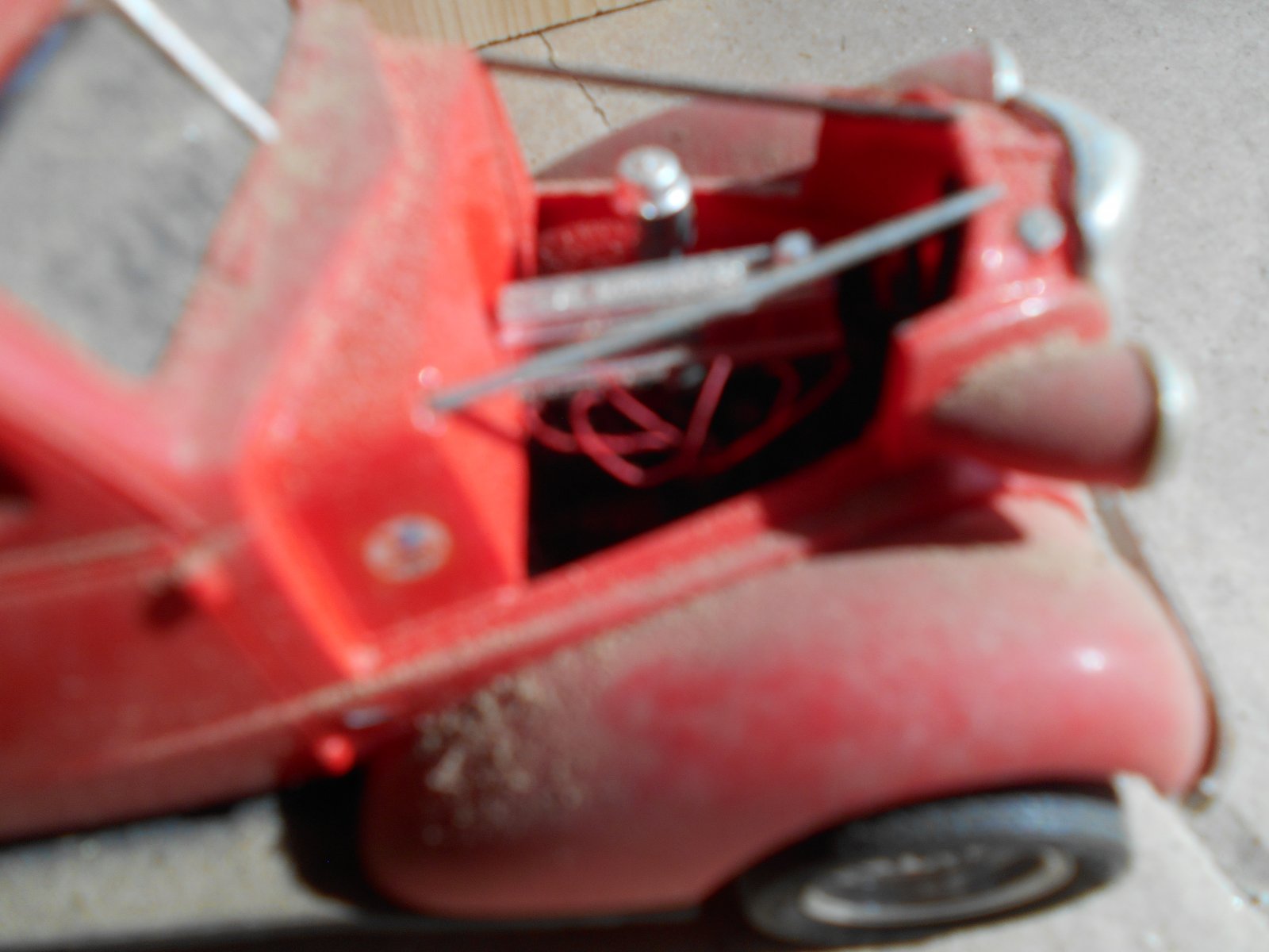

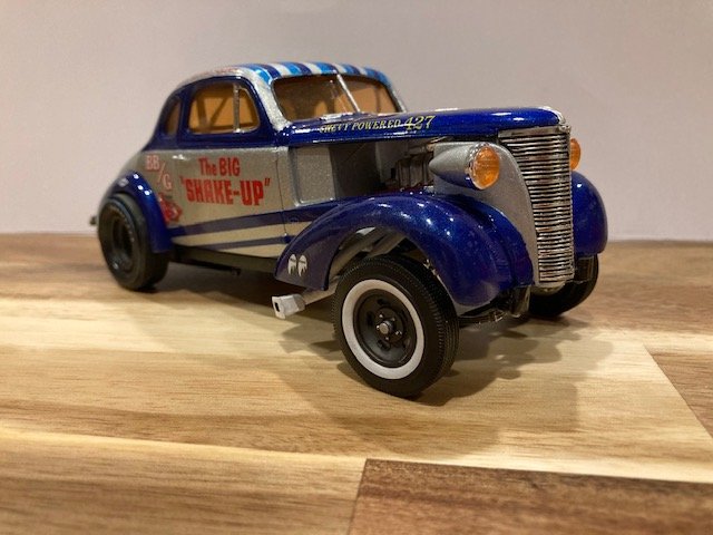

  15. here's a model I put together over 40 years ago almost like your dad's...
    Thor1, loudbang, TFoch and 4 others like this.

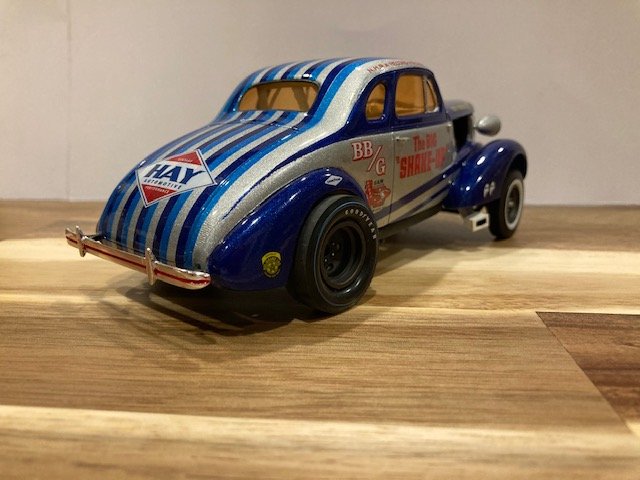

  20. I love this build so much. I'm originally from Chandler, AZ. My 38 Coupe was my dads until he passed away and lived in Chandler and Mesa, AZ until 2006 when I got it. 38.jpg
    I love 37-38 gassers. But my dad would haunt me from the grave if I did that to his car. So, I built a model instead of my dream gasser.. It's the old AMT 37 kit with a Modelhaus 38 resin grille, hood and bumper
    Love the build! I'll be following along.

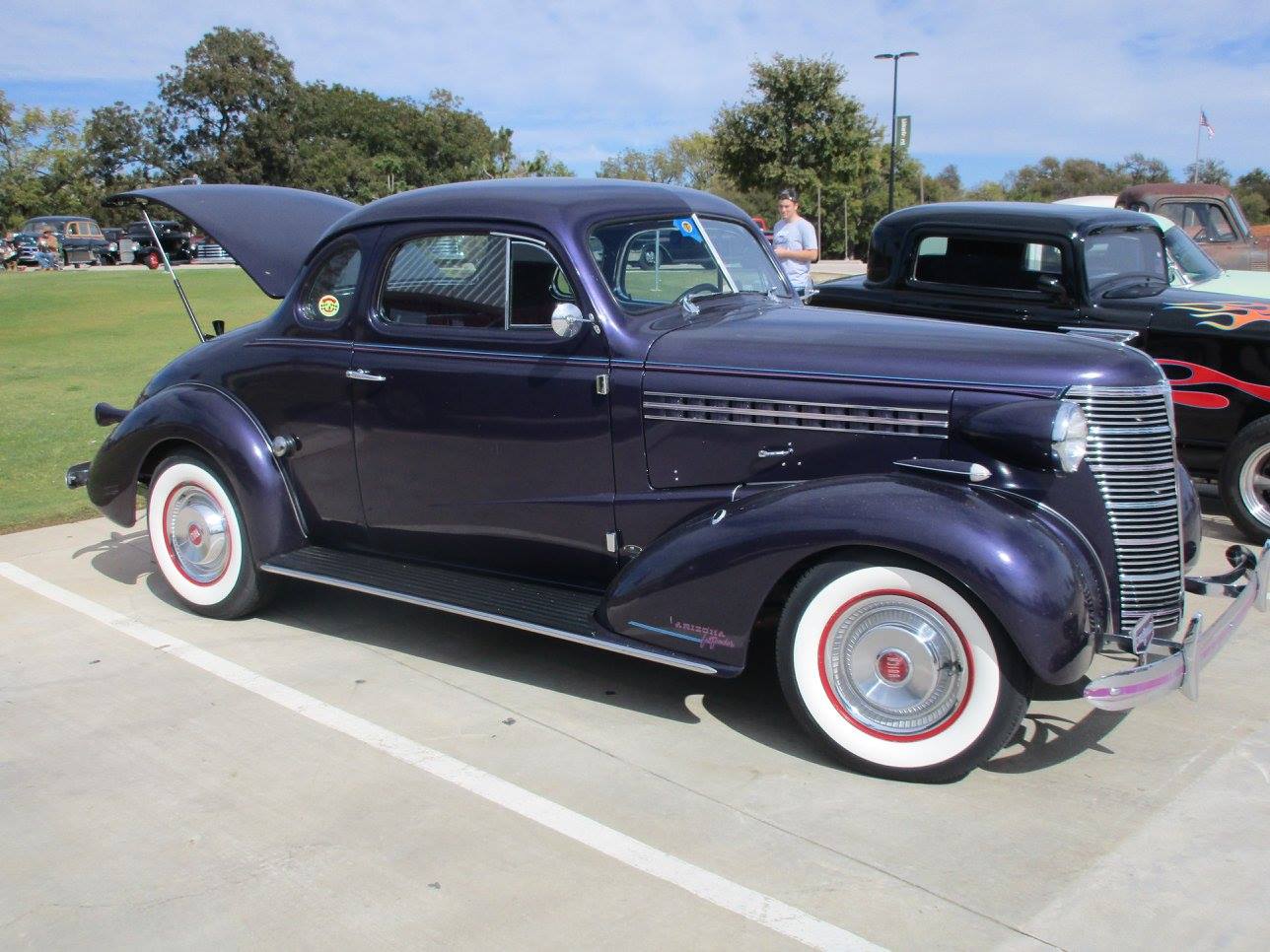

    Just had to show you a couple 37/38’s I saw on a GarageJournal thread posted by @MP&C..
    I know you’re still trying to decide on your rear fender trim, thought these two different takes would help you.
