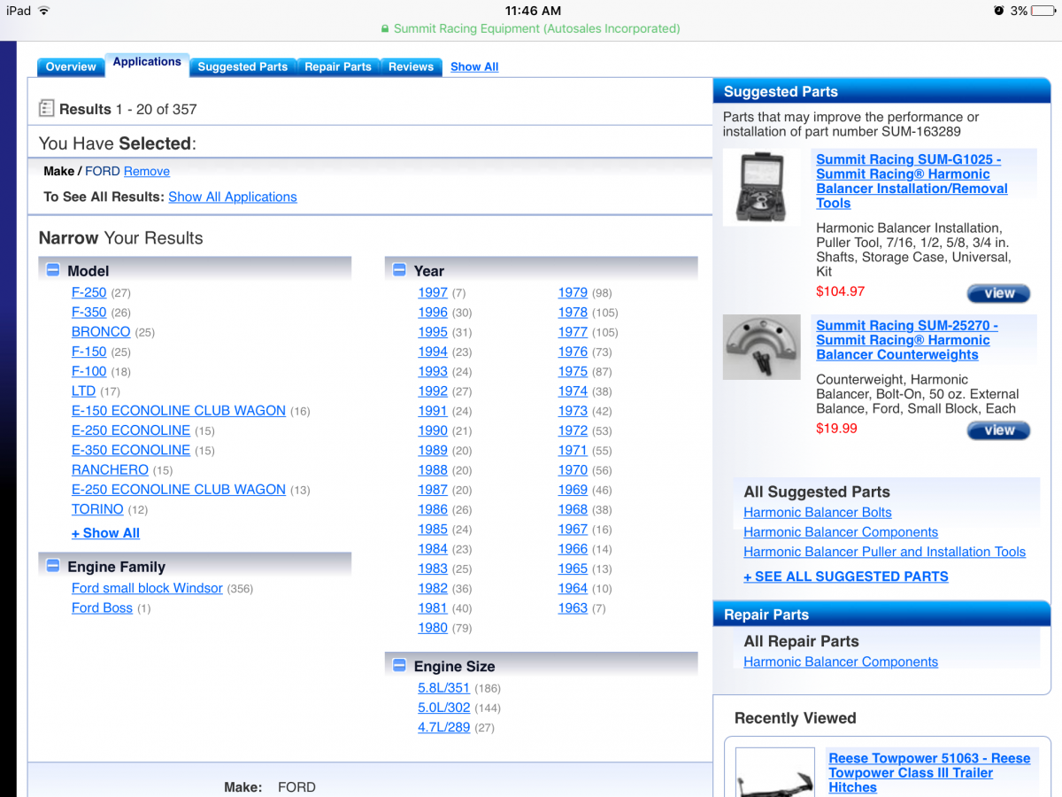

  8. According to summit racing application chart,
    The 28 once balancer fits all 289,302,351w with no stipulation between early or late or engine sizes. That leads me to believe it's just one and that one works for all ?
    Would that be correct ?

  15. The Summit applications show two dampers; the SUM 163289 and the SUM 163302. The only difference between them is the bolt-on balance weight. The 289 part # fits ALL 28 oz motors, the 302 is for the late 50 oz motors.
    Not many people have. I believe these were sold on 're-power' motors mostly (replacement motors for older boats), but may have been used on others depending on the 'front dress' the manufacturer used. But I had one, off a all-but-new 50 oz 302 that the boat owner had installed and then failed to winterize, cracking the block beyond repair. I used the complete rotating assembly (less the pistons) in a 289 5-bolt block. I had the damper machined for the early pulley, other than that it bolted in.

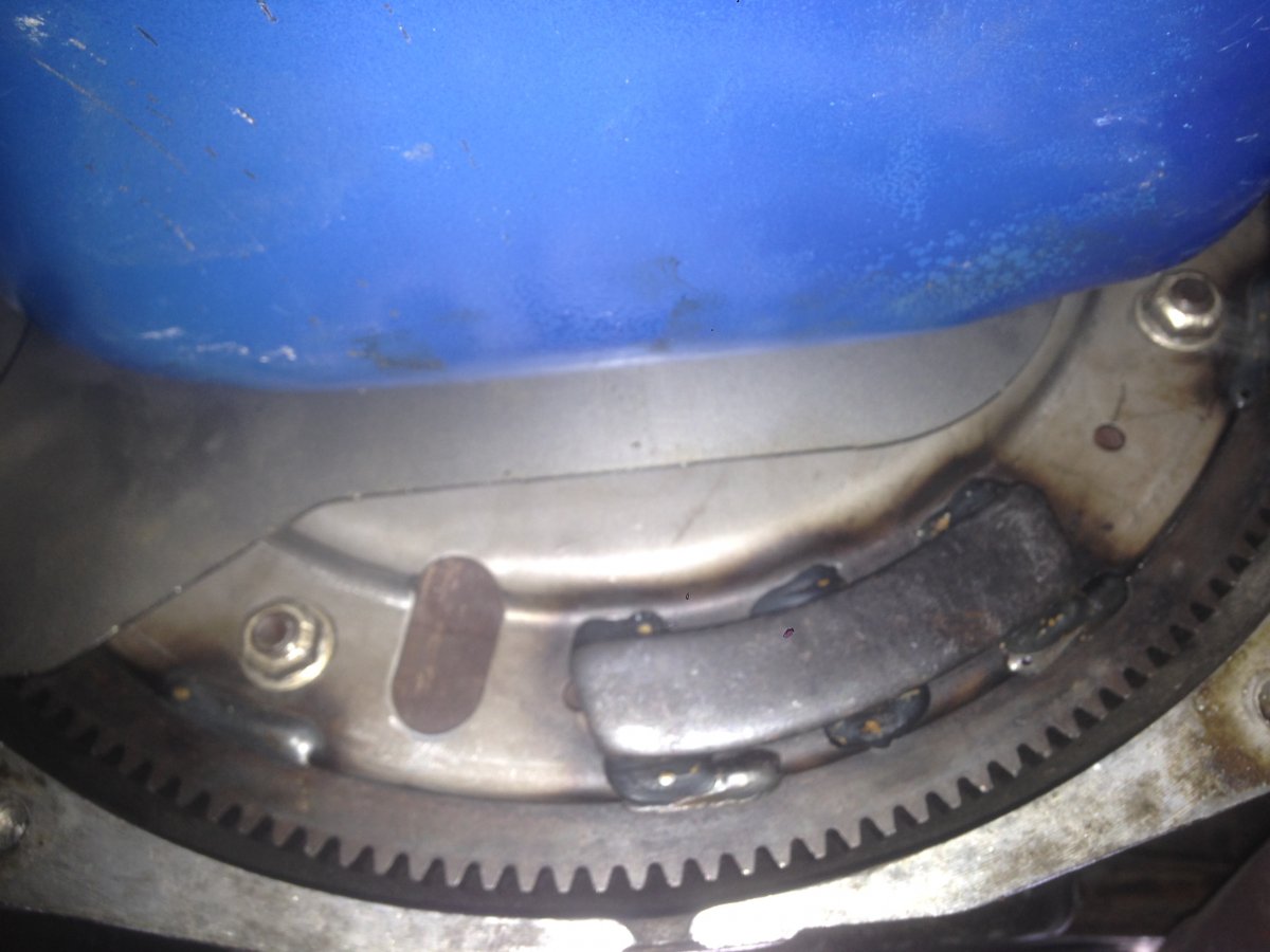

  19. It does have a 1991 AOD from a 302 mustang. However I believe this is the 28once flex plate.

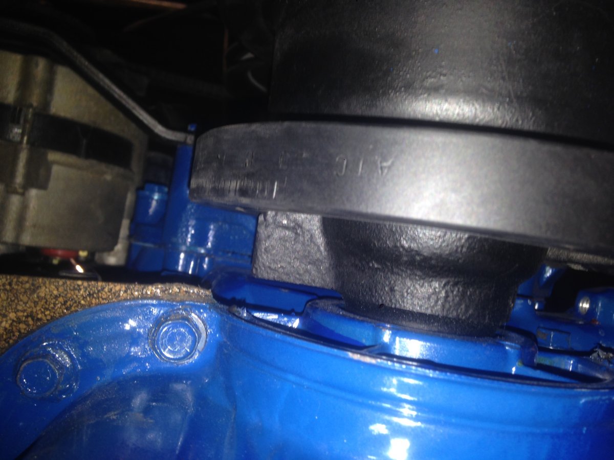

    Here's the balancer , also 28 ounce

    fordcpe
    Your looks like a 50 to me. Just look at the big oval holes that is the 50 oz. one and yours has that. Darrell

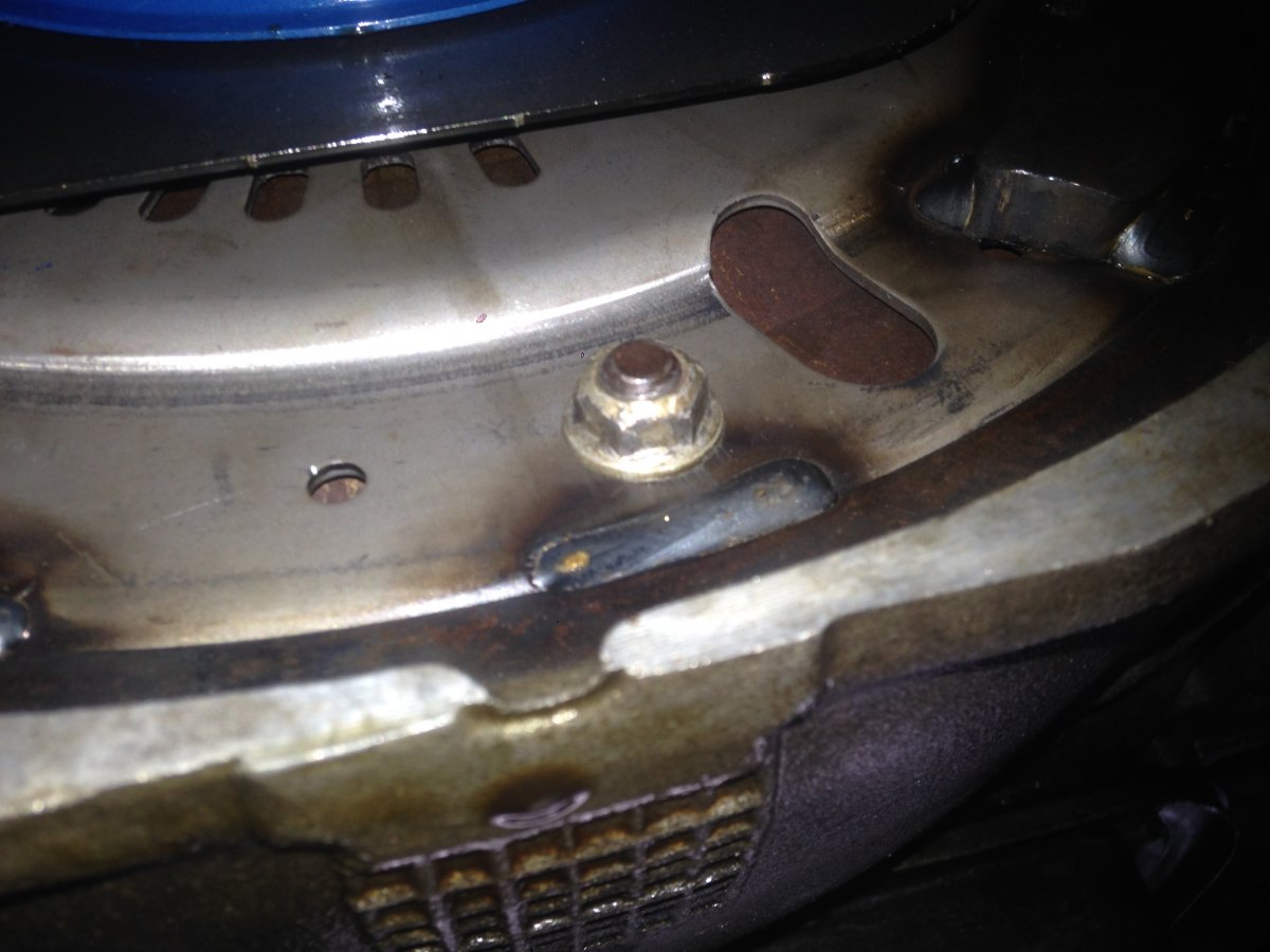

  23. Yep, looks like a 50 oz unit... Ford didn't make a factory 28 oz AOD flexplate, they were aftermarket only although Ford did sell one through Ford Motorsport. Look for the cutaway in the plate opposite the weight...
  24.
  25. There's the cut out.
    And there's the series of oval holes above but just before the weight.?
  26. Yep, that's a 50 oz.... bummer. Those small oval holes appear to be balance holes, must be for 'fine tuning' the balance as I see these as varying between individual flexplates. Do a tooth count, and order the right conversion flexplate from Summit or your fav mail order shop...
