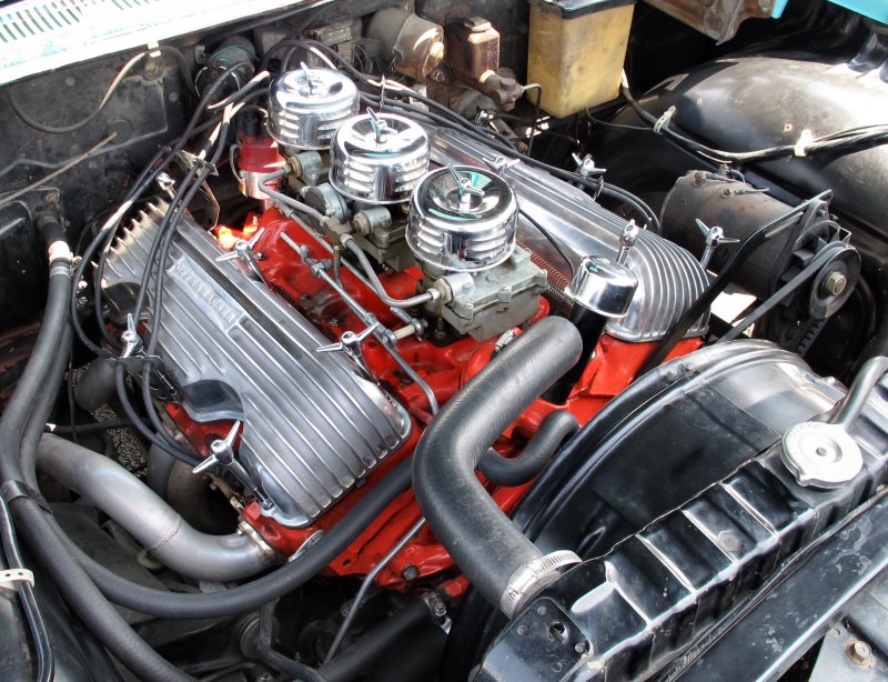

    The 340 horse 409 heads were service replacements from Chevrolet for the 350 horse 348 heads. These are the heads on the 348 in my 59 BelAir .
    Countn'Carbs and jadegrenade 51 like this.
