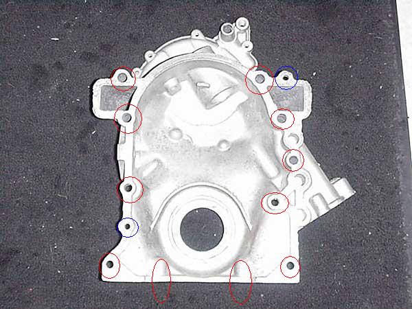

  26. Dzus
    Joined: Apr 3, 2006
    Posts: 321
    Dzus
    I suppose it could still have the nylon timing gear and it finally disintegrated. If you know chevy's the timing set is similiar. The buick differs in having the cast front cover with the integrated oil pump and distributor.
    Attached is a rear view of the front cover. I circled the bolts holding the front cover on this pic in red. There are also 2 dowel pins I circled in blue.
