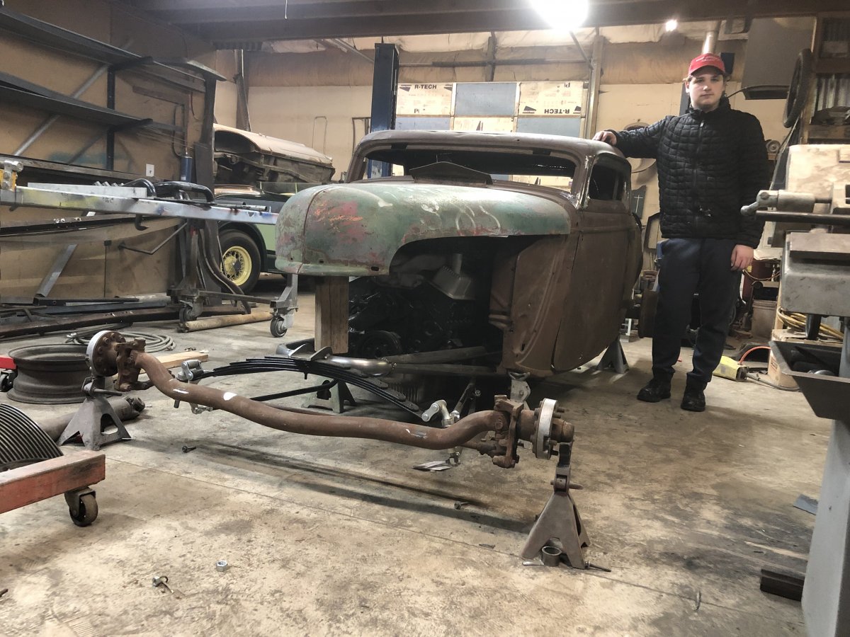

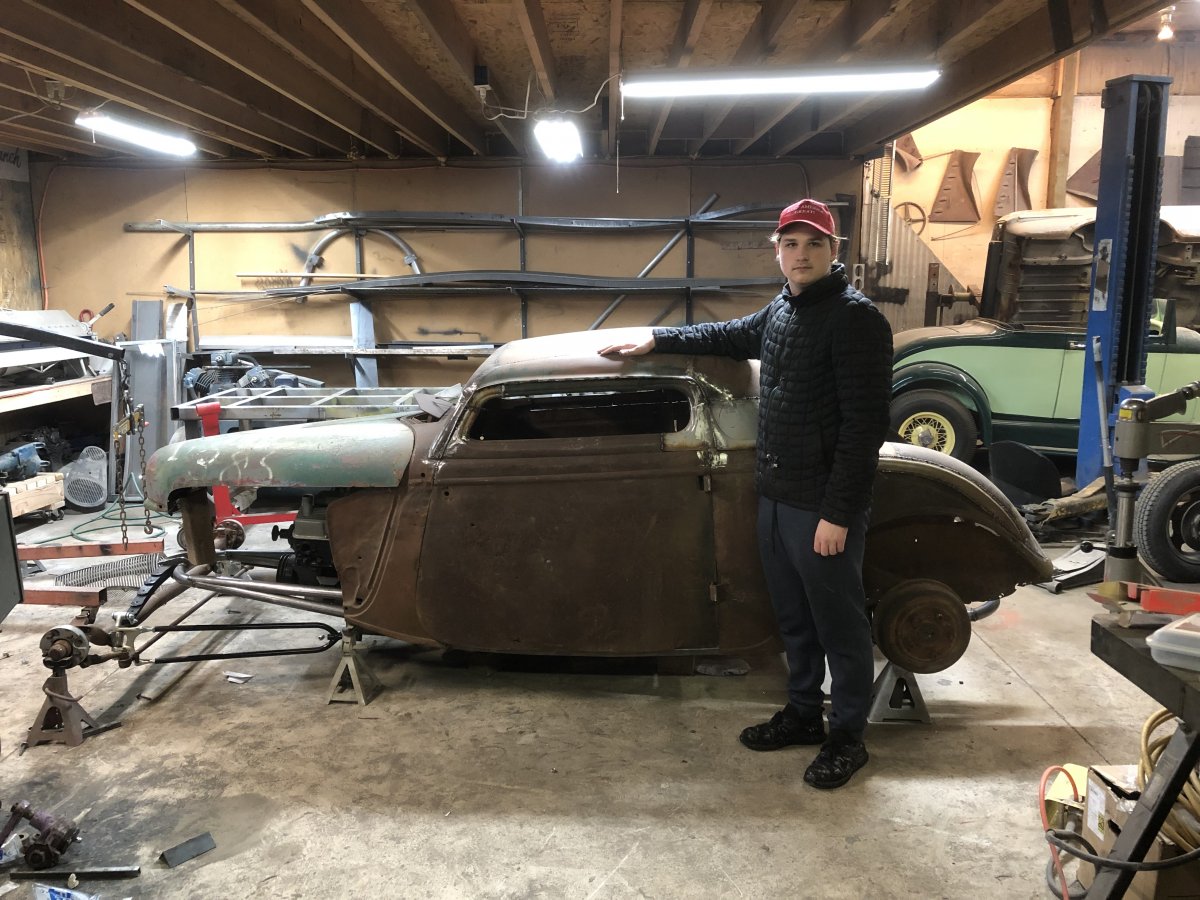

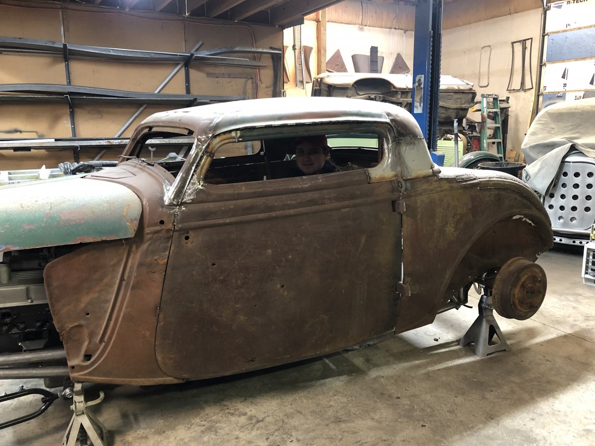

    B60ED860-0BCB-42EF-8977-B804949EC65E.jpeg 5CF8E5E2-966A-4BA9-9298-22289D99CEE3.jpeg 9D9DAFDE-A32D-48F2-B793-3881461326BF.jpeg Well, I started feeling like I was building a sand rail, so I had to put the body on and remember it is a steel, 34 ford 3w. Coupe. With the body on and it sitting at ride height I am very happy with my pile of junk. For scale, my son is standing next to it, he is just under 6 ft tall. This thing is low.
  6. Low and mean. Jim, what does the wheel base come in at?
  7. JimSibley
    Joined: Jan 21, 2004
    Posts: 3,267
    JimSibley
    116” , a little longer than stock but should help it go straight.
  8. Yes that should help her stay on track. Short wheel base can be a handful, LOL.
