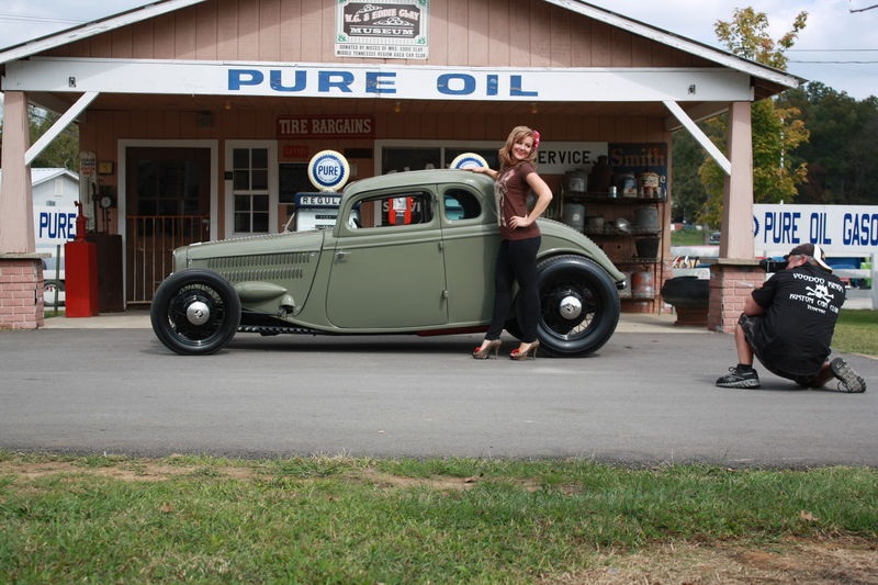

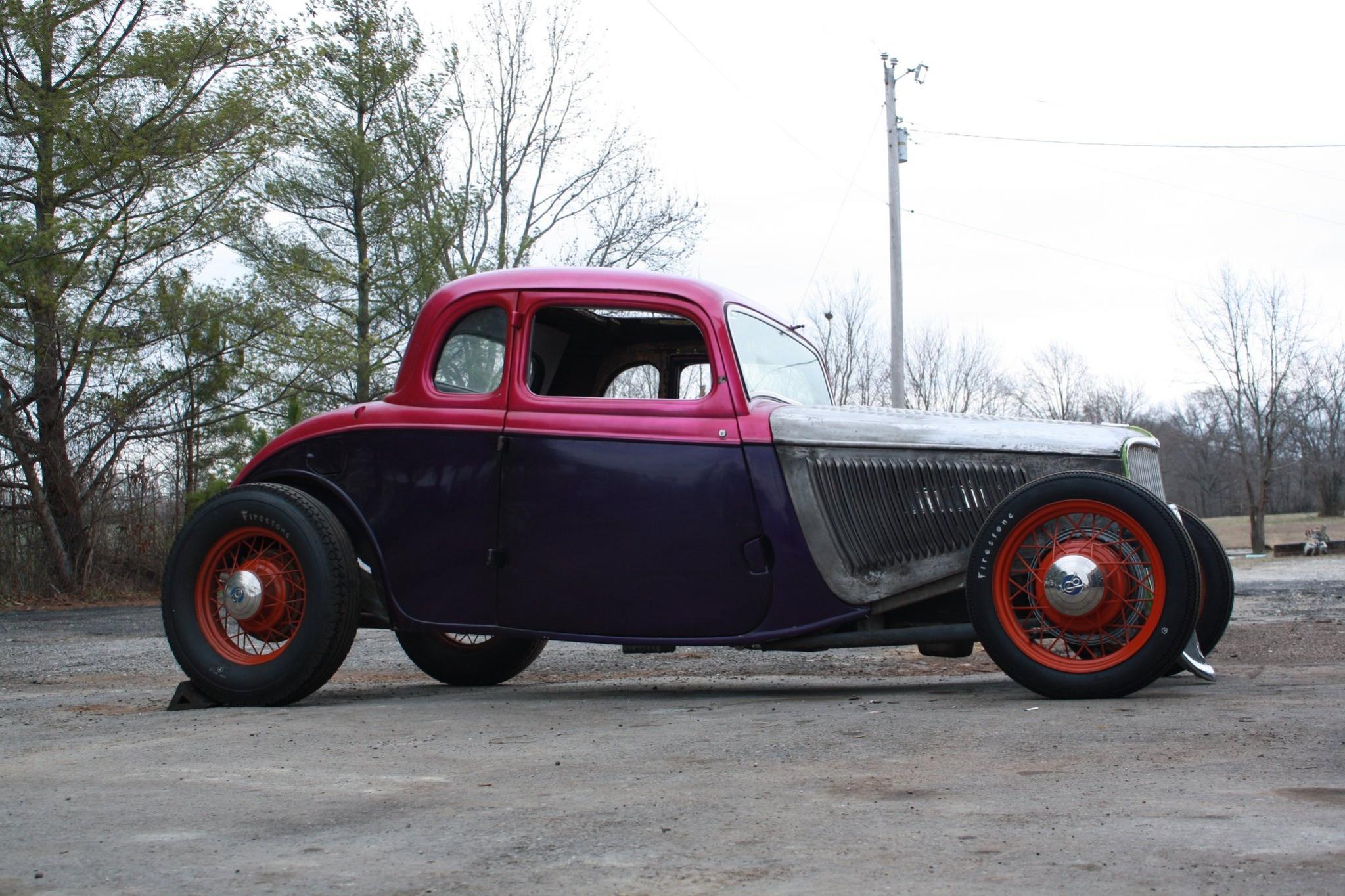

  13. Here's a couple pics to show what I mean.
    End result -
  14. Profile of end result
  15. Same car before chop and paint but after channel and chassis mods.
    The chin is on the ground in the pic
  16. Xman
    Joined: Nov 17, 2011
    Posts: 599
    Xman
    That is one bass ass 33. I love the profile. You done good!
