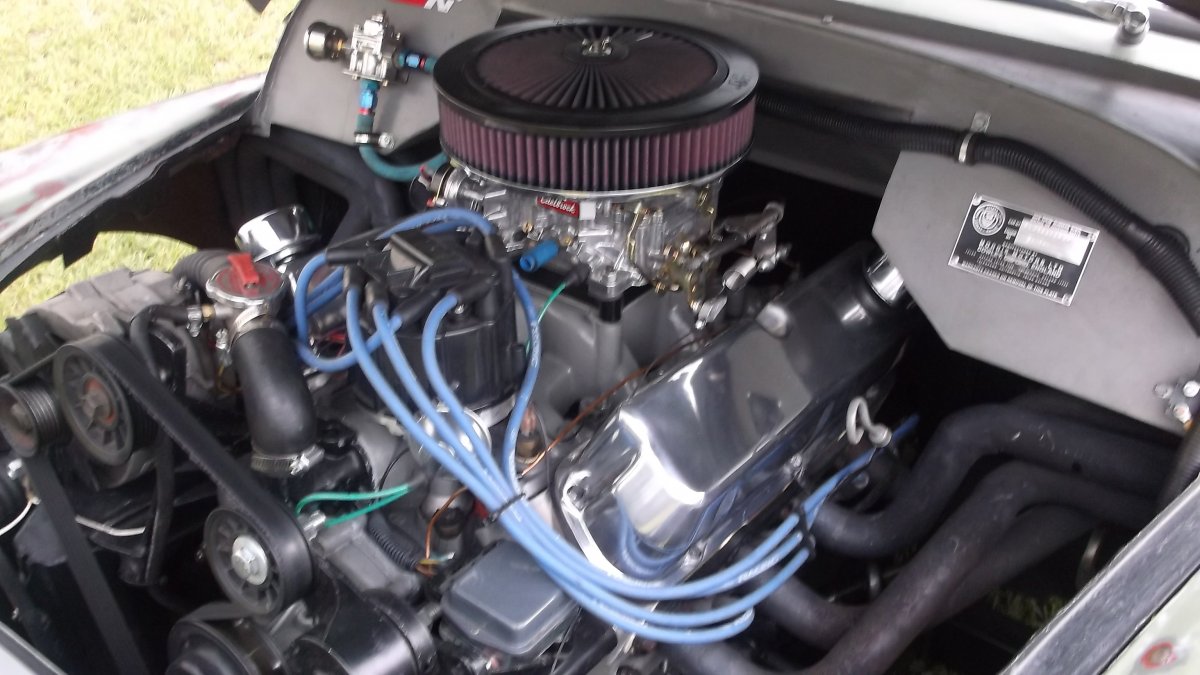

    I ran my 5.0 on 87 octane. It had Pro Comp aluminum heads , Comp .512 lift hyd. roller cam.
    Edelbrock perfomer intake and Edelbrock carb with a Summit HEI. For 3 years of daily driving. DSCF0955.JPG
    Now days you can buy a 331 kit about as cheap as good rebuild kit. Need to find why it was knocking.
