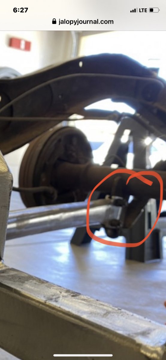

    The forward Torque from acceleration (Engine output x 1st gear trans x rear axle ratio) and rearward torque from braking will be at play back here. F3014875-86C1-44A5-B652-F71845429601.jpeg

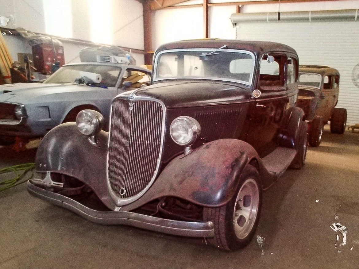

    But My Pops sent me a few pictures of the 33’ a few years ago that I didn’t have, it was still together, just sitting waiting for me!
    E5DAEAA1-A17B-4FA4-952D-207F8EE67542.jpeg 2E8924FB-7DA6-4C55-B390-516F0924F004.jpeg
  13. dumprat
    Joined: Dec 27, 2006
    Posts: 3,485
    dumprat
    from b.c.
    Looks great with aluminum slots on it!
  14. 33Doll
    Joined: Sep 27, 2019
    Posts: 1,379
    33Doll
    Yeah, I think those went with 34’ behind it, I got the wires.

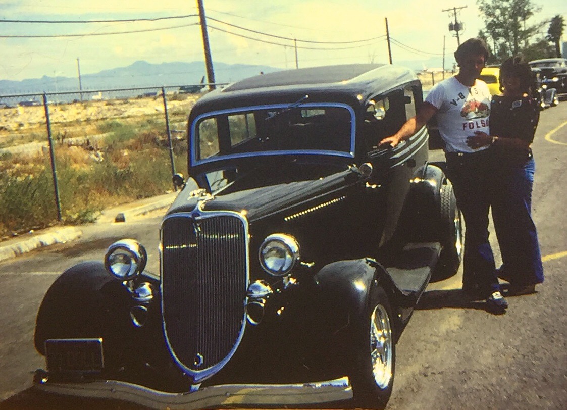

  20. 33Doll
    Posts: 1,379
    33Doll
    Thats what it had on it when I was a kid-Teen thats why I wanted them even though they are out dated
    I don’t have any good pics with them on it though. FFB81D18-7B16-4142-BCB8-69AB6DC28A28.jpeg IMG_7471.JPG
  21. 33Doll
    Posts: 1,379
    33Doll
    I always liked the stance with those wheels on it you can see the way it has a nice rake, and fat-rear look in this pic even though its blurry IMG_7018.JPG
