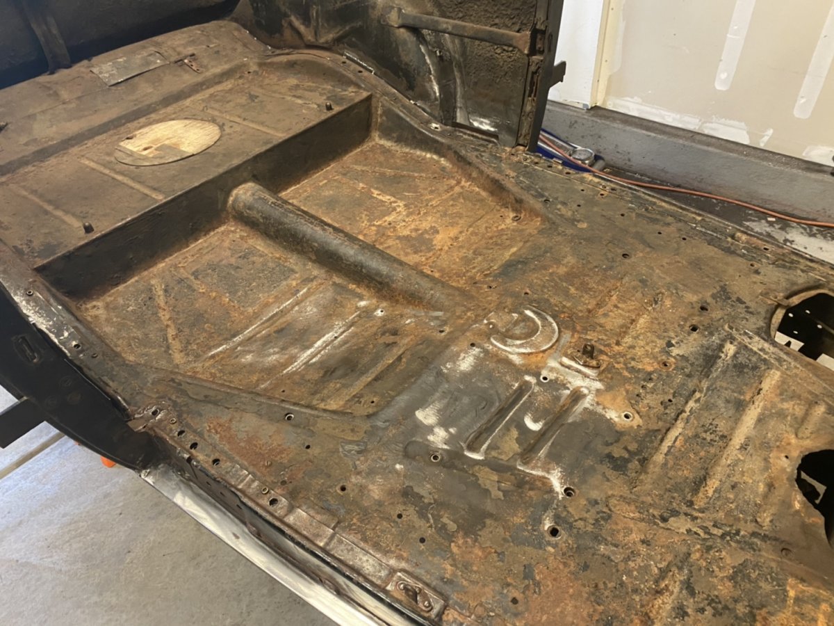

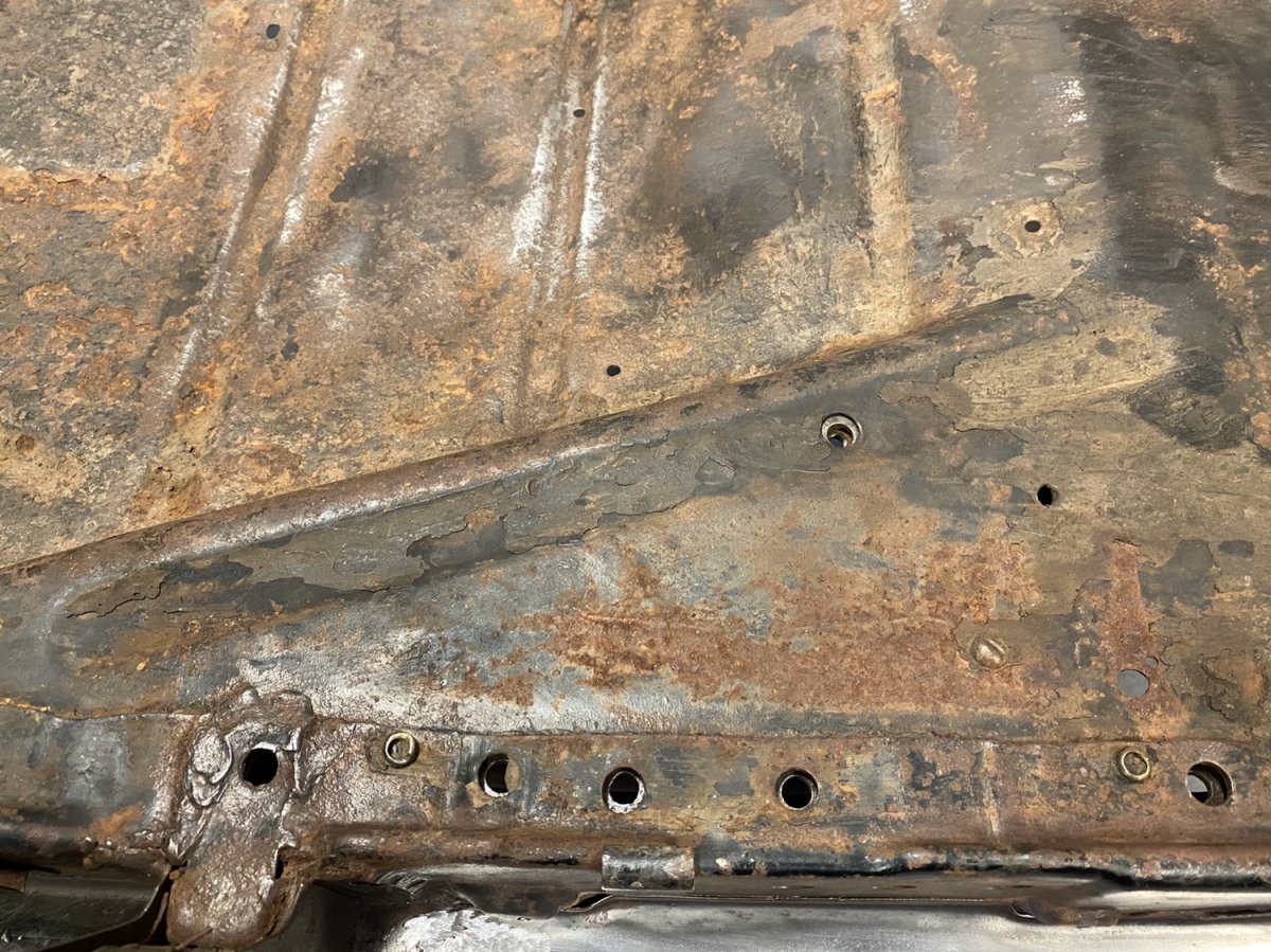

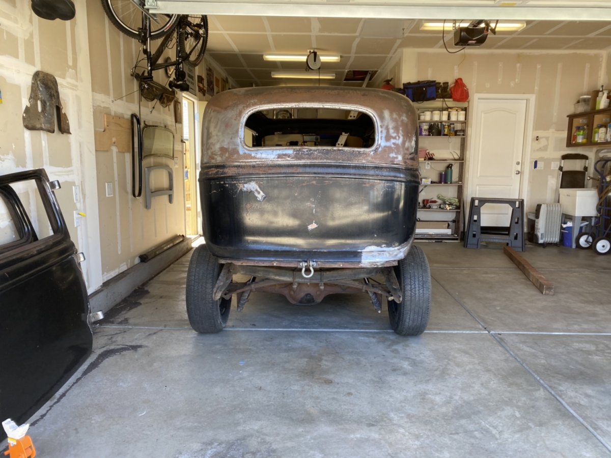

    Finally finished with all the rust replacement pieces. The Floor feet were the last. Now I can move on to less daunting Tasks! I Know this coronavirus thing sucks for most people, but if it wasn’t for me being at home these last six weeks, I would never have gotten this stuff done, I would’ve probably given up!
    Now everything should be small one day or two day tasks or stretched out and not be a big deal. Hopefully....,
    Next task is cleaning the scale,tar and rust off the floor boards, so I can fill all the holes that have been drilled in there over the years! There is alot! 40+ !

    I think most of those holes in the floor are original.
    33Doll and Stogy like this.

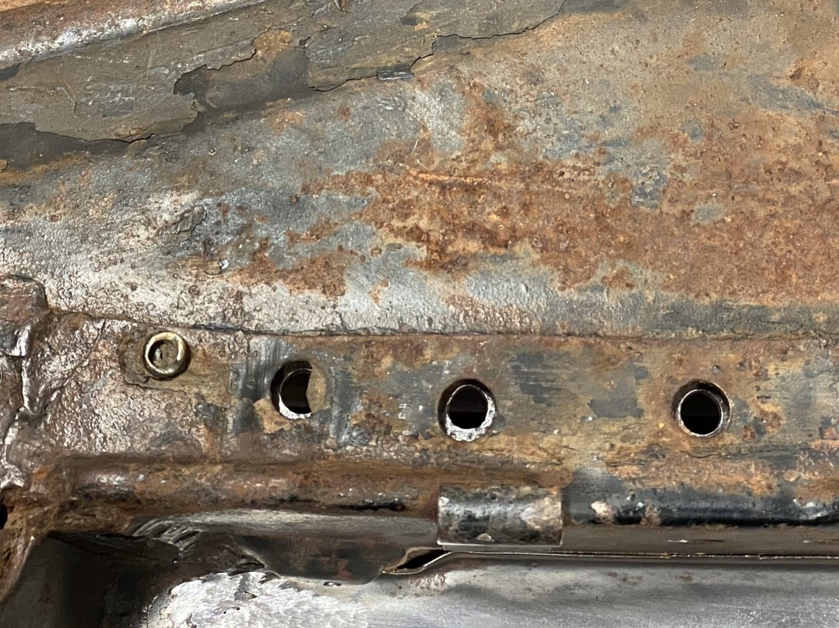

  9. 33Doll
    Joined: Sep 27, 2019
    Posts: 1,421
    33Doll

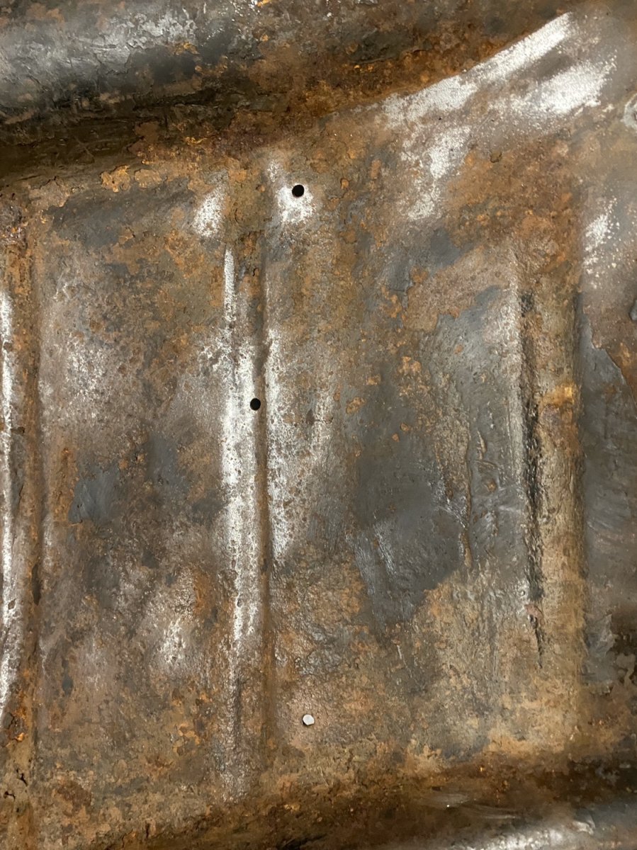

    Man I can’t figure out what most these holes were for, I know the obvious body mount ones, but this is my second sedan and the same bolts were Either missing, or a butt-load of holes weren’t used, some I know were for the original seats, (which I still have) a few for the buckets my dad put in, a few exhaust bracket holes. But still leaves alot of weird ones?
  10. alchemy
    Joined: Sep 27, 2002
    Posts: 22,333
    alchemy
    The same subrail stamping was used for the five-window and fordor with their shorter door. Those sets of three holes might have something to do with the B post being positioned in the forward position.
    The little 1/4" holes throughout the pan are for some sort of snaps for the carpet or mats.

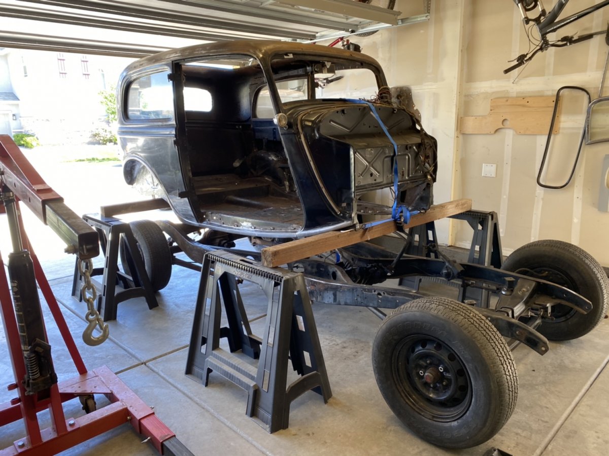

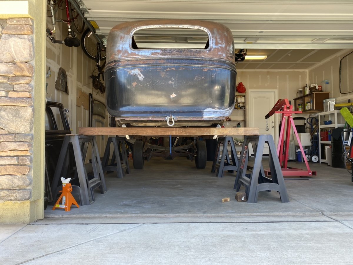

    Hmmm... work on body.... or chassis??
    Hmmm finish body... yes!

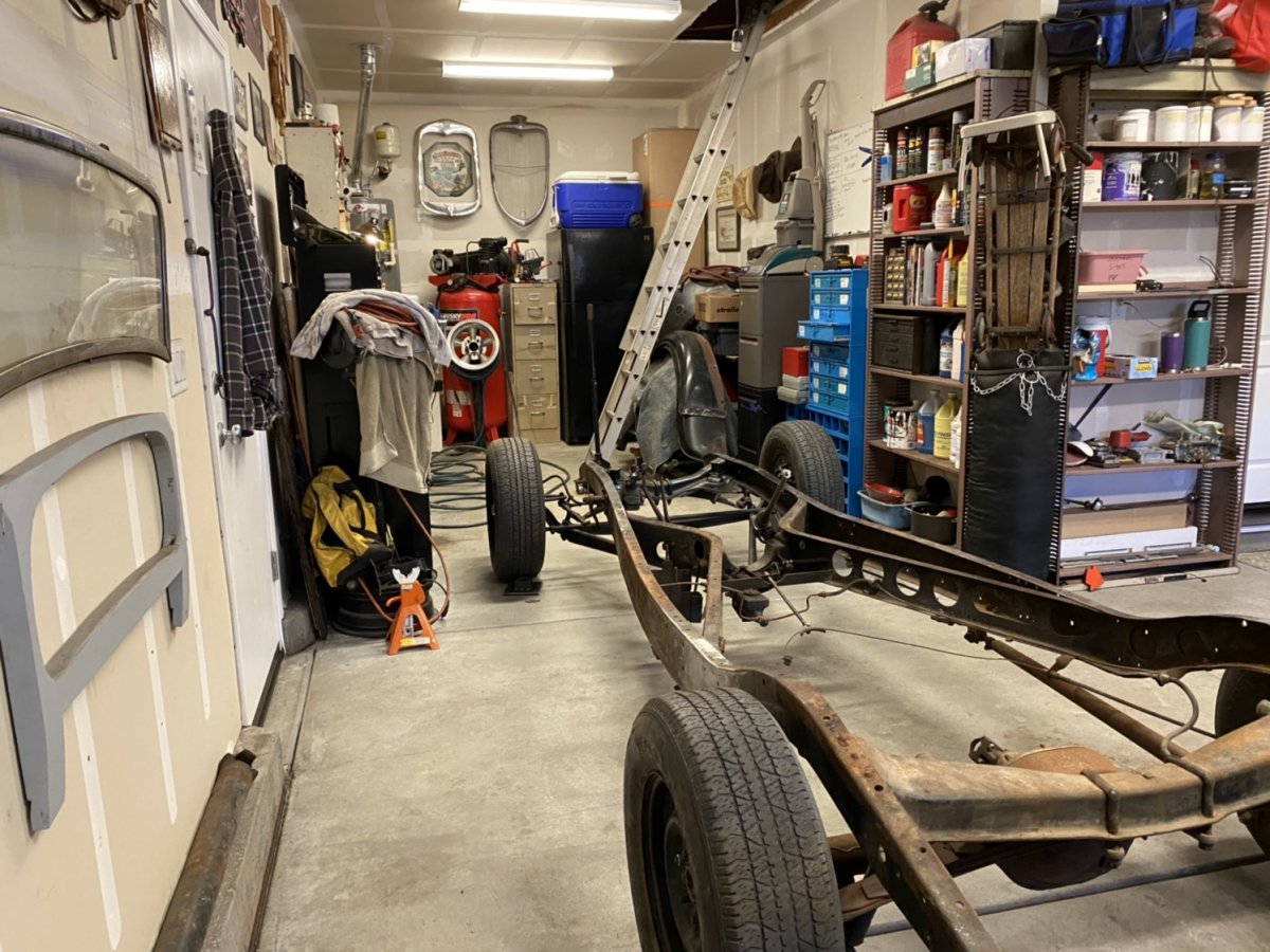

    Looking good! Curious if you are planning to box your frame? And, do you mind sharing what drivetrain you are planning? Contemplating options for my own...torn on using the existing frame, boxing it, or buying a new boxed frame.

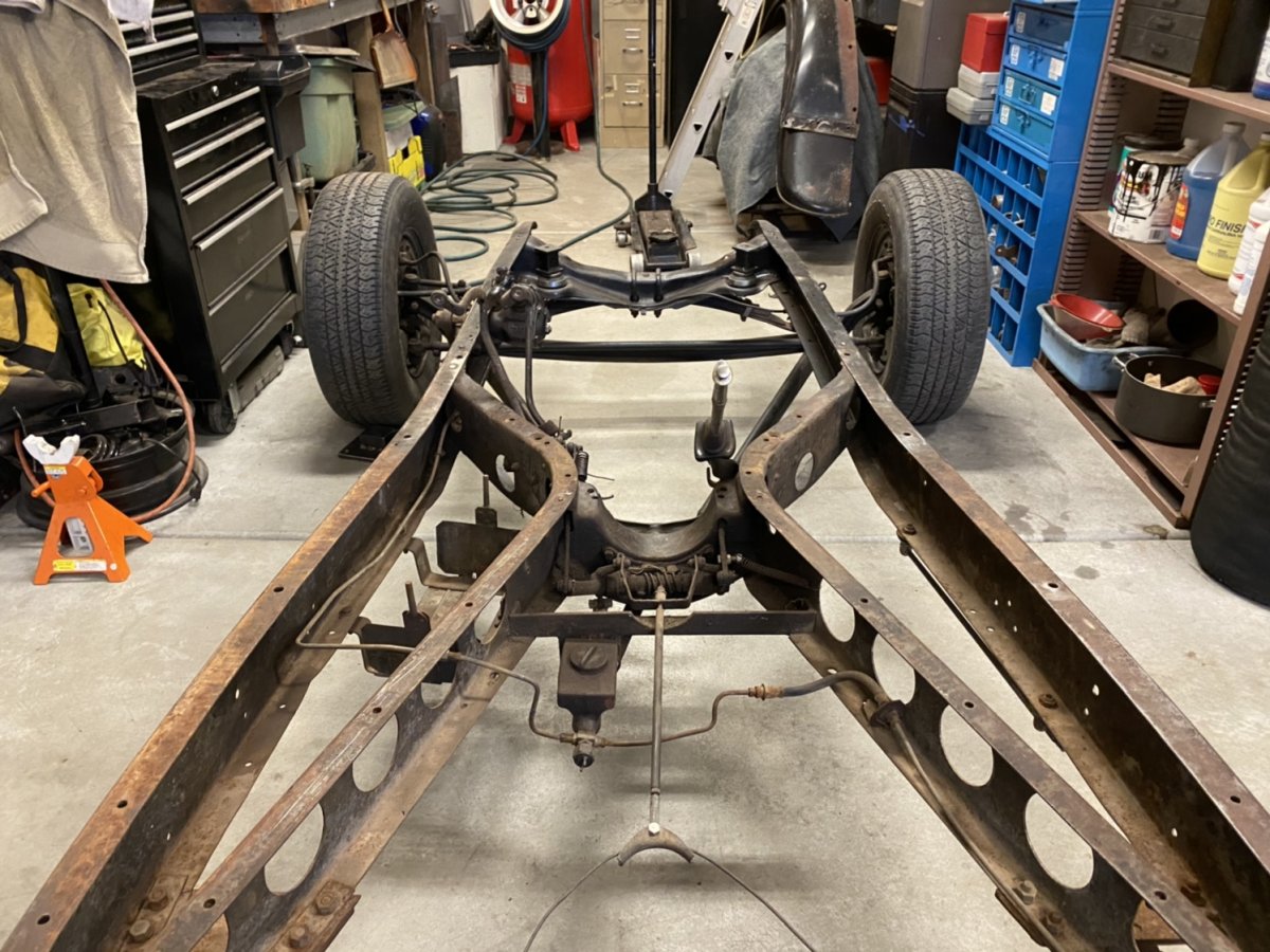

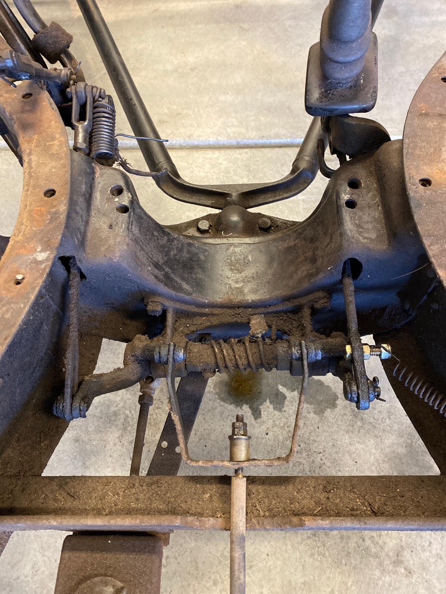

    I’m pretty much leaving it alone, other then a few improvements, and changes. I have a later Flathead and 3 speed with an open drive setup
    I will be pinching and moving the rear wish bones in about 10” apart. So I will box it where I put a cross member, in with a jog around the drive shaft, also I need to re work the emergency brake set up.
    My Dad tied it into the old mechanical brake distribution shaft, so it actually push’s the brake pedal down, and doesn’t really do anything. It bleeds down after awhile then it could roll.
    It needs to be separate from the Master cylinder linkage. Its Goofy, ( although it looks kinda cool) I’m leaving the 53-56 F-100 box because its nice and tight and really easy to steer. Other wise Id probably go to a Vega cross steer set up. I’m trying to preserve the Nostalgia, and what my Dad did but make it a bit safer. Otherwise I would just start over and do it completely different.
    I really like SoCal speed shop style chassis setup if I had money
    Hope that helps?

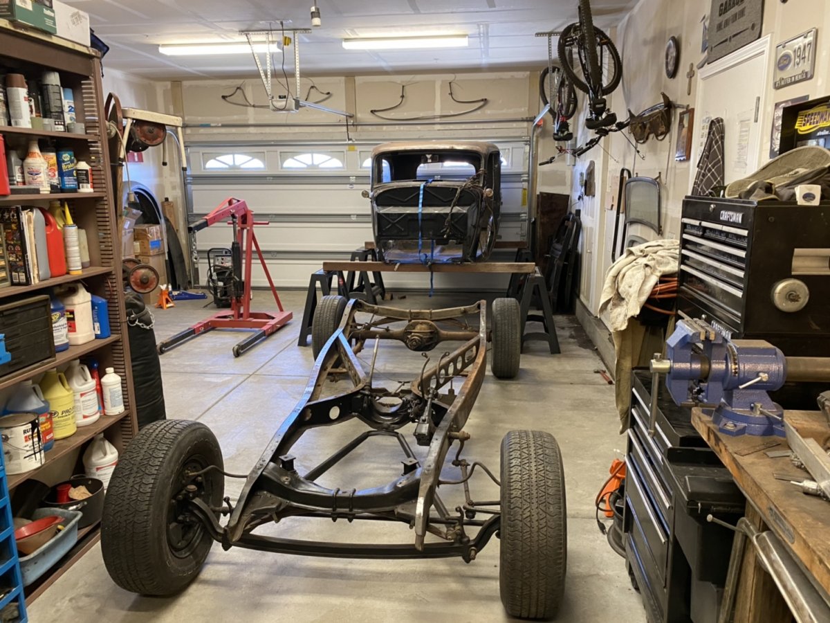

  18. loudbang
    Posts: 40,344
    I would get the frame ready FIRST. If you do the body first then the frame when you go to put the "Fixed" body back on the frame "Things" always have moved around a bit and you have to go back and work on the body AGAIN. :)
    chryslerfan55 and Johnboy34 like this.
  19. sdroadster
    Joined: Jul 27, 2006
    Posts: 446
    sdroadster
    What I have done in the past is build the chassis. Fix it, paint it, and finish your design work. Then get a roll of heavy black visqueen, and cover the chassis. Poke bolt holes in it, and mount the body. Finish your body work, make a mess etc. When your done, razor blade off the visqueen, and your build will look brand new assembled, with no primer, or wet sanding residue on the works.

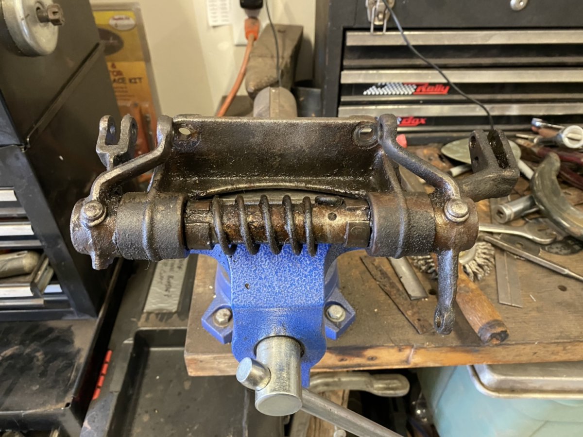

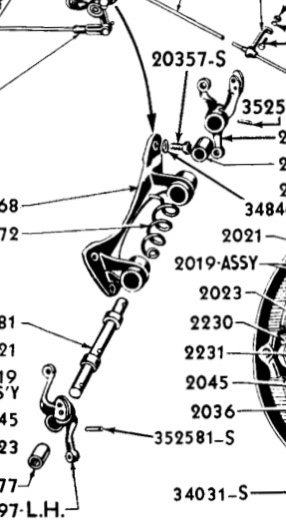

  20. 33Doll
    Posts: 1,421
    33Doll

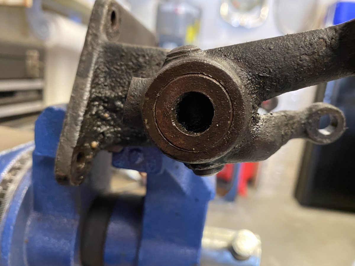

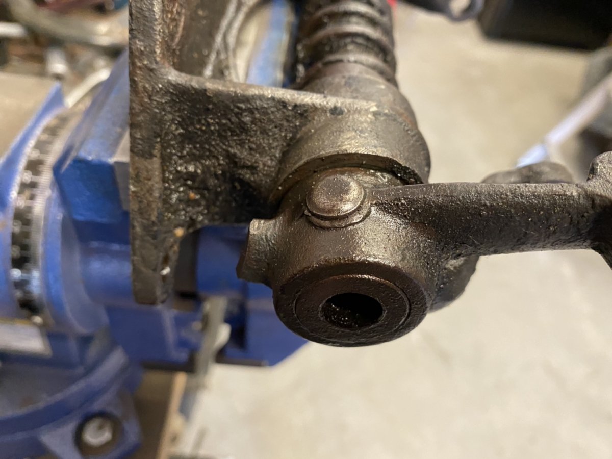

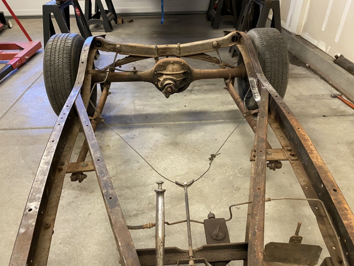

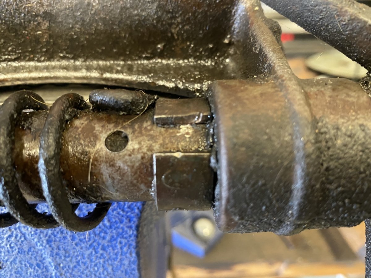

    Has anyone ever rebuilt one of these?
    It looks like a non-serviceable part so I have to machine some bushings, looks like pressed in Rivet style shaft pins, So assume grind off one end and punch it out like normal? But about these spot welded c- style? Do think they will fit through the hole when I remove the ends, and press out the bronze bushings inside? Or do they have to come off the shaft too? heres an exploded view

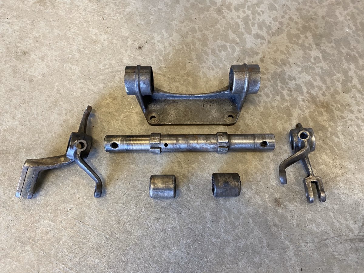

  23. 33Doll
    Posts: 1,421
    33Doll
    Cleaning and looking closer loos like I answered some of my own question!
    It looks like I remove the ends, or maybe just one end, and c bushings will fit through the main bushing housings!
    Hopefully!

  24. 33Doll
    Posts: 1,421
    33Doll
    It kicked my butt, but I won!
    Had to grind both heads off and drill the pin out, it was more like a rivet, would not budge! With force, heat Cursing!!!
    Probably gonna have replace with bolts, and tack weld the nut, I don’t know if its cast steel, or Iron.
    But, now I can machine some new bushings!

  27. Johnboy34
    Joined: Jul 12, 2011
    Posts: 1,653
    Johnboy34
    from Seattle,Wa
    Those pins are sweged in the hole, just like the pins that hold the yokes on the drive shafts.

    Boy Howdy! They were in there!
    I wonder if when they made those the rivet/ pins were red hot when they used the clamping tool, like the old movies you see with hot rivets?
