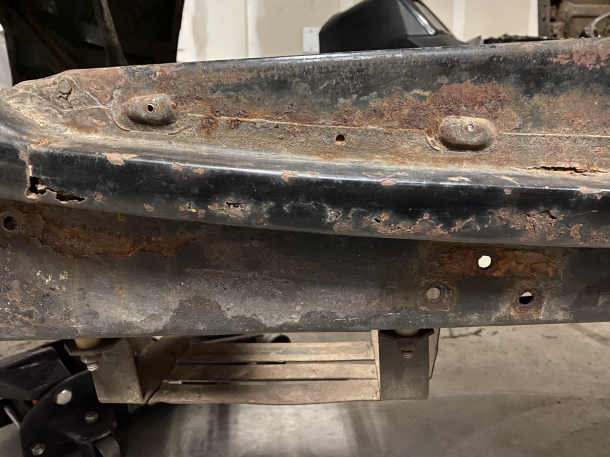

    I’m trying not to look at this right now, but its staring at me.... I want to just fix the outer edge, and not replace the whole damn thing, and do all that fitting, and manipulating the aftermarket metal to fit. Plus I’m cheap,
    I can form pieces to fit into in there!
    STOP IT Rick! Just finish the Darn quarter’s first! ....it’s looking at me...... IMG_9124.JPG [​IMG]

    So the rockers probably need replaced but the inner structure will probably clean up?
    Thinking out loud here because my '33 coupe rockers look the same (after the putty is removed).
    I'm seeing bubbles in paint hiding the truth..

    I wouldnt patch those rockers,just replace them with new ones,the repro ones have the cutouts for the trim screws.Buy the panels and see how they fit,then cut the old ones off,it will be a much better job.I have the same car as yours,it has very similar rust as well,be careful welding it together,so it doesnt warp and your doors wont fit,the body should be bolted down so it doesnt move,it is possible to change the geometry of it. Harvey
  11. alchemy
    Joined: Sep 27, 2002
    Posts: 22,335
    alchemy
    Yes, replace the rocker outer panels. As stated, there are some good ones with all the correct flanges, so it will basically be removing the old ones at the spot welds and spotting the new ones back on. And if you cleaned the stuff up properly beforehand, you might find you only need to replace a segment. Sandblast and see how far the rot goes. May be solid for the back half.
