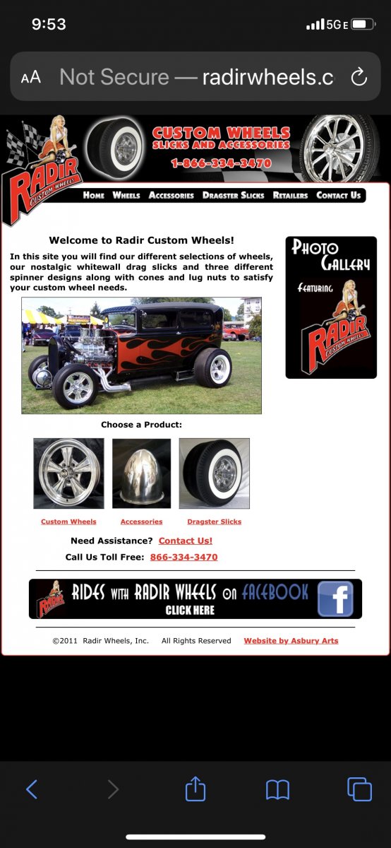

    Radir still does make them if you want the real thing, about twice as much, or more than the Rocket Re-makes!

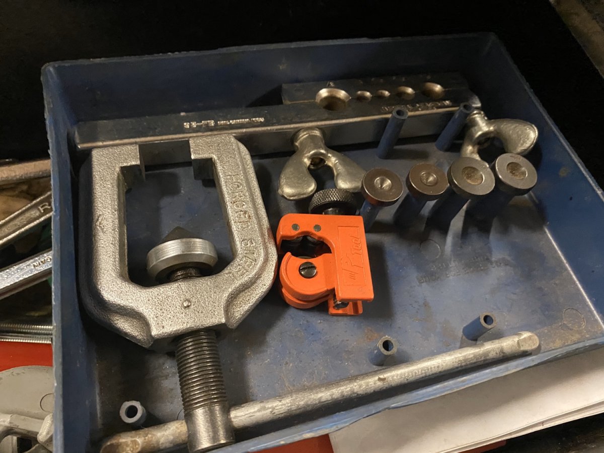

    Hey question for y’all!
    Is there much of a difference between an F 100 manual drum dual reservoir master cylinder and a mustang dual reservoir?
    My dad seems to think I should switch from the single to a dual For safety reasons, so he gave me this F100. I know that most people use a 67 Mustang but I imagine the bore would probably just be, maybe a little bigger?
    Or....just stick with the single? I already bought a new one with a stainless Bore.
    He loaned me all his flaring equipment

    YOU aren't going to be making the brk line flares...you buy brk lines!-it's not the fuel system!

    I don’t know what you’re talking about! Hot rodders cut, plumb, and flare and build brake systems all the time!
    In fact the brake system on it now my dad built years ago!
    It’s a special double flare set up you use for brakes.

    Use the dual reservoir master cylinder for safety. Good to have 2 separate circuits.

    All fun and games aside!
    My original question:
    Is there a difference, or much of a difference between a
    68-74 F100 Truck and a 1967-73 mustang/car manual drum master cylinder?
    I’m thinking maybe just the bore size-or reservoir might a little bit bigger?
    I was told as long as it’s for
    MANUAL-DRUM brakes, that would be fine.
    The 33 has 40 Ford 12” front 10” mustang rear Brakes i’m thinking it should be fine?

    68-72 F100 is 15/16 inch bore #71264
    67-70 Mustang is 1 inch bore #73323
    Otherwise they look identical
