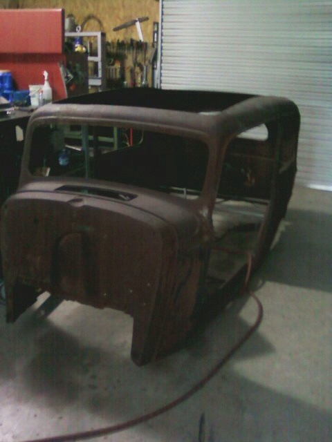

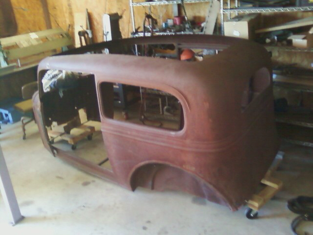

    Well it was time to start looking for the next project. I kept seeing all of these chopped sedans that I really liked, they just looked so gangster to me. Like Kirk Hannings 34 - I just think it's the coolest and was truly inspired by this car. I tried to be patient hoping a Ford would come my way. Every thing I found was out of my price range. Then one Saturday morning I checked CL again, and found this rusty shell basicly in my backyard. It was a 33 Chevy Eagle. The guy had doors to go with it that fit, but something was different about them, the top corner to the B pillar was rounded. Come to find out they were for a Chevy coupe of some sort. So I went home and thought more about it. Only to return and make a deal

  2. That tin looks pretty nice. How low is the lid going to go?

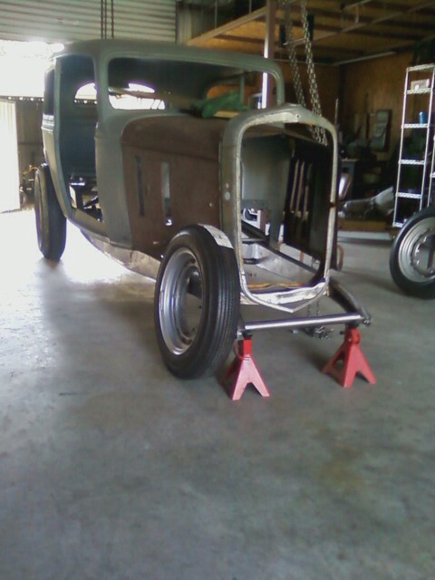

    I found an ad here on the classifieds that Bass had a couple of ASC rails for sale. So with the company van I made my way down to Bass Kustoms (very impressive shop with tons of eye candy) and made the purchase. They barely fit from back door to dash pad kissing glass ImageUploadedByH.A.M.B.1410192012.810195.jpg

    That should make a nice combo. Make sure to give them a nice taper inward so they line up nicely under the edge of the grille.

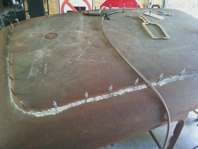

  6. bigheadbaxter
    Joined: Feb 18, 2007
    Posts: 228
    bigheadbaxter
    Yes Sir that's one big ass hole that someone trimmed the the lip out of so there wasn't any thing to attach any form of original material too. So I started reading about fillers on here and found a post recommending the roof section from an Chevy AD suburban. So I found one, and it has the perfect crest. It's from a 48 ImageUploadedByH.A.M.B.1410192813.443225.jpg ImageUploadedByH.A.M.B.1410192837.109984.jpg ImageUploadedByH.A.M.B.1410192857.059852.jpg

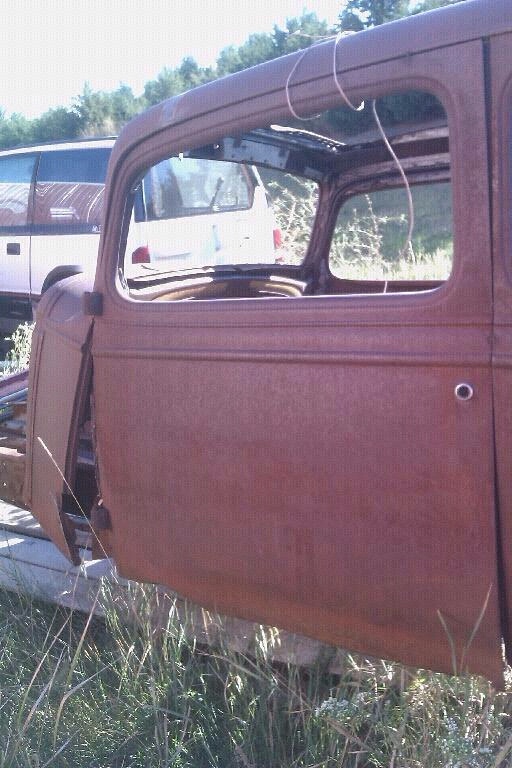

    Slowly realizing that I was missing parts that I didn't even know I needed , and didn't want to make the doors that I have work, I started looking for another parts car and found one. In South Dakota, made a verbal deal and met the guy in Iowa to make the exchange ImageUploadedByH.A.M.B.1410194850.051409.jpg ImageUploadedByH.A.M.B.1410194872.067777.jpg ImageUploadedByH.A.M.B.1410194898.218107.jpg ImageUploadedByH.A.M.B.1410194931.669078.jpg

    It's hard to tell from the pictures, but the 2nd car kinda had a frame. I was told that the bulk of the frame was a mid 30's chevy truck frame. It was set up with a narrowed ford 9in. With disc brakes all the way around. It had some name brand coil overs. It had a mustang 2 front end and the cross member you can see in the pic. It was set up for a big block. With the bird shit welds and large power plant the chassis would have literally exploded on the first acceleration. I got it home and disassembled accordingly. Sorted and sold a lot of stuff making a lot of my money back

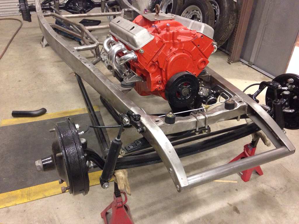

  12. bigheadbaxter
    Posts: 228
    bigheadbaxter
    As I was building the chassis I'm looking for a front end. And found an almost complete 37 ford axle assembly that I traded for the rear fenders from car number 2. I used the front spring on the rear. Fabbed up some hardware and mounted. Also used the cross member from the bastard frame from car no2. Made some ladder bars and installed also ImageUploadedByH.A.M.B.1410200393.394775.jpg ImageUploadedByH.A.M.B.1410200427.079111.jpg

  13. bigheadbaxter
    Posts: 228
    bigheadbaxter
    I failed to mention that I kicked up the rear frame horn section level with the the body. And fully boxed the frame. I purchased the Posies flipped eye front leaf spring and added to the dropped front cross member. I had the I beam stretched and dropped by Nostalgia Sid. Purchased Lincoln backing plates from Wilson Welding with brakes. Split the bones and installed. ImageUploadedByH.A.M.B.1410211560.169020.jpg ImageUploadedByH.A.M.B.1410211597.718600.jpg ImageUploadedByH.A.M.B.1410211657.519316.jpg ImageUploadedByH.A.M.B.1410211745.569022.jpg

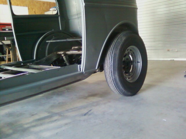

  18. bigheadbaxter
    Posts: 228
    bigheadbaxter
    With most of the rust gone I was able to concentrate on the daunting task of replacing the wooden structure with 1in. Square tubing. So I bought a bender and the dies that were for 1/2 square tubing and had them opened up to 1in. ImageUploadedByH.A.M.B.1410267537.286425.jpg it worked really well. It's almost like a mini roll cage through out the whole interior of the car. Radius bends over wheel wells,windows and under dash then tied it all together and it also gave me something to weld interior sheet metal to. Also used the roof bracing from the donor roof. Cut it to fit and put it in place. The inner structure is many times stronger than the wood ever was. I did this before chopping so there was plenty of support and no 'springing' action ImageUploadedByH.A.M.B.1410268378.386884.jpg ImageUploadedByH.A.M.B.1410268443.902797.jpg

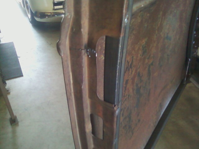

  19. bigheadbaxter
    Posts: 228
    bigheadbaxter
    With the body mostly braced I need to get the shaky ass doors supported, but that meant I had to get the doors swinging and latching. I purchased the mini bear claw latches and welded them in. Then positioned the door as needed and again bent and braced with 1in. Square tubing.

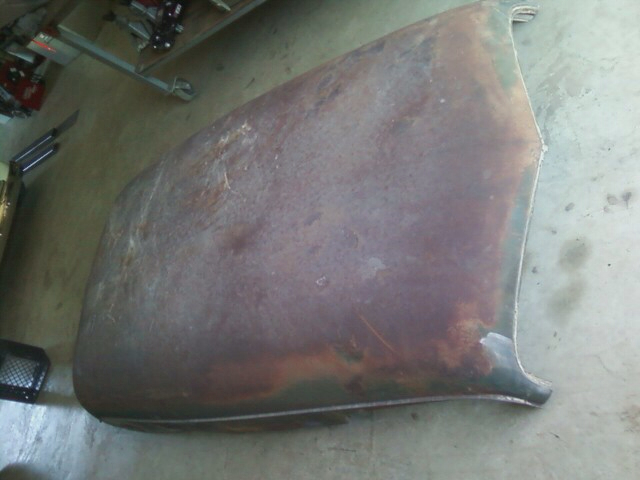

  23. bigheadbaxter
    Posts: 228
    bigheadbaxter
    The 1st car came with a 1933 chevy truck grill, little did I know at the time. And didn't know this until I got the parts car no.2. The car grill is much smaller and fortunately the car grill was in much better shape but still needed repair. While fitting the body and hood to the chassis I realized the grill was now way to tall , so I had to take out almost 2 in. To get to fit right. But first I had to have the old chrome stripped off at the chromers. ImageUploadedByH.A.M.B.1410285803.668769.jpg ImageUploadedByH.A.M.B.1410285833.518749.jpg ImageUploadedByH.A.M.B.1410285885.085753.jpg ImageUploadedByH.A.M.B.1410285961.485378.jpg so after it was stripped I chopped it and trimmed the insert, and with the truck insert I cut out a piece to weld in to fill the crank hole (funny word) then found radiator cap cover that I think is from a 34? The Eagle is cool but a little to busy for me
