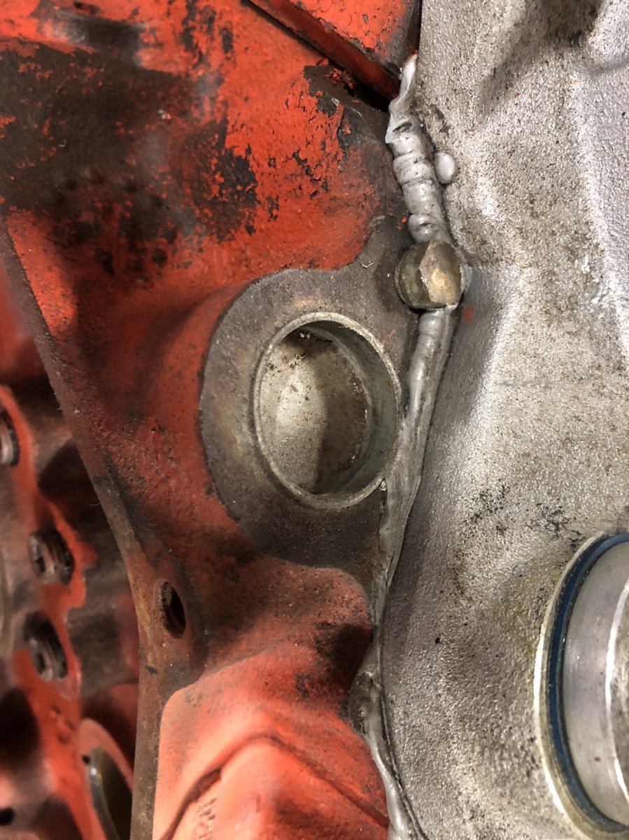

    It probably is a freeze plug, blocked off by a previous owner for some reason, probably installed a pcv into a valve cover and did not need this to be open.
  3. 1934coupe
    Joined: Feb 22, 2007
    Posts: 5,216
    1934coupe
    It is a freeze plug, a common practice when the road draft tube is not needed. A year Corvette used this for the PVC.

    I have also heard this and also don’t have anything to back it up. The other possibility could be a marine engine. I had a pair of small journal 327 marine engines that were original in the boat but can’t remember if the boat was built after 68. I have a marine block that’s a roller block that has a fully machined and functional mechanical fuel pump boss that would not be there on that year production automotive block.

  9. I can verify these castings were used for counter exchange C/E (deck
    pad stamped) block into the early 70’s 68-72 ish and your block is a 71 variant
    I had one that I got a good deal on, that was only bought for the steel 327 small journal crank that was inside it that i needed for a early chevy 2 block build.
    one thing for sure is these 3959512 blocks are HEAVY. and i mean significantly more weight than any other small journal 283 or 327 block that I have manhandled into the back of the truck. in fact i can just move a early chevy 2 283 and 327 bare block by myself in and out.
    but that late 60’s early 70’s 512
    327 bare block casting forget it....it just tipped the scales at more than i could handle. (they are dense)funny thing the early chevy 2 blocks were both 283/327 and I have moved several without issue. BUT they must have reinforced the 512 casting or added nickel or something cause they are TANKS !! for a 2 bolt main. the one i had was std bore 4” and almost no cylinder wear taper. I see why guys snap them up. their stout
    the 512 block i sold had a road draft tube provision.
