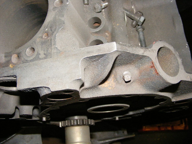

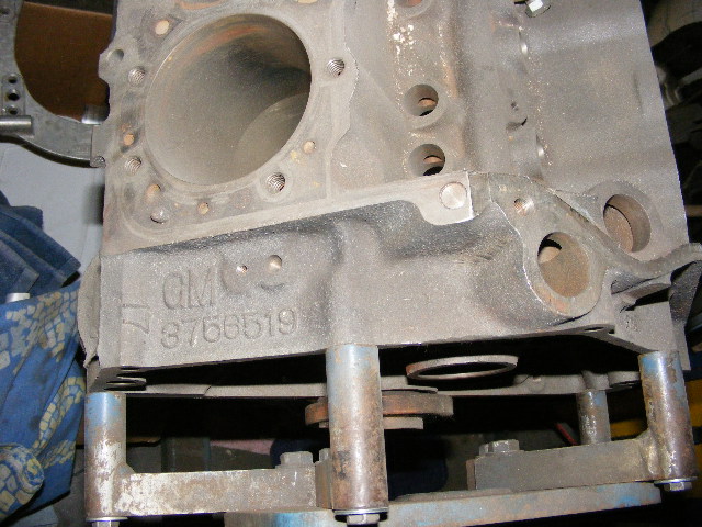

    Where's the OP?
    Here's a 519 block, N 1 2, with a 3" stamp pad and web...…………………..
