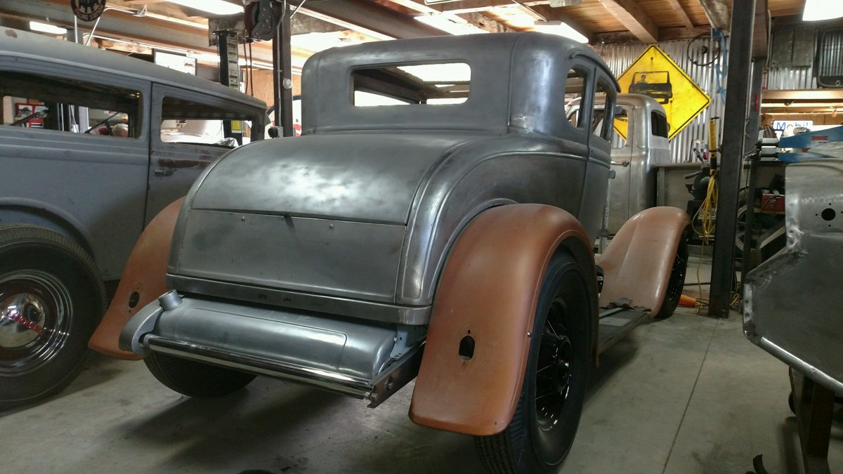

    I'm putting the '32 tank on my coupe, Dagle's Hotrods in Oregon has the frame extension that welds to rear crossmember; IMG_20160729_144152571.jpg

    The Model A frame basically ends at the rear spring hump. You need a set of rear frame "horns", spreader bar and of course the tank. The frame horns must be welded to the chassis. You can also cover the frame horns with covers pictured on the driver side of the above picture. As Mr. Breeze points out Dagle's has the kit to do the job. Several years ago there were several shops offering the kits, but I haven't seen one lately. Nice look.

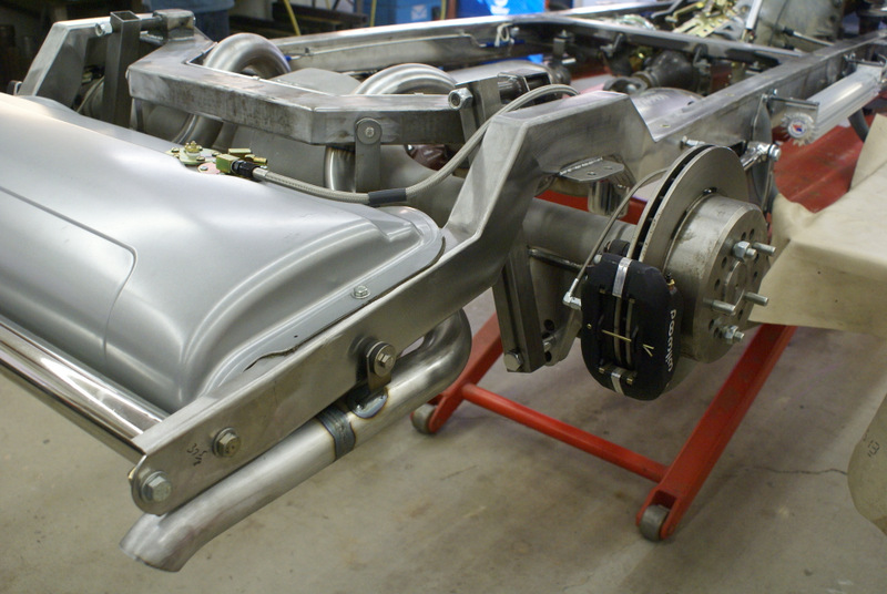

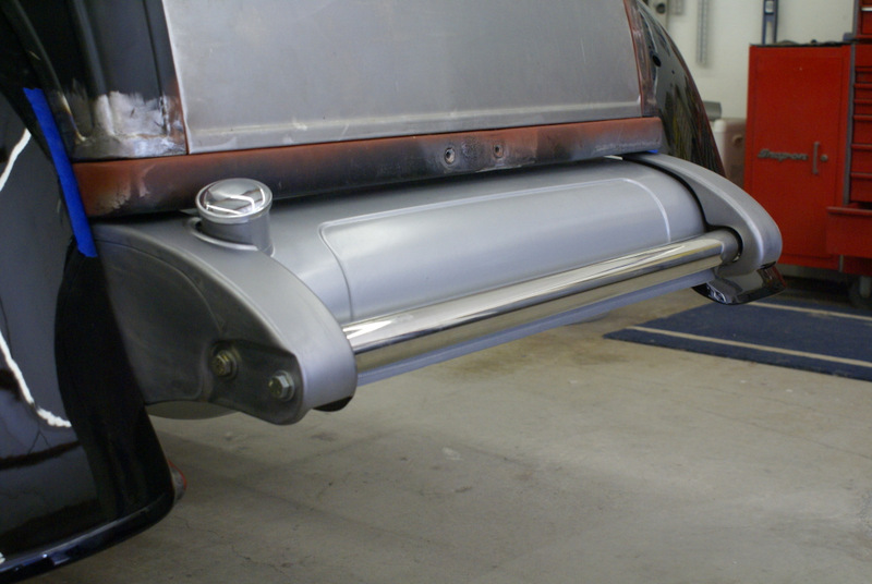

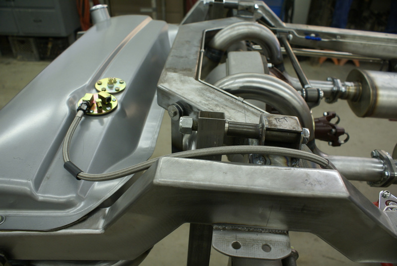

    Stogy, kidcampbell71, dwollam and 4 others like this.

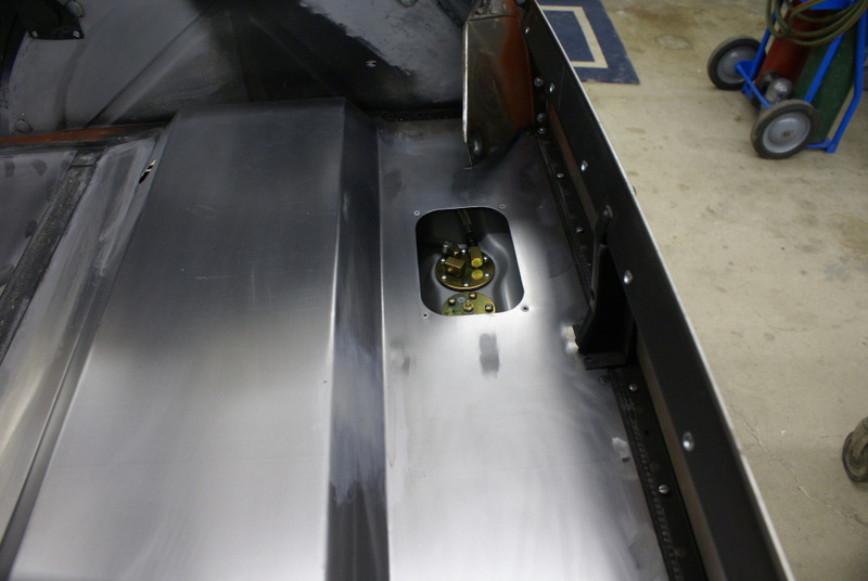

    Stogy, 30ARoadster, dwollam and 2 others like this.

    That doesn't look like a "pain" at all. Just looks like basic hot rodding. Hold the tank up in place with some wood blocks, and make frame rails to fit. Maybe need to slice and dice the frame horn covers a bit, but that's simple bodywork. Am I missing something? Does the tank need to be narrowed?
  10. The tank does not need to be narrowed from stock size. I done this on my 29 sedan years ago. Really liked the out come.

    I like what you did to hide your coil overs and frame rail in your trunk. I was planning to make two boxes, one for each side, but after looking at yours, I think a box that goes from one side to the other might look better and still allow me trunk space.
