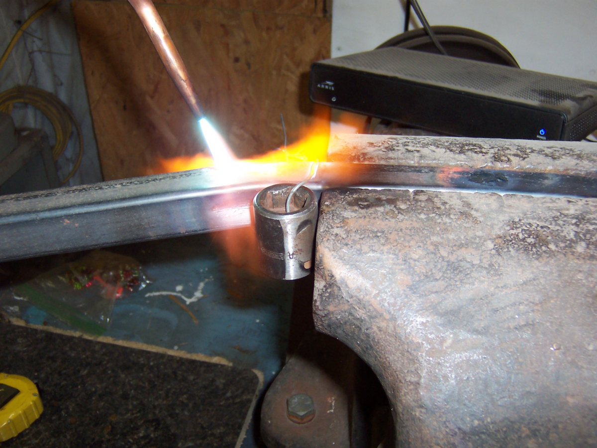

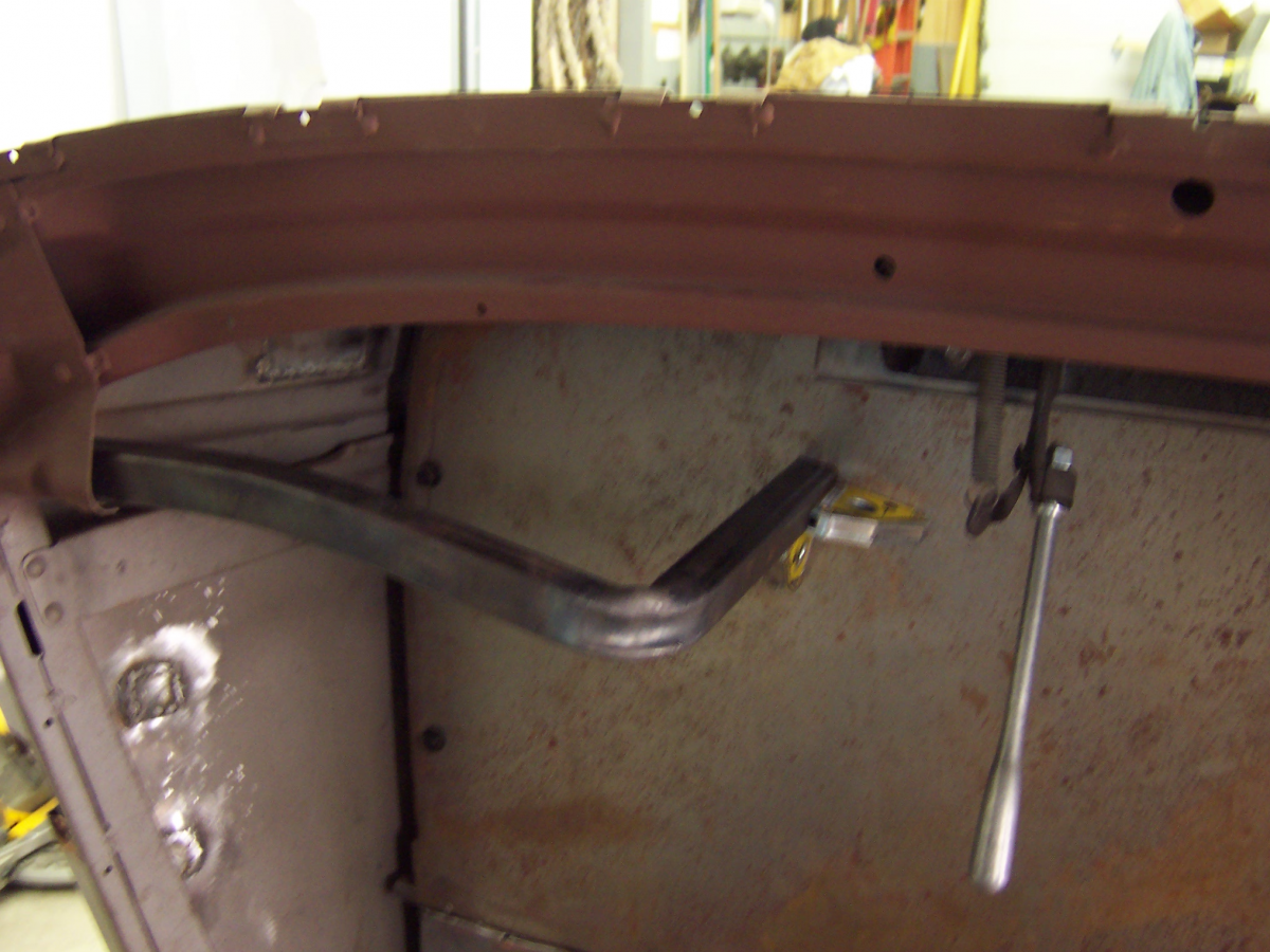

    First we decided to build a strong support system for the column by starting with some 1x1 square tubing. The car has manual steering with a quick ratio Vega box so we want the column to be sturdy.
    We dimpled the tube for bending.
    Then heated and bent around a socket.
    Then bent to shape.
    Then a trial fit. This will sit just behind the dash and not be visable. The column drop will attach to this tubing. We will also have another piece of tubing drop down from the primered metal you see here. This will give us a strong 3 point mounting system. We will finish this later.

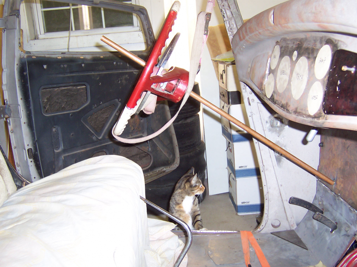

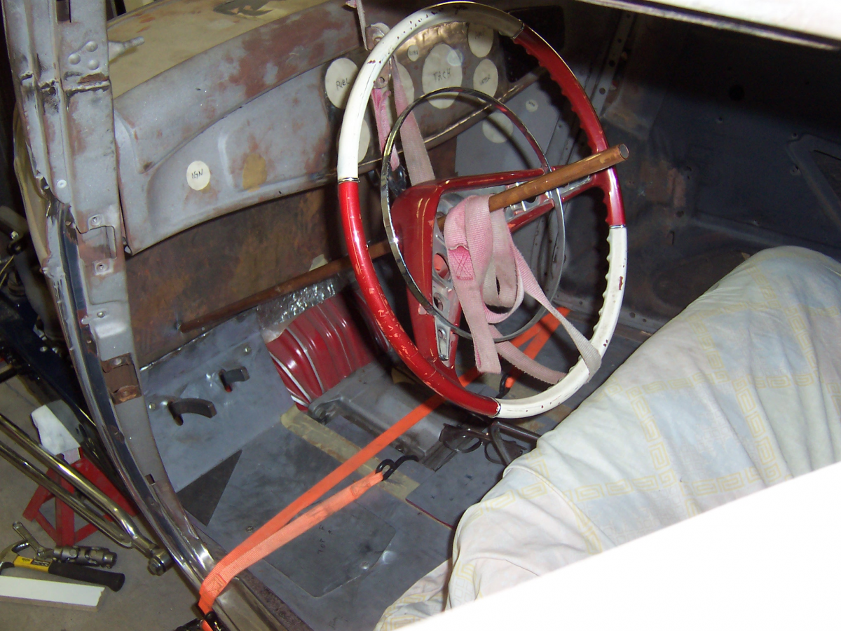

    Next we moved unto steering wheel placement. We tack welded a stud to inside of firewall to hold a mock up steering column made from 1/2 copper tubing.
    We then hung the steering wheel on the copper tubing and adjusted it with an adustable strap hung from the roof until we got it in the best position. In this position we were able to;
    1) get in and out of the car
    2) be comfortable
    3) work the pedals
    4) see out the windshield
    5) have about 2-3 inches between door and steering wheel.
    Soooo .....have we missed any thing about steerting wheel placement??? Have you guys learned anything you can share??? or warn us about such as bad angle, wrong look, anything??
    Thanks, Greg

    It looks like a good methodical approach.
    What I see that I would check, is the lower column location going through the firewall area..... are you clear of the header or manifold?
    Stogy likes this.
  3. F&J
    Joined: Apr 5, 2007
    Posts: 13,281
    F&J
    Back the camera away on some of these pics. The photographer knows the car in person, we can't get a better wide view, IMO
    I did see the same first issue like Fedman said. Mine is a 5w so I lost my "bearings" looking at pedals in first pic and the later pic of pedals. 3w is so different as to cowl kick area.
    The column up high is great if you can make it get to the box Ok. Footroom for 3 pedal 32's is a premium.
    The steering wheel pic is also too close, and having it droop at an angle on skinny pipe can throw us off.
    I must say I look forward to your car build on here...hint, hint.. Love the wheel! and it makes me know more good stuff will show up

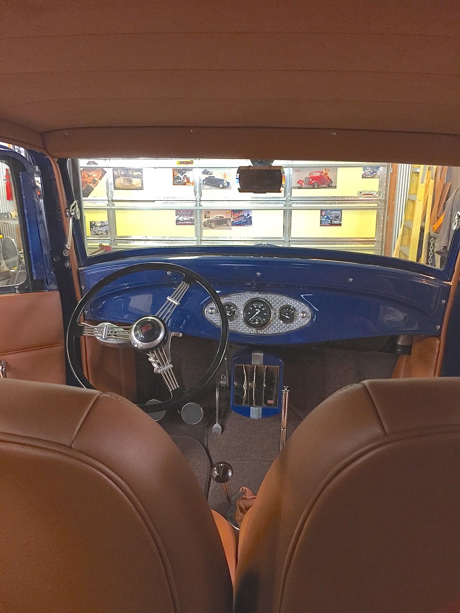

    So far it looks like I have good clearance for some universals where the lower end comes out the firewall. I am probably going to need 3 universals. (Copper tube is just for mock up)

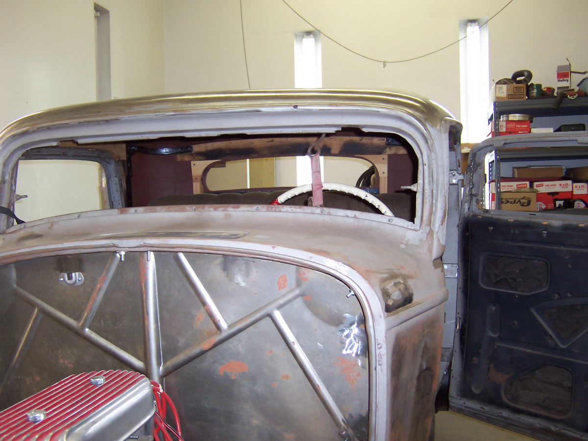

    Here are some better photos of steering wheel placment...not much better.... but at least farther back .
    This is how it will look through the windshield.
    Another side view. And the greatest 32 Ford mouse chaser, Audi, always on duty to make sure I never see mice poop in my new car.
    A view from back window.
    One final picture. My 3 sons are between 6 feet and 6' 4". I am 5' 11". This seems to be the best placement. Have I missed anything before I cut the fire wall?? F & J you are right pedal real estate is small on these babies!
    Thanks for your ideas! Greg

    Much better pics to see why I was disorientated. I nowbelieve it is your flat firewall, and the slight curved angle floor piece that made me think it was a lot higher where you want to cut the hole. I'd bet it's close to mine, my exit hole seems lower only becauseI still have the lower stock 32 wall that bumps forward where the column hole is
    Ford blue blood is so right. Sit there with no family distractions at all. The door closed is needed with the big wheel. The door window opening also helps in mockup. It give a sense of your orientation in the car. You don't want the wheel too close to door , and it's handles.
    What he said about not rushing the seat sitting/thinking is so critical,
    You are fortunate in that your choice of bellhousing, trans size and it's height will really help in heel room for gas pedal. Heel room and angle of ankle in both directions is very important
    Looks great so far ...chop and wheel type...winner

    I assume that is the size steering wheel you are going to use. 2 or 3" between the door and wheel may be tight with upohlstery when you turn with your left sandwich clamp.

    FWIW. I think it is too low and to far to the rear. You may have trouble getting in it.

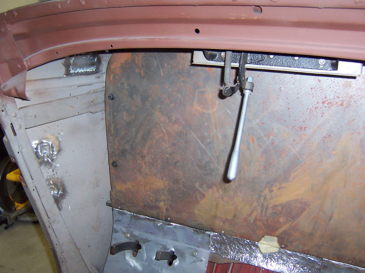

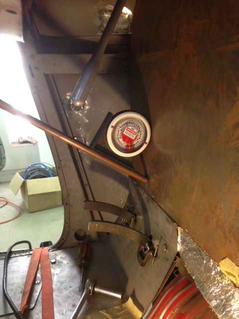

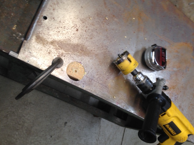

    I worked on the steering today. First I measured the angle of the mock up copper tubing steering column. Ignore the handle for the cowl vent which is right in the center of the picture. I am not much of a photographer.
    Then I cut a piece of 1 3/4 cardboard tubing I found laying around at the same angle. This was one step better than the tubing to visualize the column.
    Then I removed the inner firewall sheet metal and marked it for a hole.
    Then I took a deep breath and cut into it.
    Then a little deburring.
    Next I reinstalled the inner firewall sheet metal and used it for a template for the outer firewall. I was able to hold the cutter at an angle so the column should fit nicely. Now I just have to decide on which column to use I like the Old School type but they are for 3 bolt and I haven't found an adapter to go from 3 bolt to 11/16-36 spline. I might have to make one. Now with the hole in the firewall I know how long of a column to order.
    Now I have a question. This thread will be slow for awhile until I get my new steering column. I am now going to start on the gas pedal. Should I start a new thread for the gas pedal or add it to this one. If I add it to this one I have to change the title. Can that be done? and if so how?

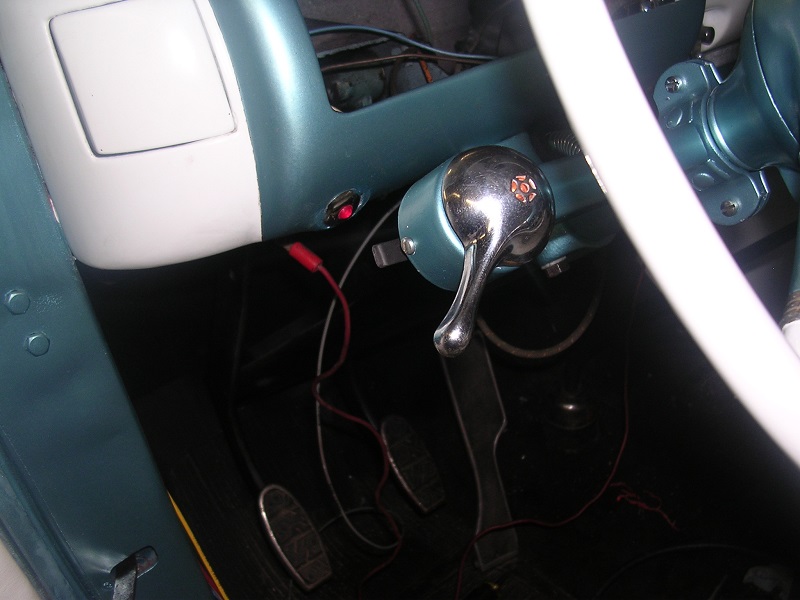

    I have to wear smaller shoes when driving my Tudor. I have stock pedals and the column is an F-1 so it exits the firewall slightly lower than stock. Probably a few inches lower than the OP's column mockup.
    Stogy likes this.

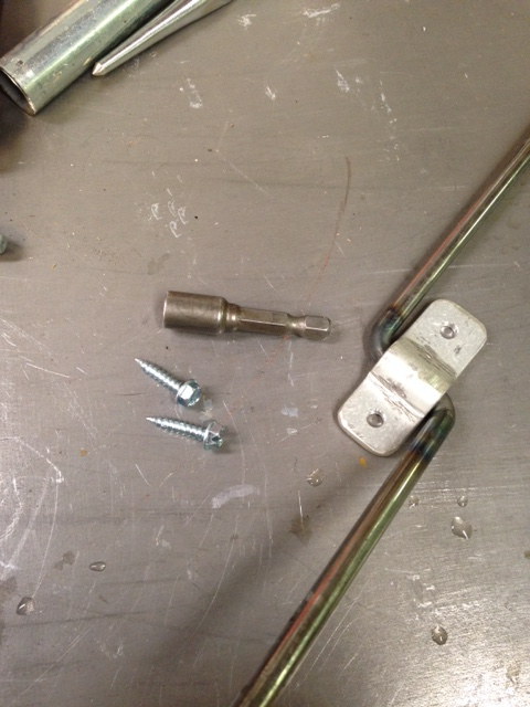

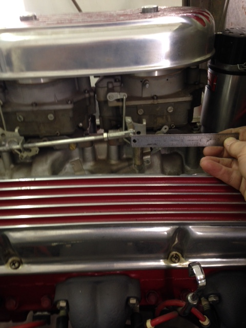

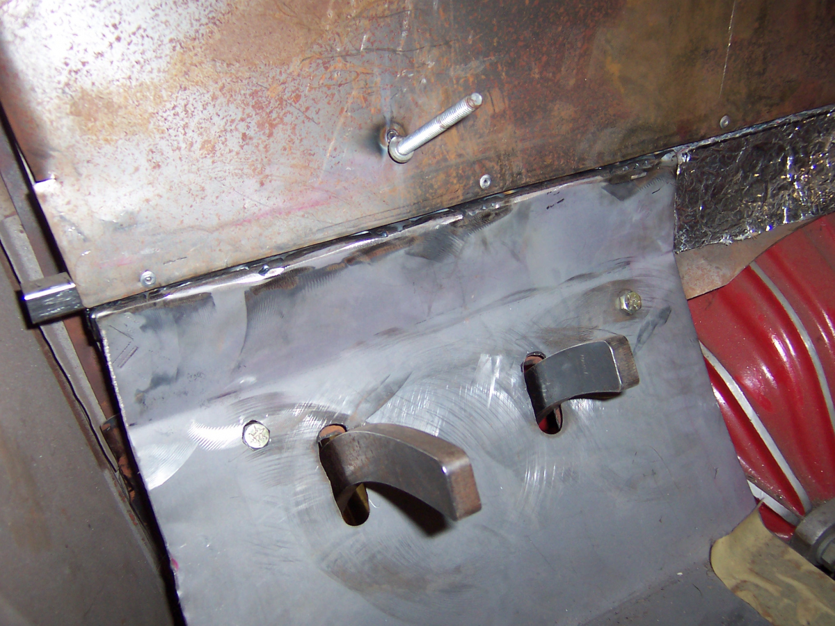

    Now I am moving on to the gas pedal. As F &J stated above heel room and angle are very important for comfort so I decided to do a practice gas pedal. I will make a mock up pedal so I can adjust and try out comfort and function. Also, I need to get the ratios just right so pedal is not too sensitive or to lazy. Who am I kidding...I will always have the pedal to the floor so maybe it doesn't matter....
    First I measured carb travel. It is 1 3/8 idle to WOT.
    Then I found some exhaust pipe to make a spoon for the pedal. I cut it out with a angle grinder.
    Then a little grinding the spoon to size.
    Then a little heating, bending and welding.
    Next I took a piece of aluminum to form a bracket on my trusty anvil. Clearly that anvil has seen better days but it still works.
    A little drilling in the bracket and using some self-piercing screws and it is ready to go.
    Finally installed in the car. Later I will add a return spring. The rod is only 1/4 inch so I can bend and adjust to get it in the best location, angle ect. This is only a mock up pedal the final pedal will be stronger. any suggestions on pedal placement?
    Greg

    "This is only a mock up pedal the final pedal will be stronger. any suggestions on pedal placement?"
    Glad you said mockup only, because as you know, the horizontal center gas pedal pivot shaft needs to have a nice bushing, and wide enough to prevent later erratic slop.
    You really should put dummy pedal pads, even though it sure looks like the brake one won't be close enough anyways.
    When I said I had but one "foot hangup" on my fresh build road testing; here is what happened:
    My nervous second ride, being rushed to get off busy road and cross traffic to side road, I swung right foot to find brake, my toe end hit the column, so I too quickly moved my foot to the right again, misjudged location and mashed brake WITH the gas. Hasn't happened since, it was a freak event.
    Was it poor planning on my part? not really, as the big extended block engine comesa bit into the toe board, which almost eliminates a proper gas pedal placement. I could not move the column higher at floor, as the head would be hitting,
    I see your well used,beat up tools.......this will be a fabrication type build that MANY people like :)

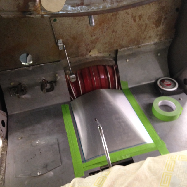

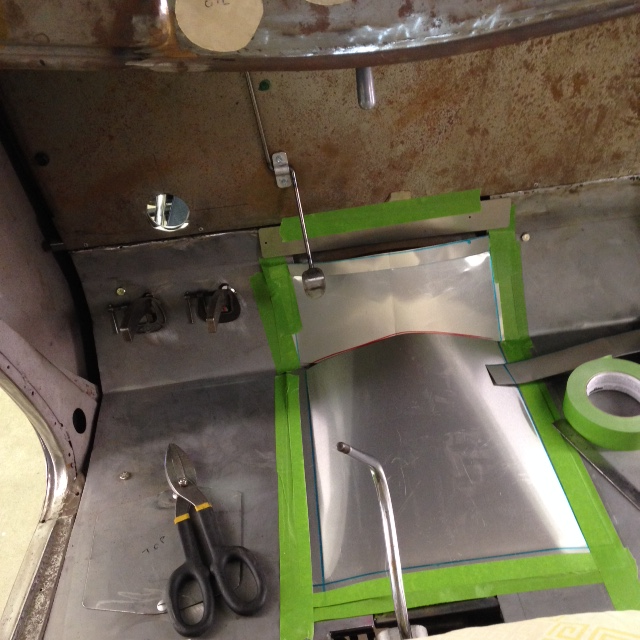

    So I moved unto the transmission tunnel. The good news is one of my son's works evenings in a sheet metal shop and is allowed to do side jobs after hours. The bad news is because of this I have accumulated almost no sheet metal tools at home. So I did a mock up using thin aluminum flashing. I spent an hour looking at pre-made trans tunnels but nothing looked like it would work.
    First I cut and bend
    Then install with tape
    Then trim and fit, trim and fit...... and some more trim and fit......
    Finally something close. The top piece is missing in this photo. I can now copy these out of sheet metal.
    It looks like I will not get anything to rest my foot on while it is on the gas pedal. Oh well!

  28. alchemy
    Joined: Sep 27, 2002
    Posts: 22,323
    alchemy
    Install a foot pad like Henry did in your coupe from the factory. You can screw it to the trans cover and adjust the height as well to fit your feet. Repros and fancy aluminum ones are available.
