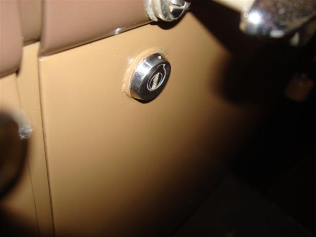

  8. John Stimac
    Joined: Jan 15, 2008
    Posts: 599
    John Stimac
    Here is a pic of the absolute correct lock. It belongs in the passenger door only. I've seen these for as much as 250 dollars, when you can find them. Good luck

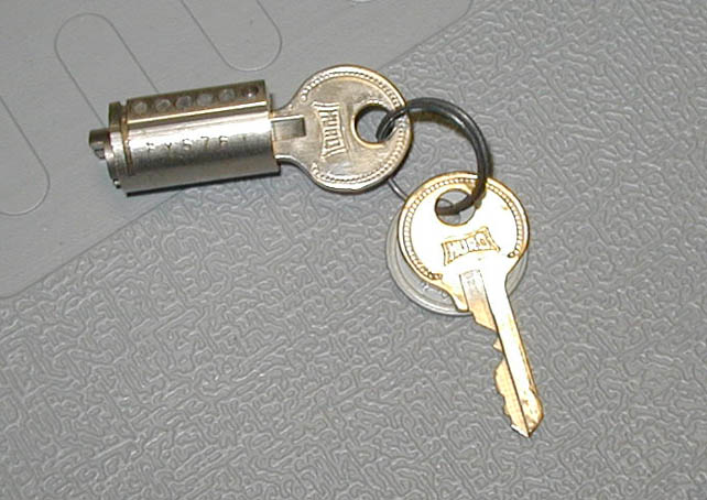

  10. Tic
    Joined: Jan 9, 2009
    Posts: 42
    Tic
    Just wanted to bring this thread back and post a couple more pictures of the '32 Ford two piece door lock. The first picture is of the lock case. It has a stainless face and the lock cylinder slides in and is secured by a retaining pin. The second picture is the lock cylinder. It is the same lock cylinder that is used in the Ford trunk handles from 1932-1937, skips '38 and is used in the '39 also. I have found that some of these two piece door locks were also used in the early 1933 Ford cars.
