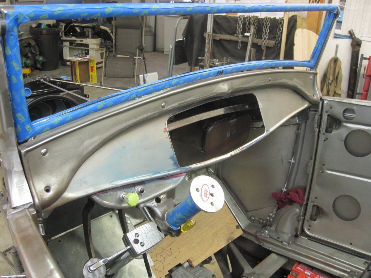

    I cut the tank out of my Model-A and used a 32 dash with a Kaiser instrument cluster and formed a sheet metal panel for the switches. Connecting rod for the column. Tom

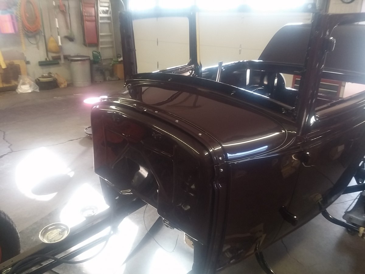

    Dash is strictly up to you but on my 31 Vic I am running a 32 style dash and running a tank in the back. I just flat like the looks of the 32 dash better and there are more options as far as gauge or instrument panels go.
