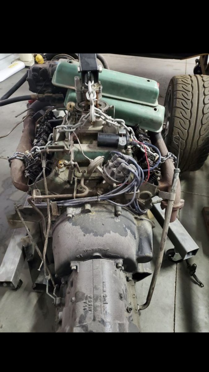

    Im thinking of picking up this eng/trans from a guy who does LS swaps....i have pictures(not close to me).he says it runs good,came from a older resto 1954 mercury that drove into shop..been sitting bout a year..is that a fuel injected carburetor?i dont remeber fuel injection on these motors...ur opinions please..on whats it worth...
  2. Will he let you pull the head to check to see if that really is a 312? It appears to have a crossover pipe in the front. That would mean a single exhaust. I would question it being a 312.
    town sedan and LOU WELLS like this.
  3. squirrel
    Joined: Sep 23, 2004
    Posts: 56,088
    squirrel

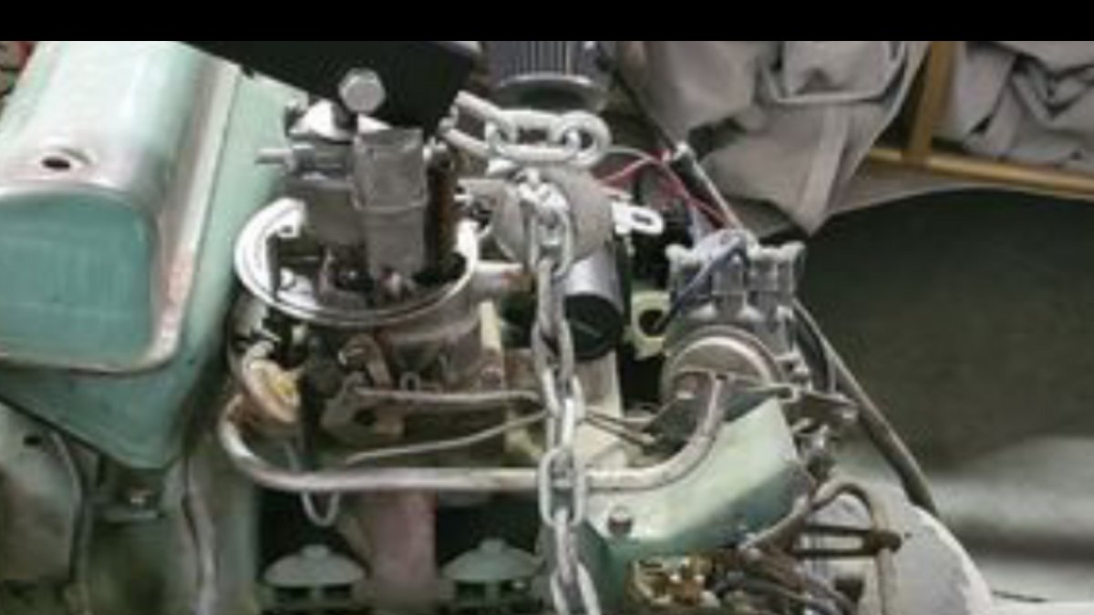

    it's a teapot carb, the float bowl is on top...some weird Holley thing that Ford used in the 50s.
    My guess is someone just decided to call it a 312, it's really a smaller engine.
    Should be worth a couple hundred bucks, if you really want it.

    Merc’s had a 256 which is probably what it is with the original Merc-0-Matic. The vacuum can on the dist look like a loadmatic too. Unless you had a specific use and the room it’s not worth much at least in the Y-Block world.

    The carburetor itself may be easily identified (at least if you have a set of "young eyes".
    Look at the edge of the carburetor mounting flange on either the front or back.
    Clean the edge until you see some text.
    If 1954 Mercury, it MIGHT read: EBY-9510-H List R-804A.
    In any event the information to the left of the word "List" is the FoMoCo identification number; and the number to the right of the word "List" is the Holley identification number.
    Once you have this information, there are identification charts.

    The 312 looks just like any other Y block, from what little I learned about them was that to tell what they are you need to check crank and mains, there were not any cast numbers that would identify the block from any other, and as Jim said that most likely is the teapot carb and the dist that goes with it.

    As others said, it looks like a 54 Merc to me. Stock Holley teapot carb, 54 colors, single exhaust, 256 cubes.
    Pull head and pan to examine crank and bore to be sure if you are really interested.

    Thanks for the input....seller will take $100.00..was gonna slap it in a 53 f100 driver...
  12. Yep , every 272 or 292 I look at is a "312";)
  13. Its probably worth that if if runs like he said. It doesn't have to be the biggest Yblock they made.
  14. $100 is worth it, he said it ran good, and it's complete.

    The 312 has a specific part number for the main caps. Don't remember it off hand, but that information is easy to come by. If the rear of the crankshaft were visible there might be a raised don't on the flange, but not all 312 cranks had the dot.
    So yes, every Y-Block is a 312 until proven otherwise. If it runs for $100 it's probably worth it. Just remember the LOM is a matched distributor and carb. If updating the carb then a 1957 up distributor will be needed.

    Bottom of the page is the "information center", almost every casting number you need. You can ID a 312 by the casting number on the main caps (it's pretty unlikely that has a 312 crank turned to 292 mains).
    http://www.ford-y-block.com/
    the 239/256 engines had major differences from the 272/292/312. Front cover, smaller water pump, different cam bearings, gear for distributor drive, tang instead of hex drive to the oil pump, and more. They can be difficult to get specific parts for although there are some work around. If it's a runner for $100.00 it's fine. But if it needs major work a more usable 272/292 core around here is a better starting point at $200.00.
    that load o matic distributor will only work with that carb.
