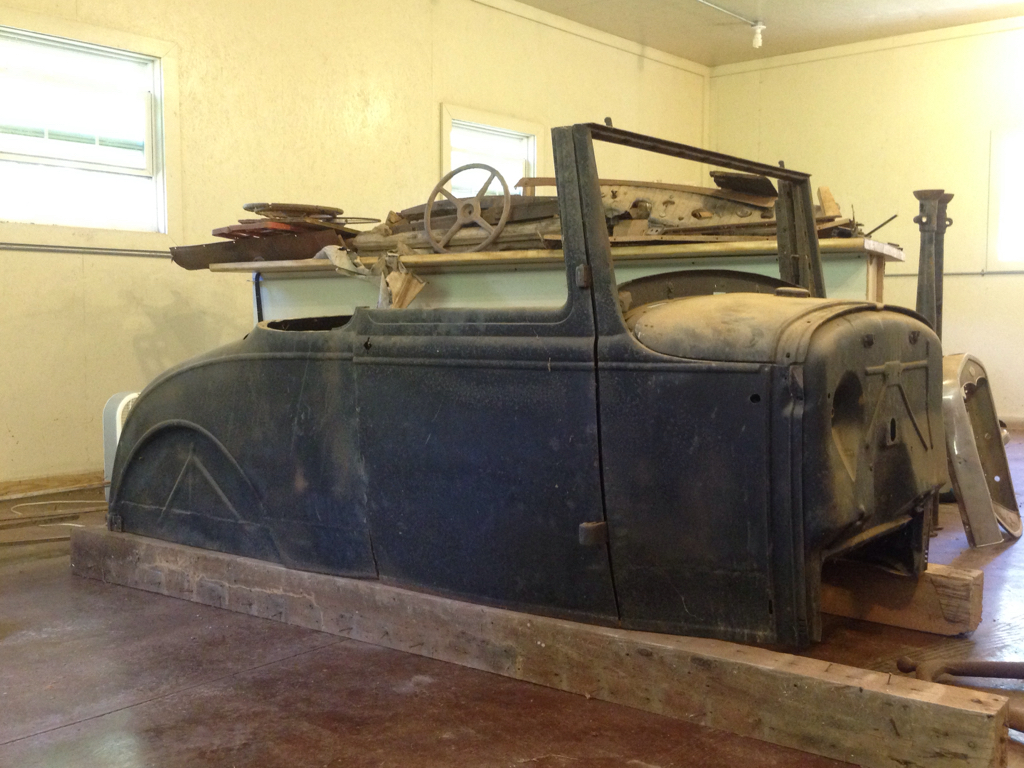

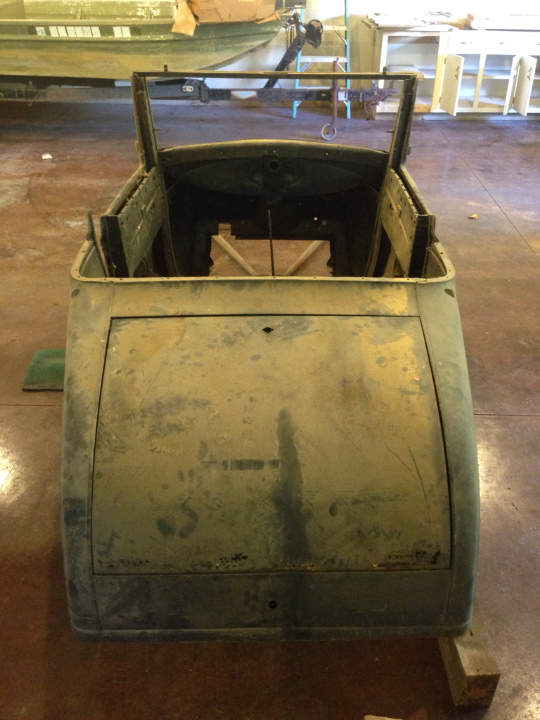

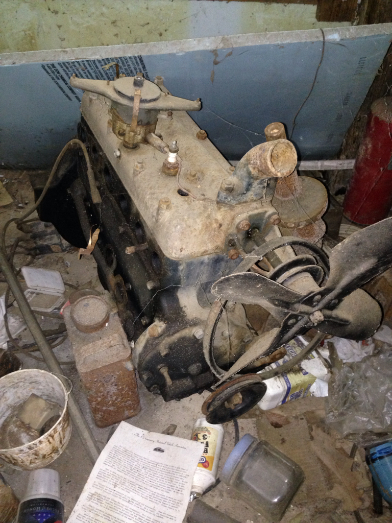

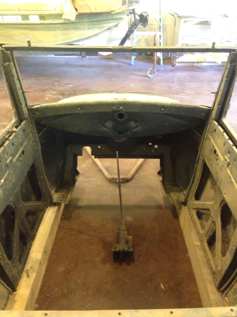

    I was out in my 29 Tudor one day and a guy comes over checking it out and mentions there's a "old car" in his mothers barn that belonged to his dad before he passed away and they needed to sell it, all he knew was it was a convertible and had a rumble seat, of course I perked up and made arrangements to come look at it because it's less than 10 miles from my house. When I got there we went around back to an old chicken house that can't be seen from the road and that's where it was, along with tons of other parts and junk. At one time this guy had around forty cars, I knew because this was the last one left it must have meant something to them, she said they drove it home in 1955 and he had tore it down and started restoring it before he got sick. I found most of the parts I would have wanted scattered here and there, except the hood and windshield frame. They wanted me to make an offer on it but I told them to just think about and let me know because I don't price someone's stuff, especially something that meant something to them. Of course they thought it was worth three times what I wanted to pay for it but they finally come down and we made the deal. From what I've gathered it's a pretty rare car, being a late 31 model. I know it's not a roadster but I've seen several nice Cabriolet hot rods built and I look forward to building it. I can't decide what direction to go with it, the original chassis is in great shape and I think the engine was rebuilt right before he quit working on it because it has good compression. So I could try to find some hop-up parts and go that route or an old six, flat head or later V8. Adams Hot Rod Shop is here in town, he builds some of the finest 32's in the country today and I could get them to build me a deuce chassis for it, I just don't know if I want to drop that much in it right now though. Any help or thoughts from you guys would be greatly appreciated, this is my first post on HAMB, glad I found this site! ImageUploadedByH.A.M.B.1440769974.915073.jpg ImageUploadedByH.A.M.B.1440770042.544095.jpg ImageUploadedByH.A.M.B.1440770080.444550.jpg ImageUploadedByH.A.M.B.1440770184.310511.jpg ImageUploadedByH.A.M.B.1440770230.926224.jpg ImageUploadedByH.A.M.B.1440770260.879980.jpg

  2. Wow, that's in great shape.
    Welcome to the Hamb.
    I'd throw it together for fun, and maybe drive it a little, till I figured out how I'd like to hot rod it, if I was you, but since I'm not you, I'd drop a SCoT blown Ardun in it give it a wild chop, some nice chrome reversed rims with big n littles........:D

  3. Yummy!!!!
    Slant Window Cabs rule. That is a pretty rare Model A, like Vicky, A-400, Deluxe Phaeton rare. Unless your totally in love with it I would sell that body to a Restorer. It's worth a really shiny penny. Then you could buy a roadster or ?

    The subrails on these were all wood. You need to look at what the kits costs to replace before making a lot of decisions. Make sure you are sittng down when you are looking...they are not cheap.

    Is there something special about them? I did a quick search for grins and you can buy subrails for about $340.

    And I'll check all the numbers, there's one complete engine and a couple spare blocks and parts laying around too.

    Seriously, that is a great find, looks to be in very good shape. For all the guys that just have to have a roadster, I'd prefer a cabriolet over a roadster any day of the week. K6

    It is a 68C designation given by Ford. It also has an indented firewall and that likely puts production after April of 1931 . Query on Model A Ford 68C and you will get more hits. There had been fires in the passenger compartment from leaky fuel shut off valves and the shut off valve got moved to the other side of the firewall. There is discussion with not much agreement in regard to the production numbers of the '31 Slant Windshield Cabriolet but it is less than 3500 is a number that I hear pretty consistently. If you take the accepted 10% survivor rate well that is 350 or so out there still.
    Score the windshield frame if you haven't already. A repop is way south of $1000.
    Get the frame too and hopefully it matches the engine number. This all adds value
    All the top parts including the landau arms are like hens teeth and because of the low numbers they are not reproduced though some for the parts on the Cabby are the same as on the Sport Coupe.

    I'll be interested to see what you do because I believe that if you were just to re-assemble what you have and make it run and drive, you would be hard to part with it I suspect. After all you already have the transmission in it....
