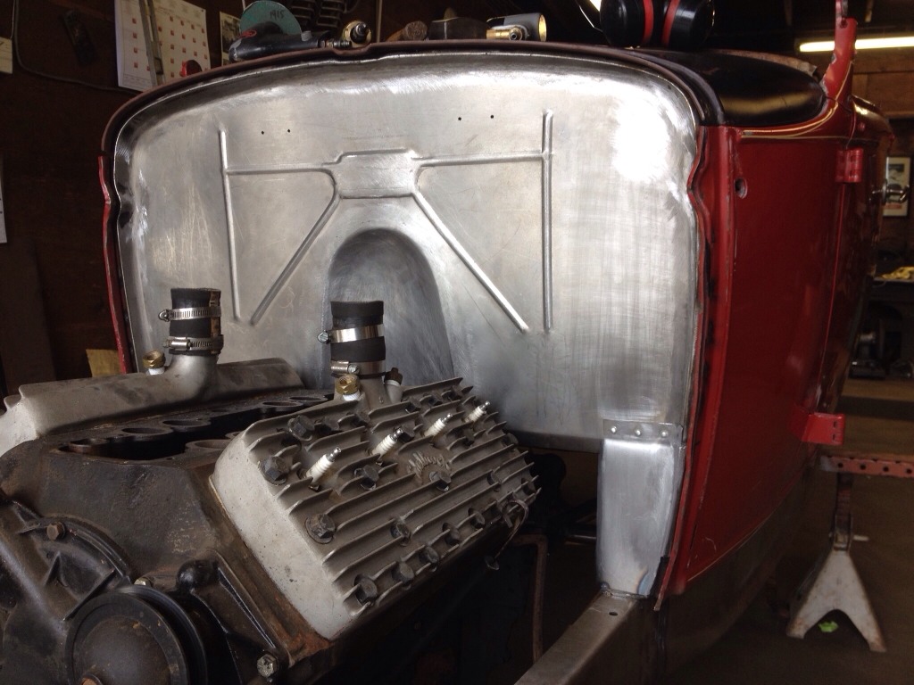

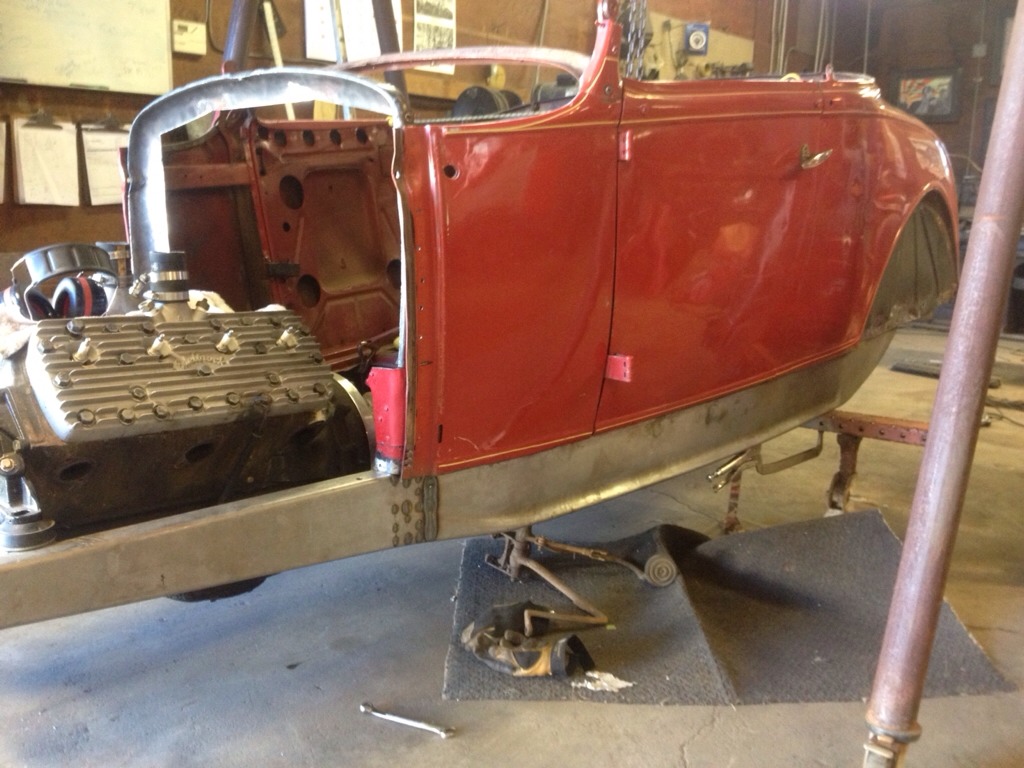

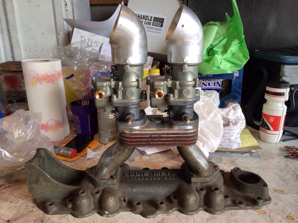

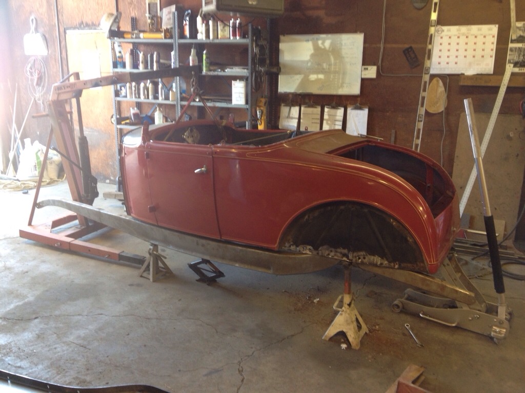

  16. sluggo1936
    Joined: Feb 28, 2012
    Posts: 46
    sluggo1936
    from Colorado
    ImageUploadedByH.A.M.B.1392753231.284883.jpg ImageUploadedByH.A.M.B.1392753254.936677.jpg ImageUploadedByH.A.M.B.1392753280.697490.jpg ImageUploadedByH.A.M.B.1392753307.667094.jpg ImageUploadedByH.A.M.B.1392753332.305744.jpg
