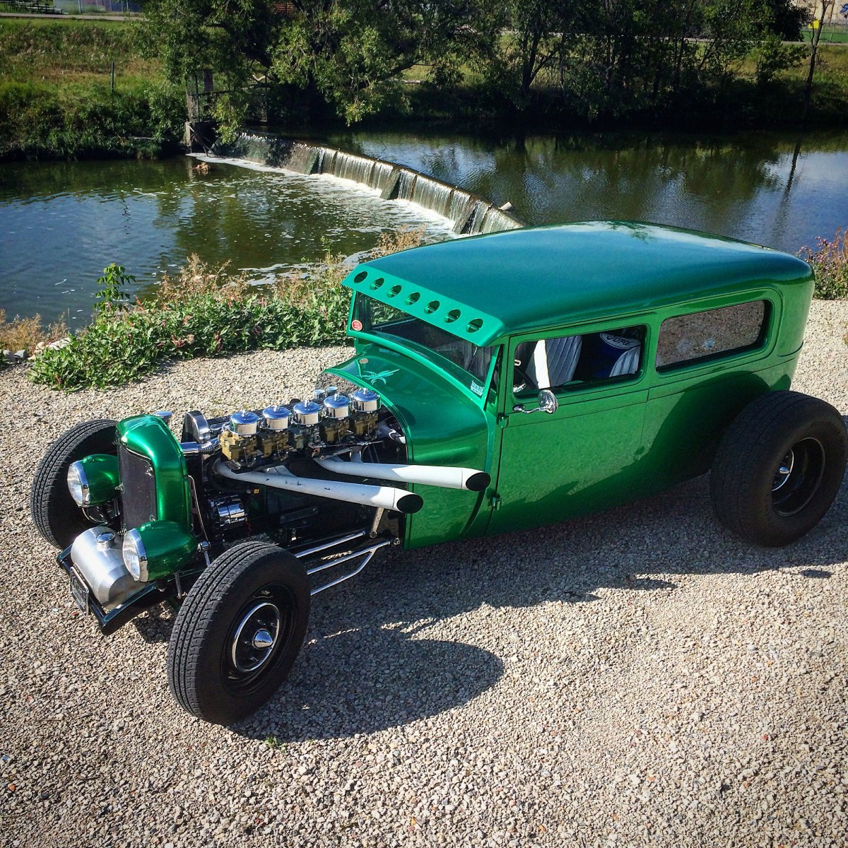

    Use the Gimmy 302 and find a Wayne 12 port head, side drafts on one side and a cool header on the other and you will be styling
    DND
  8. Yea stylin' at the homeless shelter. :D Man those 12 port heads are high priced pieces. But a Gimmy with one it tits and that's a fact.

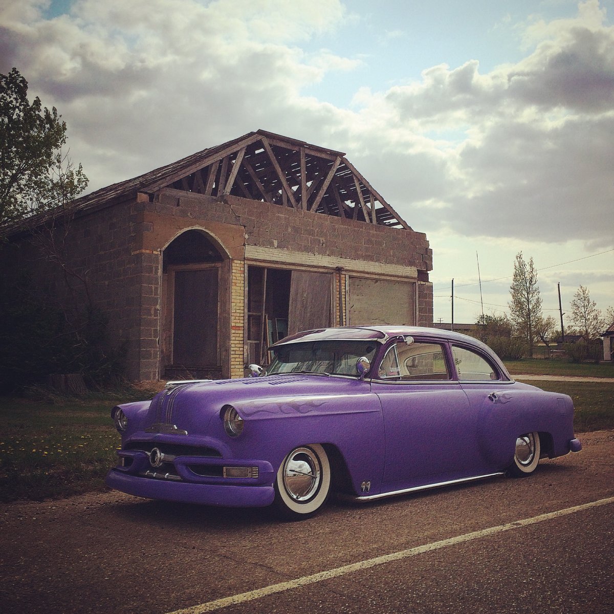

    I vote OHC as im a fanatic. I've ran a 67 pontiac Sprint OHC 230 in my 53 pontiac since 1994 and still strong. Keeps up with everyone just fine. I went more radical in my latest car but still OHC pontiac backed with 5 spd this time and it's a blast. It's a 66 230 in the model A. Woodland motor sports sells everything including belts for these. Nothing is that difficult to get and they work great.
