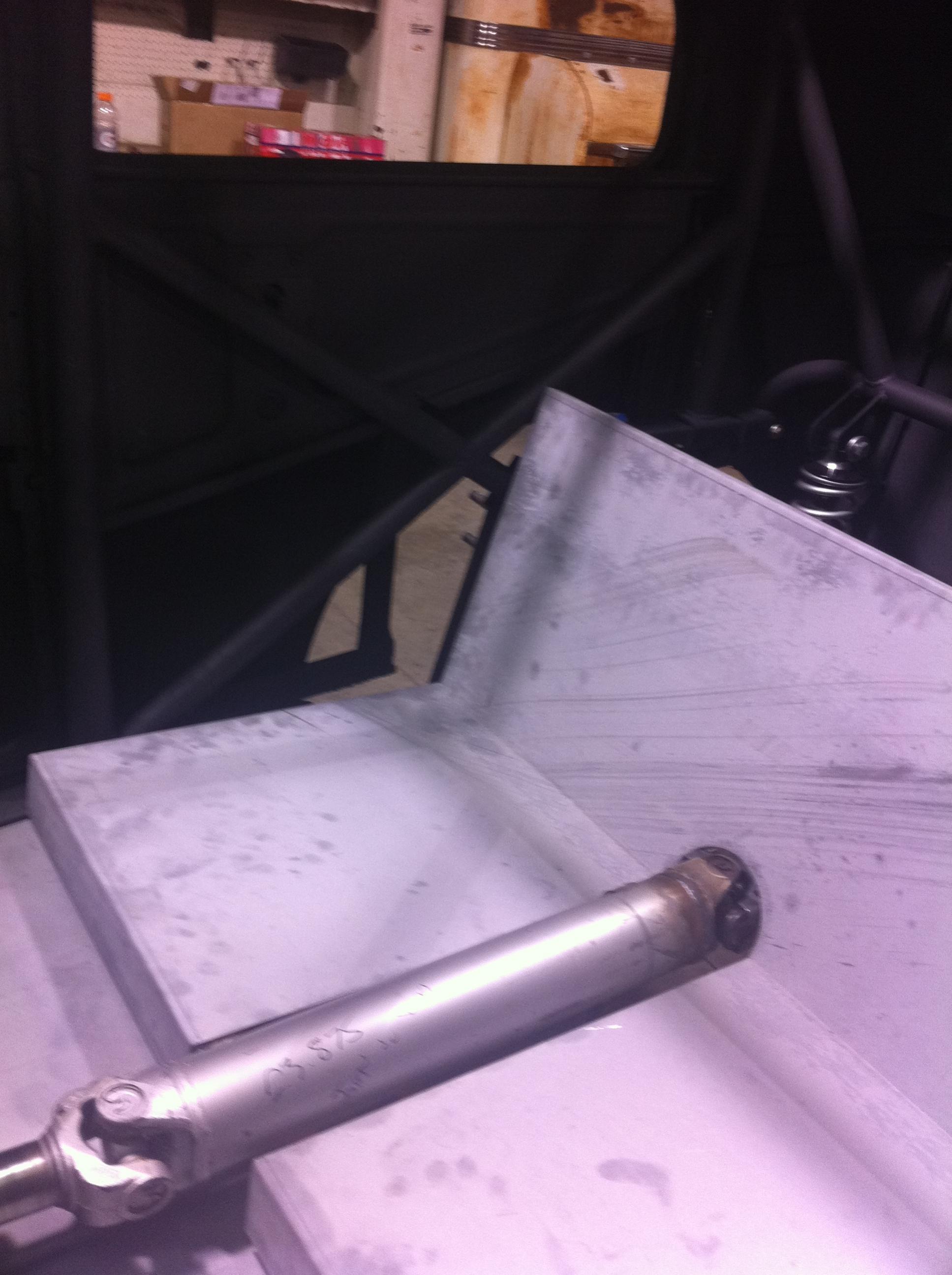

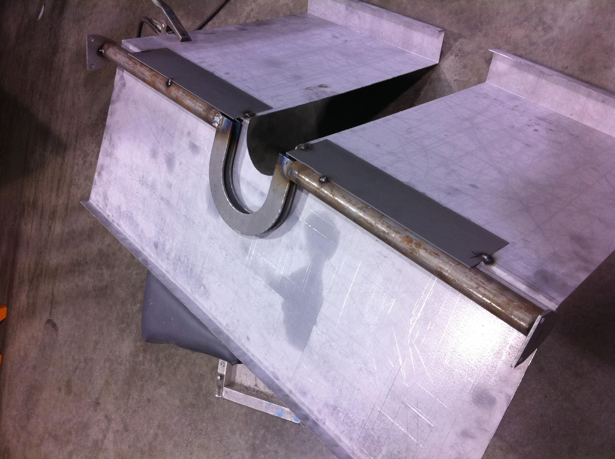

    Floors getting mocked in. Relax, fellas, the rear section is resting on the driveshaft. It will have plenty of clearance when done. As soon as the floors are in, I'll build some bomber seats that will fit my fat ass. It'll be a tight squeeze, but I'll find a way to get in it. I let a kid drive my sprint car, but this one is for me to flog. Once I am fitted in the car, I can mock up the cowl steering/master cylinder/pedal bracket and start wiring and plumbing. I'd like to test by the second week of July. We'll see.

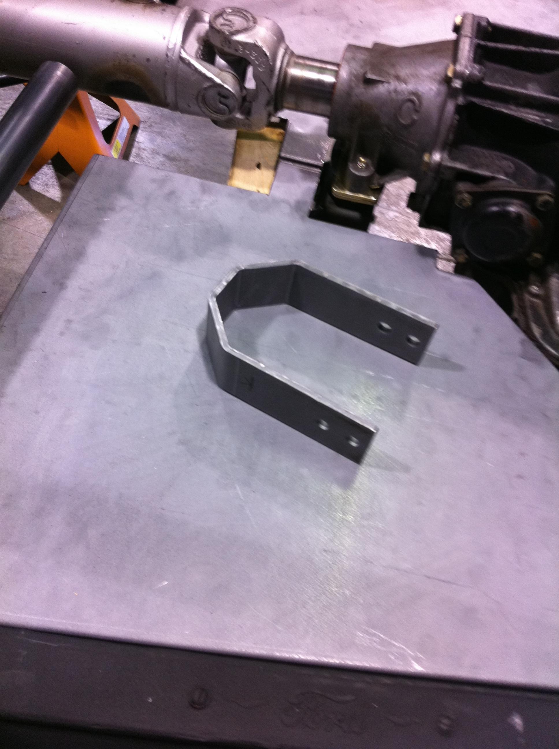

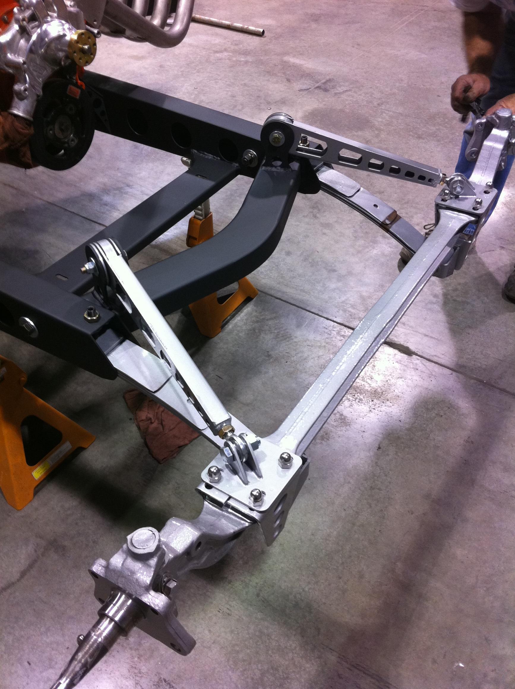

    The front end has been blasted and POR 15 silver has been shot with clear over it. The radiator is mounted and the grill shell is being mounted. The floors are being fabbed and supported. Really trying hard to get this heap ready for Salina.

    Getting the floor support tubes welded in. These also serve as attachment points for the safety harness. The driveshaft hoop worked out nice. Once the floors are welded in, I can build some aluminum bomber seats and mock in the steering and pedals. Getting a lot done in a few hours.
