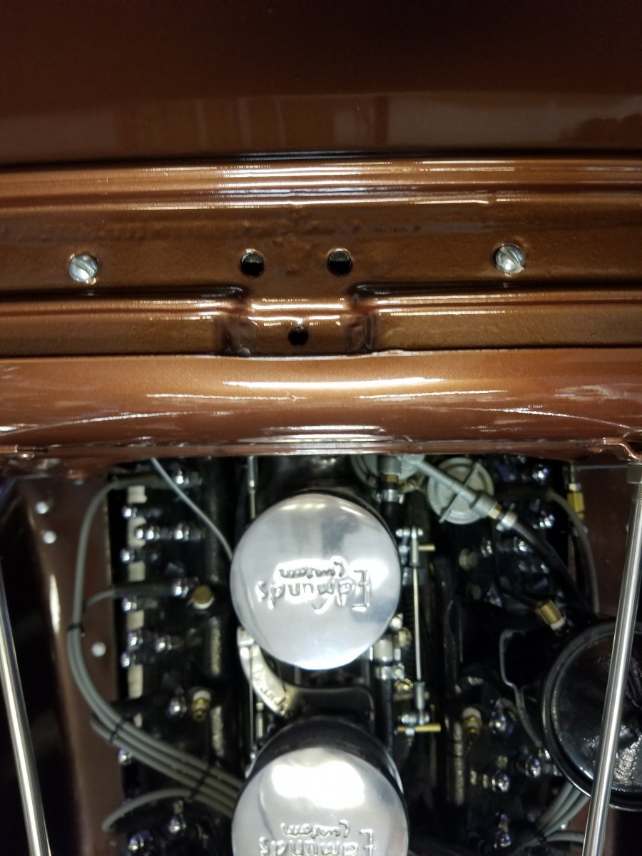

    I have collected what I think are all the parts required to fit a hood to the '30 but I have a question about the cowl lacing... I have done a search but havent really found the answer I am looking for.
    At the top of the cowl there are 3 holes.
    The single hole in the welt channel is not threaded, the two behind the welt channel are threaded.
    The welting kit I have (no internal wire) comes with 3 screws with the same thread pitch as the two threaded holes (and the two holes on the side of the cowl)
    My question is, am I missing a small bracket (like what is on the 32s) or am I missing a nut under the cowl top to secure the welting by through bolting it?
    Anyone have a picture of what that area looks like with welting properly installed?
    Hope that makes sense and thanks for the help.
    Chappy

    The welting goes in the forward groove, the one with the single hole. The rear two holes are for the hood hinge bracket.

  3. Thanks @alchemy
    So I am missing the hood hinge bracket...
    Do you know it that forward hole is supposed to have threads or a captive nut or something? Mine does not... I can get at it from underneath to add a nut... disent look like it will be easy though.
    Thanks again

    The welting is thru bolted.
  5. @Mr T body
    Thanks for the pic...
    Now I know what holds the center of the cowl band down...lol
    I guess I will have to figure a way to get my hand up behind the gas tank and get a nut on the hold down bolt.
