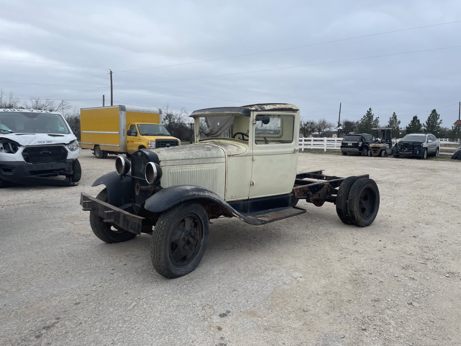

    Hey guys! Jumping in the deep end once again. I just committed to buying this AA. I'm going to pick it up on Sunday with @RMONTY.
    The seller is a lady selling it on behalf of her widowed mother in law so nobody knows anything about the truck at all. It may or may not run but the body tin and chassis look SUPER nice compared to what I'm used to, and I've been wanting a classic 1 ton so bad I can't stand it.
    Current plan is to see if it will run. If it will run, it'll get a cosmetic fresh-up, I'll build a flatbed for it and drive it like it is. If it won't run it'll probably get a later motor. I'm guessing the process to put a flathead V8 in one of these is about the same as for any other A? Has anyone done that?
    I guess I should post this thing up over on Fordbarn too, maybe I'll wait til I have it in hand and can really assess it.

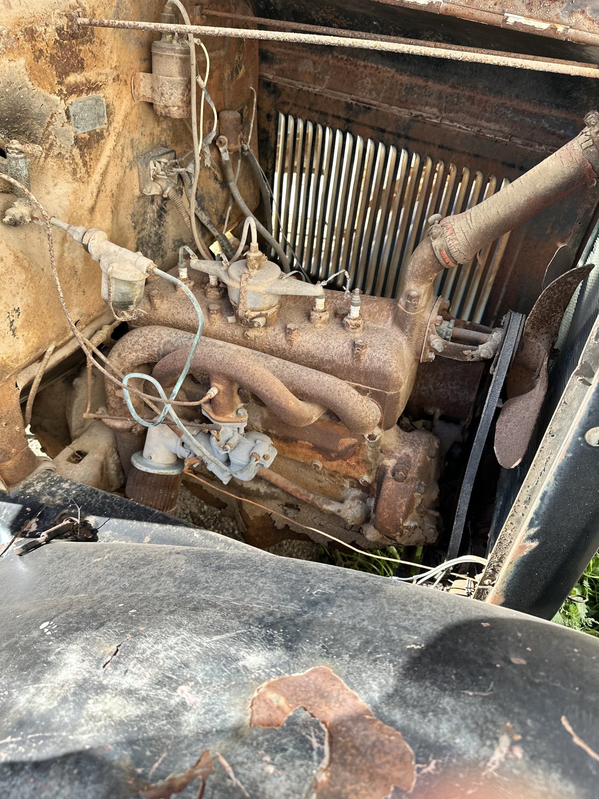

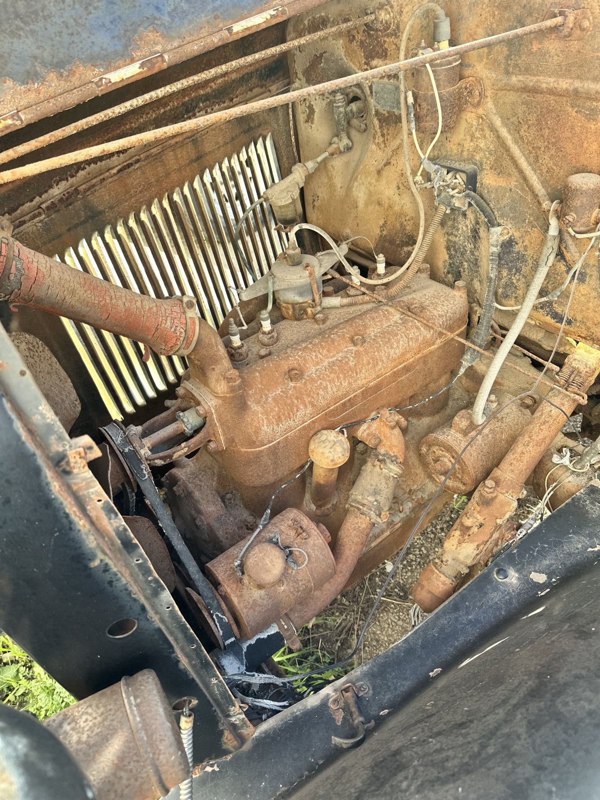

    I got her to send me some pictures under the hood. Looks like a late 31 and I bet she will run for me with a little work. I called the shop and spoke with the guy there and he said it's not locked up and does roll.
    72659644598__294441C8-0CA6-433D-9DEC-BF6A0690904F.jpeg 72659648477__C0640E19-8C35-4EDE-A4E6-C337FE42807A.jpeg
    Can’t wait to get it home!

  3. Good for you!!! I love AA's, just no place to keep one. If you want to drop a flathead in, the only real difference that I am aware of, is everything is just beefier than an A frame. If you want any speed out of her then you may want to contact Mitchell OD and see if they can build you an OD for her.

  5. By looking at the bed pic I don't see a Warford there-could be wrong and just am missing it though. There is an AA Ford forum that you might want to join up with along with the Ford Barn.
    I don't know how familiar you are with Model A/AA's but as far as the engine goes, if it is worn out you may want to keep it and add some speed equipment. Outside of a wagon (I think), my sedan is the heaviest car out there and I can go 50 all day long with some minor mods. Do you know what diff you have? It should be either 5 or 7:1, the 5:1 is the 'high speed' and will eventually get to 45, the 7:1 will get to about 35 and screaming. Also just remember you have to be able to stop from 50. But if all you are doing is back road around town you will be fine.

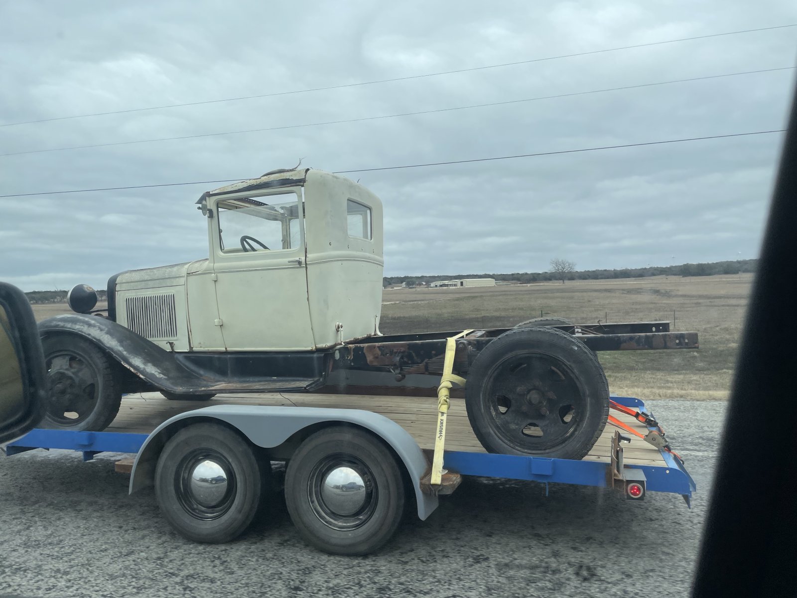

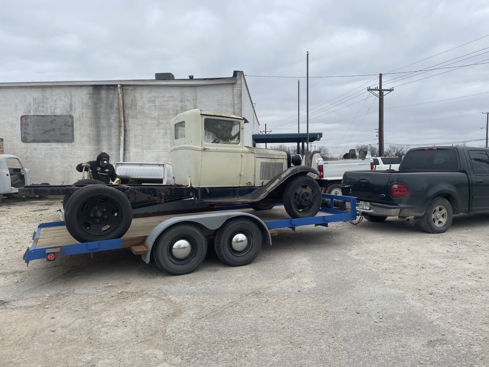

  13. trevorsworth
    Joined: Aug 3, 2020
    Posts: 1,453
    trevorsworth
    She’s coming home! I’m really happy with the condition of the truck. It really only has one rust spot on the body at the bottom of the cab back. It will need to be completely re-wooded but that is OK. The doors are in great shape, gas tank is good. The radiator is toast, that’s OK. All the cool commercial stuff is there. I think it was a wrecker.
    Rolls, stops and steers just fine. Shifts stiffly and the engine moved a little bit. I think it’s gonna be a runner…
