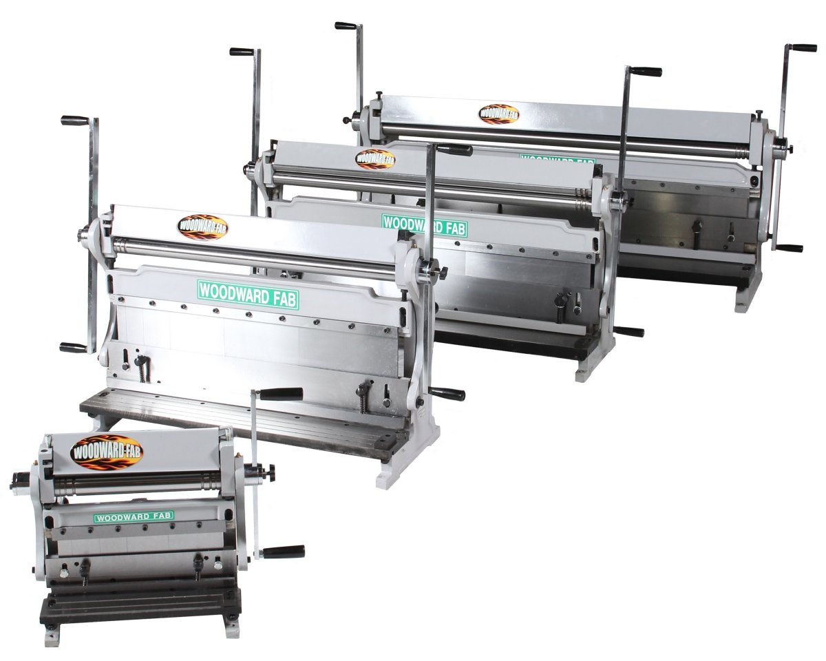

    I have been searching for a long time for some decent used USA sheet metal equipment, but there just dosen't seem to be much available around here. I'm just a hobbyist, not a pro, and the need to do sheet metal fab is infrequent. But my time in the shop working on my car projects is precious, I don't like to waste my time fixing junk equipment, converting garbage china tools into something usable, etc. Ready to work out of the box is my preference. At Back to the 50's, I tried out Woodward fabs 3 in 1 press brake, shear, slip roll machine. I think something like that might suit my needs. I found this machine at Grizzly, it is supposed to be built to a higher standard that the typical china machine. http://www.grizzly.com/products/42-3-in-1-Sheet-Metal-Machine/T26751Z
    Does anyone have any feedback on 3 in one machines in general, and any specific brand recommendations? THanks,

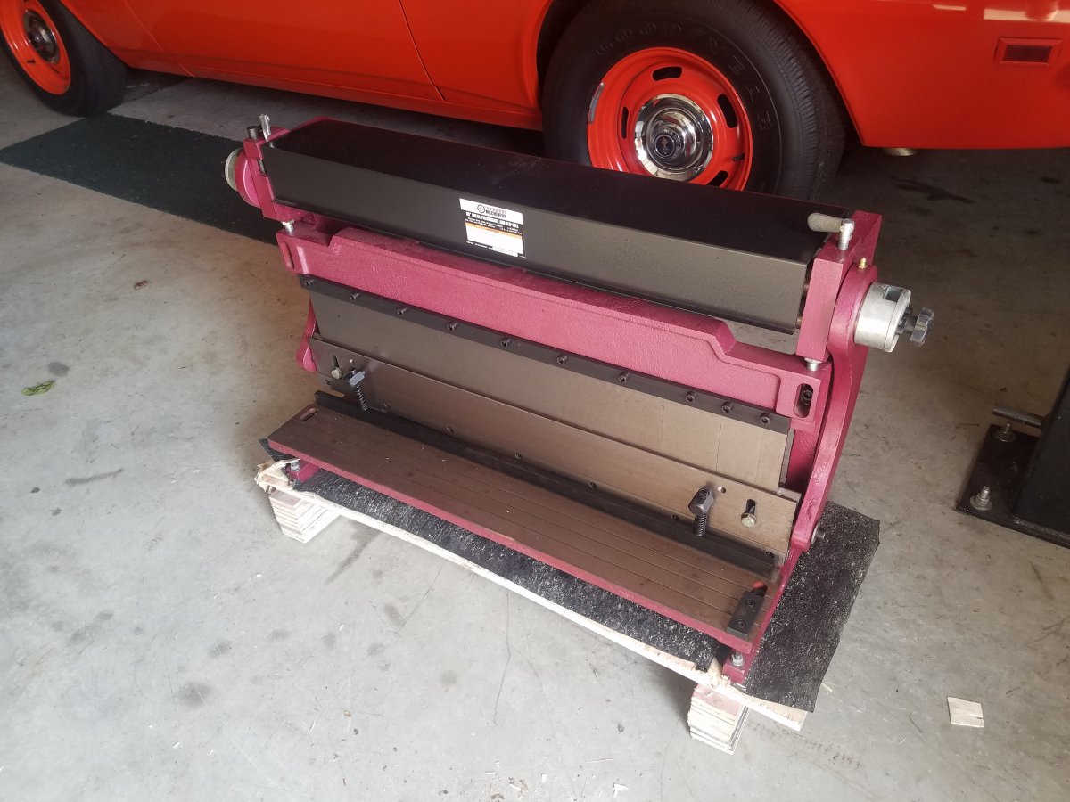

    I've been working with the 30" combo from Harbor Freight.
    You can't abuse it but so far I'm pleased for a $320 investment.
    Just realize it's limits.
    Had to make a stand for it.
    dana barlow, fauj and Rich S. like this.

    So all 3 functions work fair? Cuts nice? Thanks

  11. I've got a HF press brake/shear like shown above, and one of the arms broke trying to cut something too thick. Made new ones out of 1/2" thick bar stock, no issues since. If you're cutting steel, 18 gauge is about it for long cuts. It will cut thicker material in shorter lengths, but struggles if you go above about 6". I have found that clamping the material to the table when cutting does help.
    A box/pan brake has more utility value and I'd have one if I had anyplace to put it, but if you are willing to fab some bits you can do a lot with a 3-in-1...

    I just don't try anything heavy and it's done well.
    Usually fab flat floor panels and patch panels with it.
    It does what I need and doesn't take up a lot of room.

    Anyone have any luck with the woodward fab units?
    Or are they pretty much like HF brands?

    Just a different paint job.
