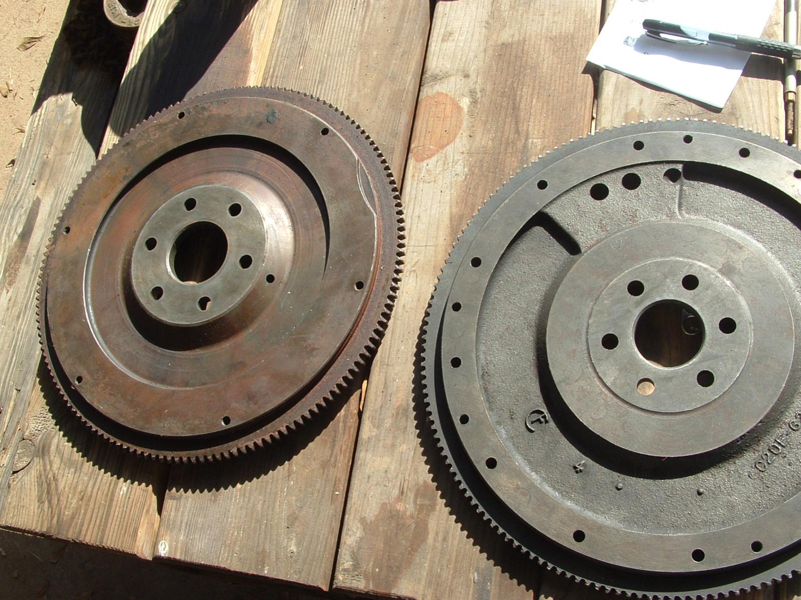

    Mctim64 has been a big help so far, heres a few spec's I've come up with and a few pic's of the difference between what I think is a 223 wheel as opposed to a know for a damn fact 260 'wheel thats out of my 4 speed falcon.
    Crank flange measures 2.125
    Flywheel ID for yblock? 1.925
    It is drilled for a 10 1/2" PP
    I have a 260-289 'wheel that the id is 1.730 on it and the bolt spacing is all wrong for the yblock crank.
    I have a thread going on this I'm going to add a couple pic's to as I can't figure it out here. Thanks again for all the help man!
    In the pic's the 223-yblock 'wheel is on the left with the stepped up face on the back, the other is the 260-289 with no step up and a ID bore of 1.730

  5. I'm trying to figure it out but the Y-Block and the six of that family (215-223-262) all have the same bolt patern and center. 2 1/8" 260-289-302-351w and the 351-400m are 1 3/4" along with the 240-300 six and the 144-170-200-250 sixs. Those V8s are externally balanced and will have a weight on them as in your picture. The Lincoln Y and the FEs are 2 1/2". So I'm not sure what you have there with a 1.925" hole. Maybe someone else can help. I too have many flywheels, I'd send you one for shipping.
