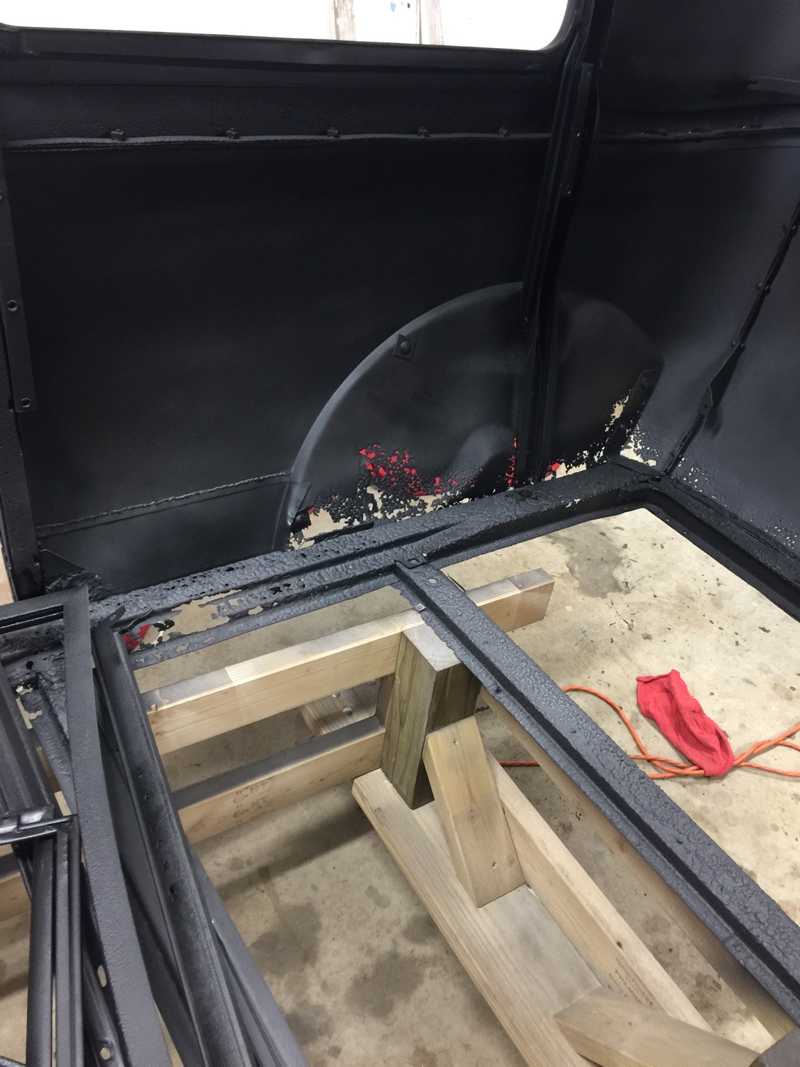

    Okay, Finally got the car back from the sandblaster. I need to get some better pictures but it looked like it was going to rain so I rushed to off load.
    I need to figure out what my next step is. I ordered a frame last week. This frame actually isn't a double z. It has a 12" kick up in the rear and a swept front end along with a 5" magnum drop axle.
    I know I need to start patching. Looking like right lower outside door patch, both inner fenders, lower rear panel, both rear corners and then in need to figure out the sub-rails or make a new subfloor since it's being channeled 4". Basically the lower 6". Of the whole car!
    I know I won't finish the roof until the body is square in the frame but I'm torn between going full metal top, Traditional top, or the snap top that rolls back.
    Kris

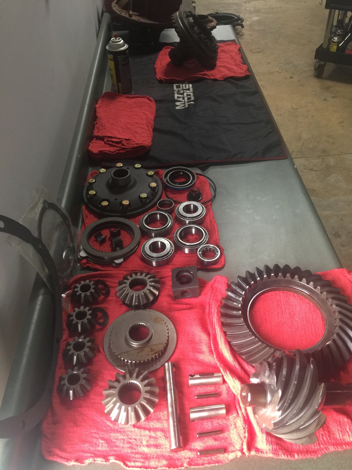

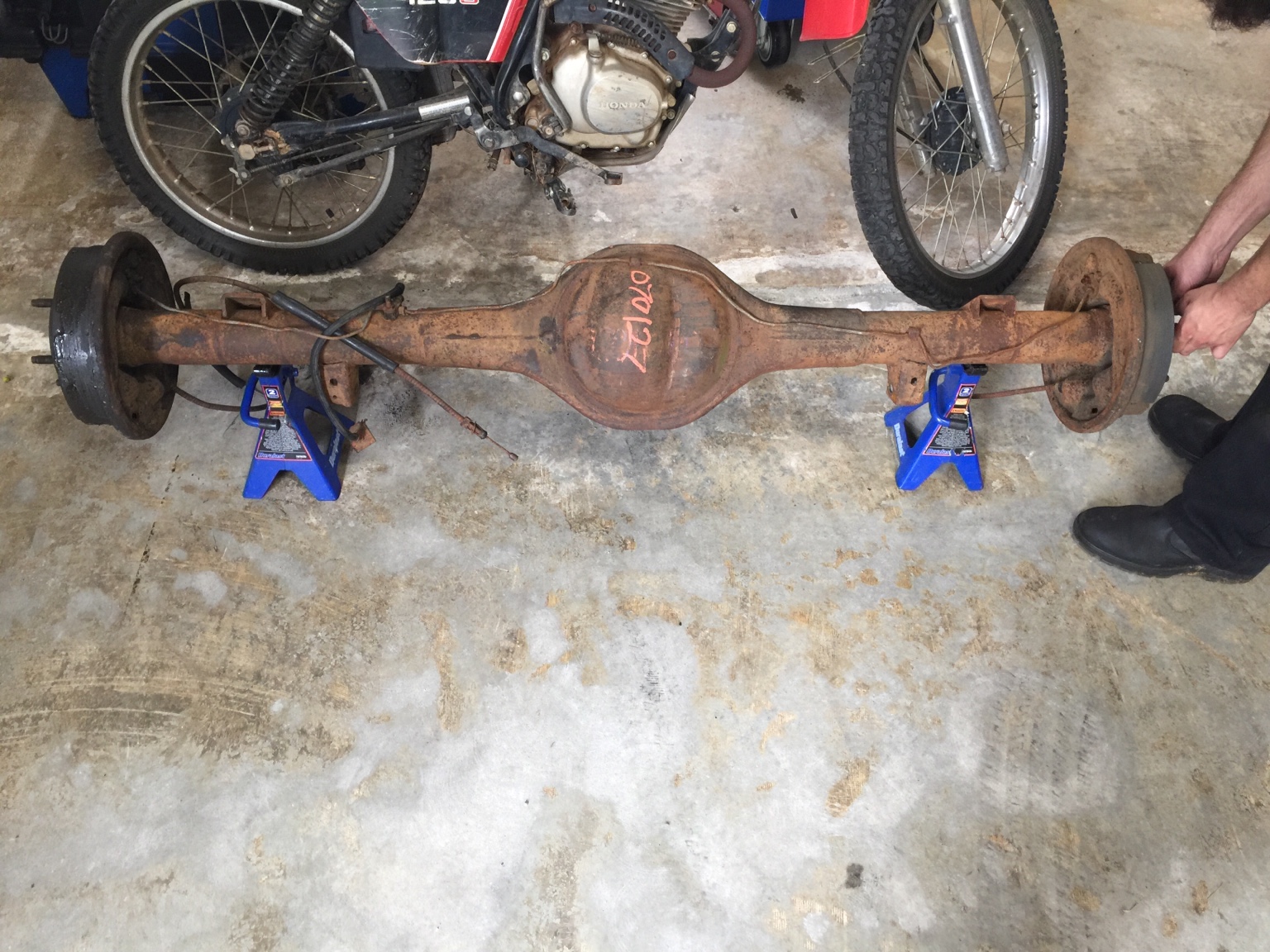

    My space is kinda limited and my frame should be here next week so I am going to focus on getting the chassis rolling. I found a ford 9" out of a bronco with trac loc that I think is the correct width based on 1940 16" wheels. The frame has a 12" kick up in the rear and I think the 65" width will be perfect since it will sit so low. Fortunately, the complete assemble was super cheap. Bad news is it needs a total rebuild!!! I ordered all the rear end parts that I need to make it new again. I'm really struggling to find the right wheels though. I need 16x 5.5 wide in a 5x5.5 bolt pattern with White walled 750x16 for the rear and 16x4.5 wide with 600x16 tires for the front. I have yet to purchase front disc brakes yet so that bolt pattern is flexible. I am having a really hard time finding the wheels new. I don't really want pitted rusty originals. Any pointers on the right wheel and tire combo would be much appreciated. As I will need those very soon. For the front suspension I will be running Pete and jakes front hairpins along with a magnum 5" Drop axle which I will be ordering as soon and I pick wheels and tires!!! The wheels have been causing me lots of heartache hahaha
    Kris
