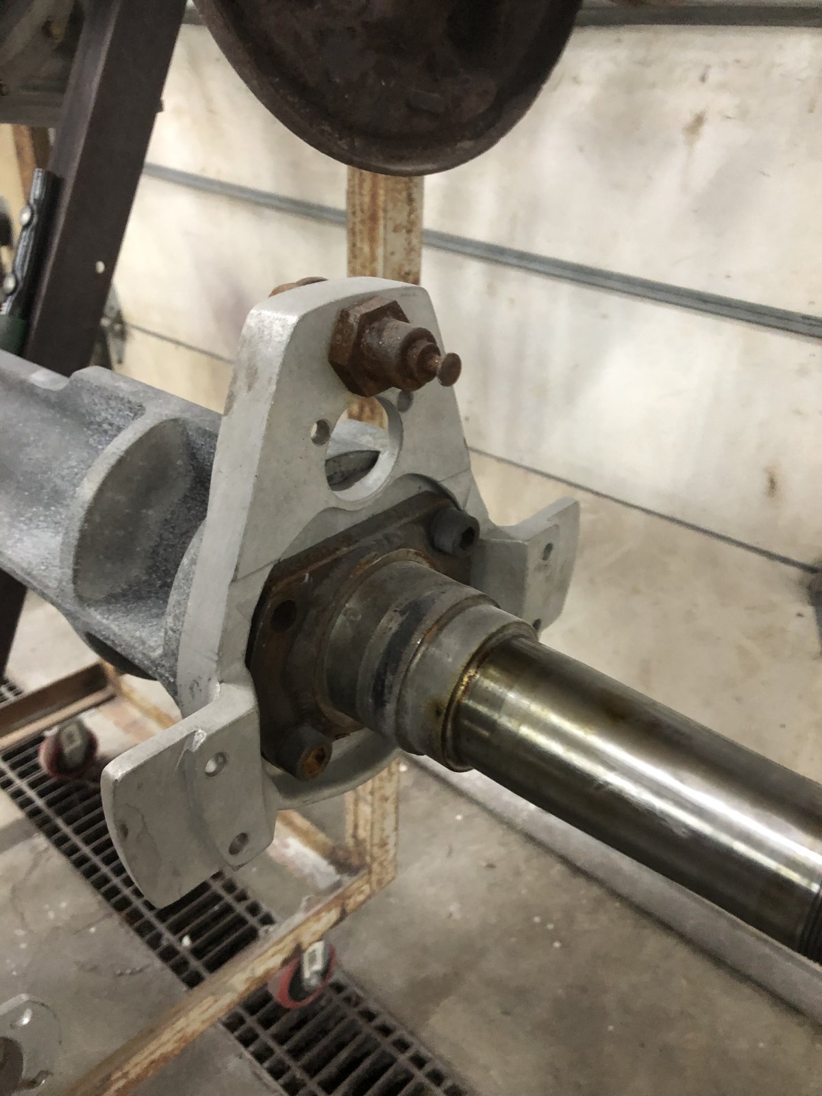

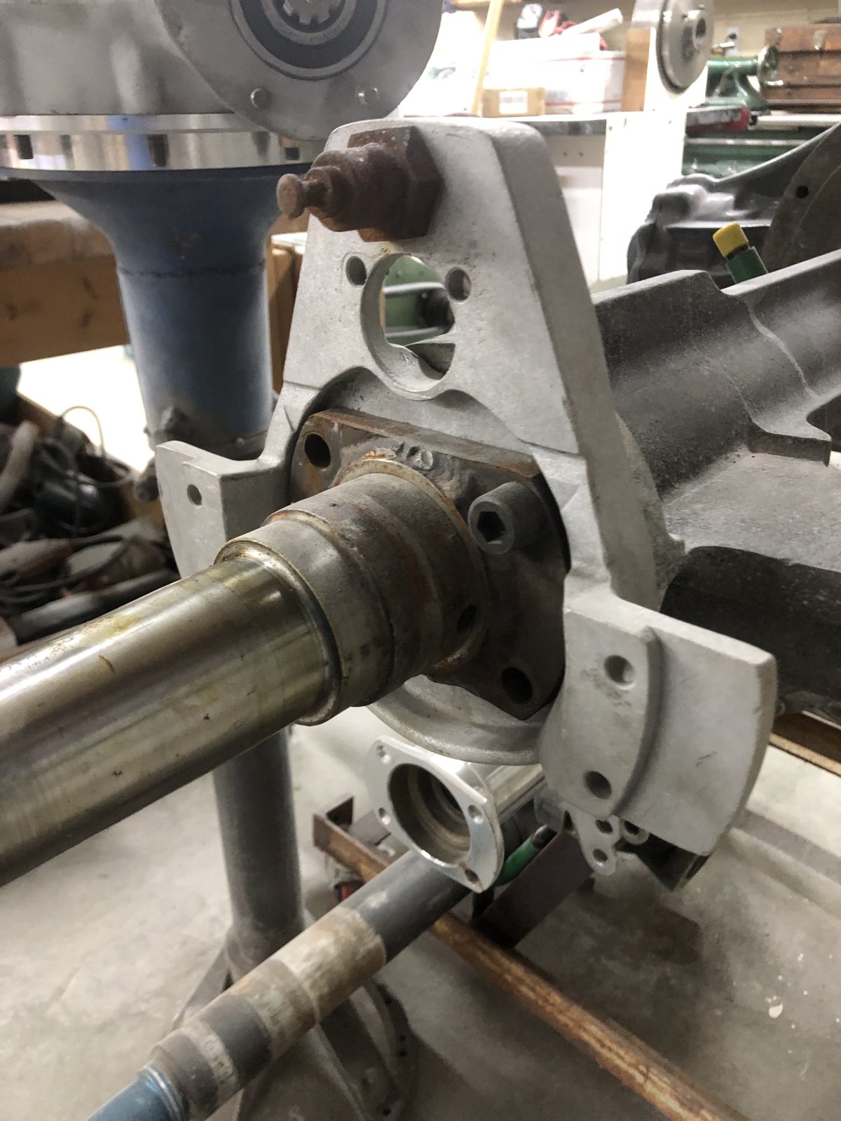

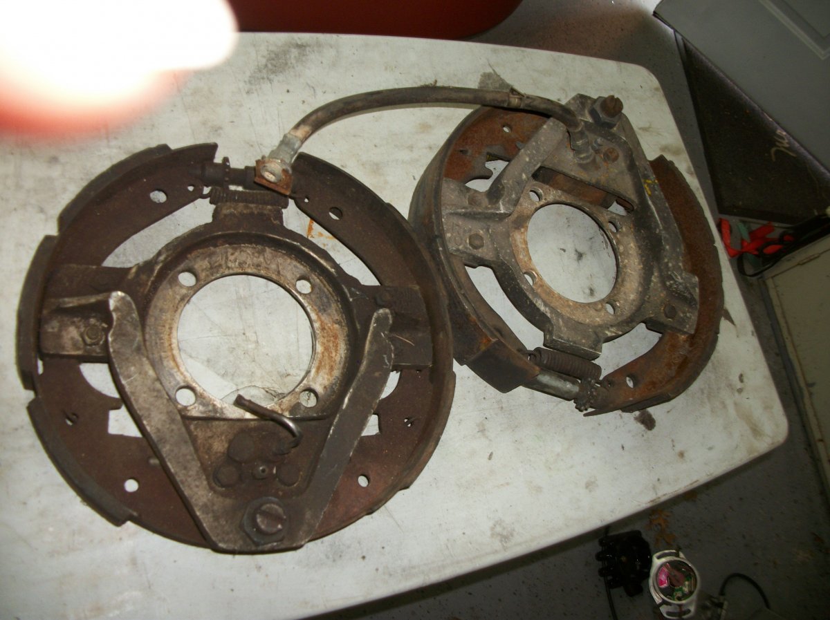

    Do these look familiar?
    I thought they might be Frankland but it doesn't say that on them. They are not welded, appear to be forged.?
    The guy I got them from thought they used Pontiac Brakes.
    bchctybob and Hotrodmyk like this.

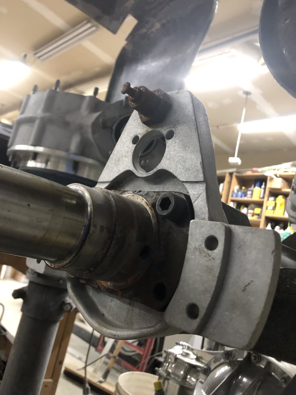

    Jeff, what is the Bolt spread on those plates? Looks like early Ford.
    porkshop likes this.

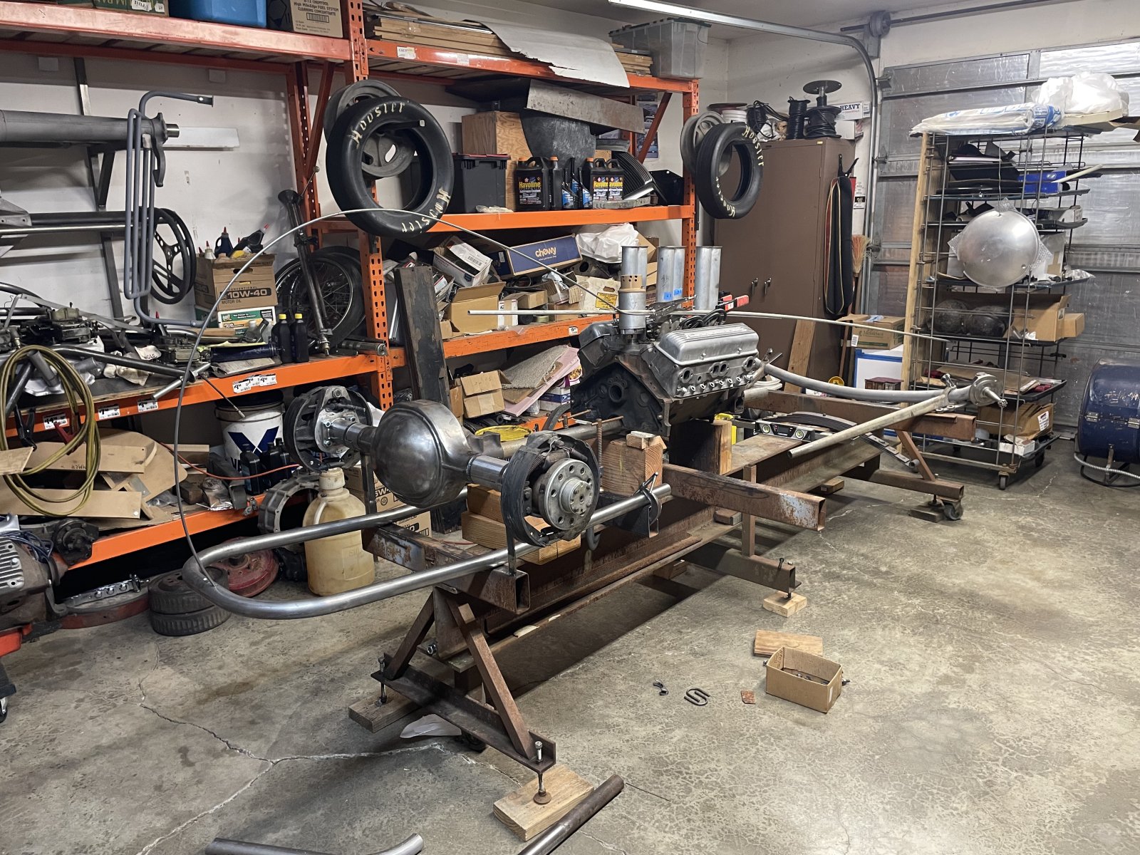

    After showing the Chrysler rear axle being put together, now to show what it is going into.
    I have had this car in the back of my mind for several years. Now is the time to see if I can build it, to look similar to the Hank Vincent/ George Santos, "Top Banana" Fueler from 1958-60, and pass tech with a Cert for 7.50. The problem might be keeping the roll cage small enough, to maintain the swoopy rear section of the body. With a Hans Device becoming mandatory on cars faster than 150, will also complicate things. I am building the chassis, and my good friend Chris Kopp with be performing his magic on the body. Top Banana 2.jpg Top Banana R&C Oct. 58.jpg Banana tall injector tubes..jpg IMG_4391.jpg IMG_4393.jpg IMG_4394.jpg IMG_4396.jpg

    Marty...
    You got stones! I don't think I could release the trans brake with my boys and chap resting up against that diff.

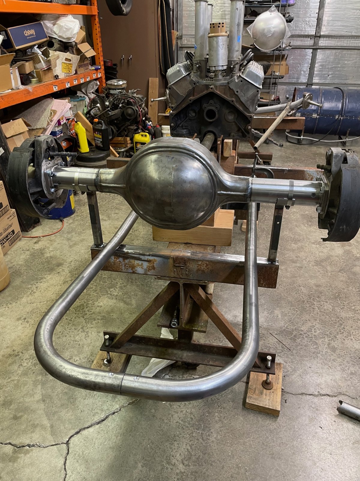

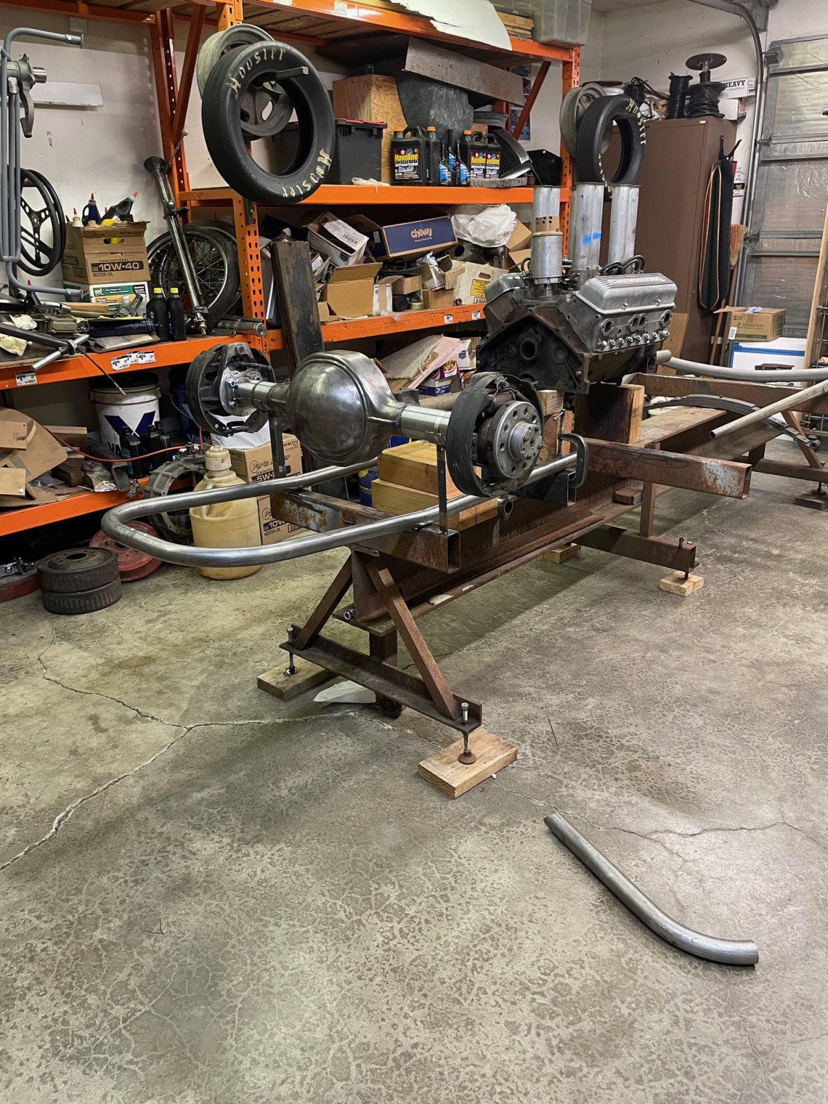

    I think I have turned to corner and am back on this project. Today I started with some tube with surface rust. So, I cut a couple pieces of the 1-5/8" .125 wall tube, and spun it in my lathe, using some emery cloth, and maroon Scotchbright, and proceeded to make some bends. Starting in the tail section, this will be the building block for the rest of the chassis, and dictate the height off the pavement. Tomorrow, I will clean and bend the shoulder hoop. IMG_4335.jpg IMG_4445.jpg IMG_4446.jpg IMG_4447.jpg IMG_4448.jpg IMG_4449.jpg IMG_4450.jpg
