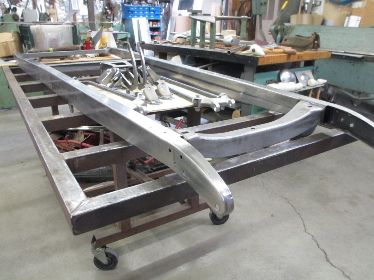

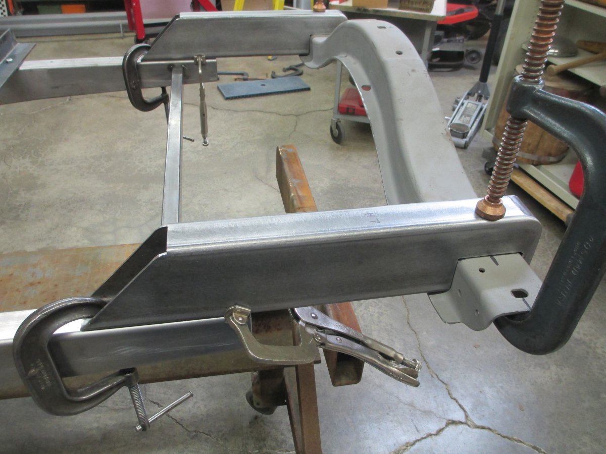

    Thanks for the great replies ! I started this project by purchasing a perimeter frame from Classic Street Rod Mfg, Ontario,Ca. By my request, they left the rear C/M off and tack welded some braces to keep it square, during transport to Portland. Yesterday, I fabbed up the frame tails and got the original Model A- C/M mocked up to set the spring center bolt, 7.5" to the rear, of stock. For those who followed along the Spalding Bros. Track Roadster I built for Pat Ganahl, this build will have plenty of detailed photos. Once I have double checked the mock up, it will get tacked welded in place, pending how the rear tire centers in the wheel opening, before final welding. That way, I will have some slip factor. I plan on setting the engine mounts later today, let's see how the day goes. IMG_3676.JPG IMG_3683.JPG IMG_3685.JPG IMG_3687.JPG IMG_3688.JPG IMG_3690.JPG IMG_3693.JPG IMG_3699.JPG IMG_3697.JPG IMG_3698.JPG

  21. I will be interested to see what you do with the bed floor and the stepped rear frame section.

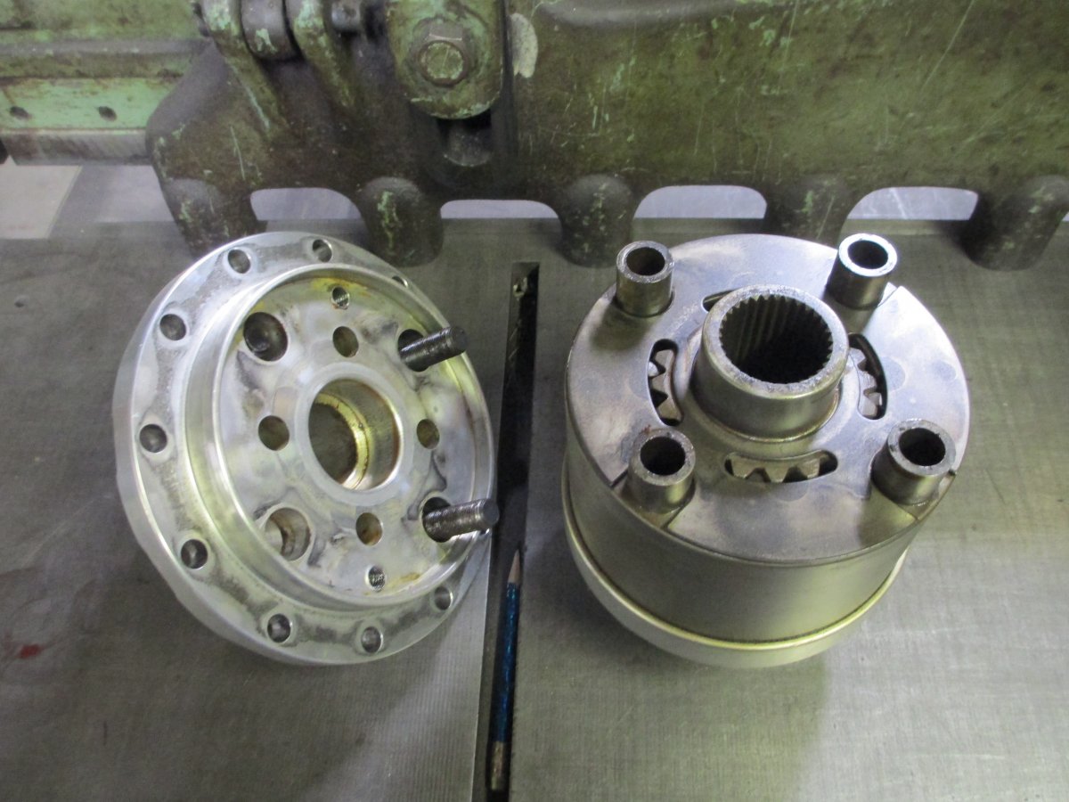

    Bruce, I have a 31 spline carrier, Gleason Torsen ? And a Tiger, polished 4.10 ring and pinion. I know I will need to machine the carrier for proper fit, be assured, I will be contacting you. IMG_3710.JPG IMG_3712.JPG IMG_3711.JPG

    I did some work on Mitch Kim's 29 PU that has the same kick up, he told me the floor required a slot in the center. So, I had planned on a removable aluminum cover, over the arch in the middle. IMG_0983.JPG
