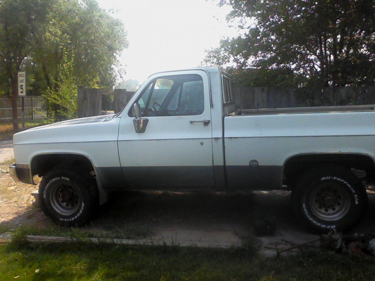

    okay so the truck is a 73 k10 short bed it has 3.07 or 3.08 gears with possi the engine i pulled from a 65 one ton with a pto trans it was a spool truck for a power line company i do plan to drive this everyday its my baby ever since i was 8 years old and my dad drove it i wanted it the lifters are all starting to wear and i was told if thats the case then i should replace the cam as well
    the trans im using is a muncie 4 speed nothing special i know i should buy new heads but i just want mine redone for now until i can afford a set of nice heads they are the 520 power packs the intake is just an edelbrock performer the rotating assembly looks real good i was told the engine only had 80ish thousand miles on it i only paid 25 bucks for it

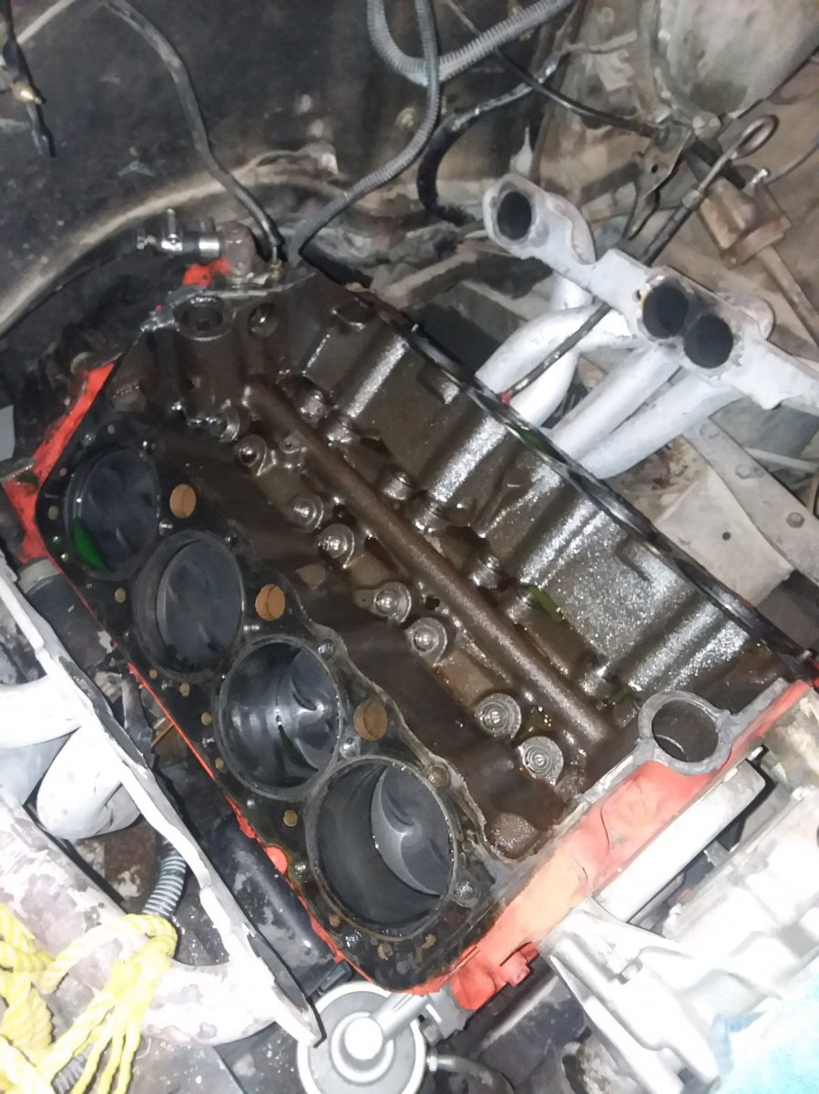

    80,000 miles......I would look at those pistons real close.

    3.08 gears, 31" tall tires and a cammed up 283 is gonna suuuuuuuck. You need a 350 with some low end torque.

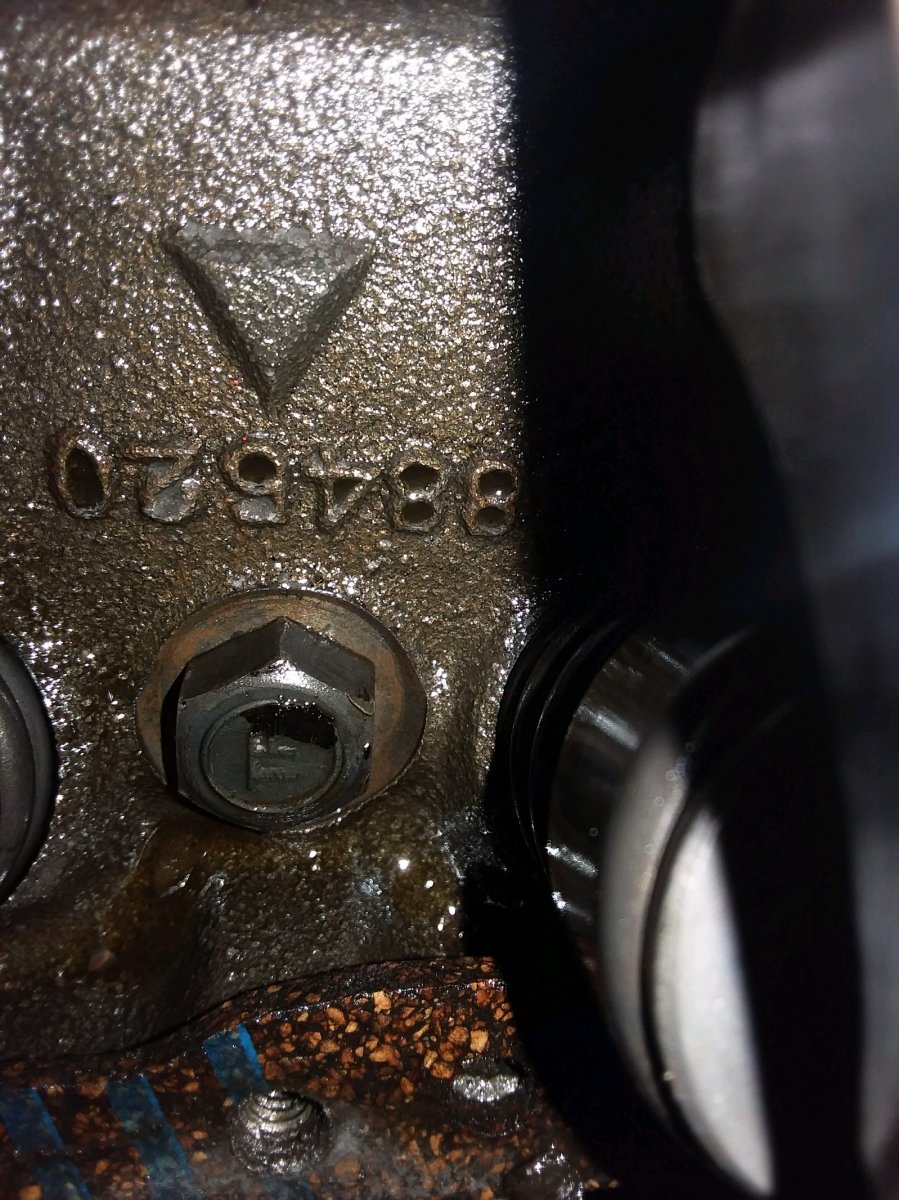

    okay so there are some pictures yes the front clip is from an 83 as far as the heads not having holes ive already worked around that its super simple i simply cant afford another motor this is what imusing believe me when i have driven it it rips and it is quite the little buzz saw this may sound wierd but i like the small ci small blacks you can wing them to the moon with the right parts and they sound better than a 350

    believe me this truck isnt going mudding or really off road im not doing push contests either shes 46 years old i just need to start driving her to get myself through this winter next summer ill find another 4wd k10 and she will become project hot rod i wanna do a four link and a whole bunch of crazy shit so things will be different a year or so down the line
