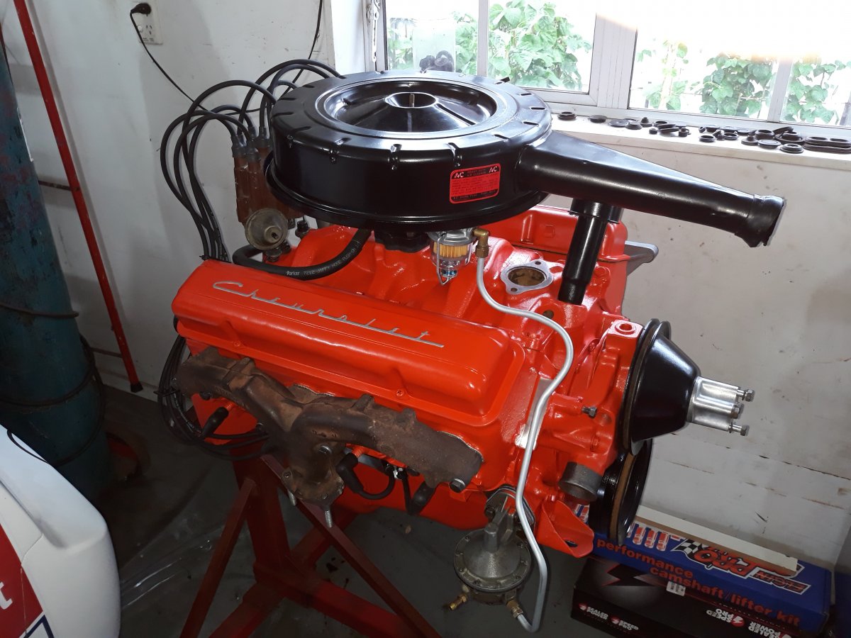

    [I have a collection of them in my toolbox that are used for punches]
    Get on to Northern Auto parts website and look at their Master engine kits. I did that and it was economically viable [even when exported to NZ]
    You are building the same as my last rebuild. [a 283 2 barrel for the street]
    I would recommend converting the carb to electric choke, and filter to spin-on style.
    I optioned for an Elgin #CL1787PK [1200-4200 rpm] 204/204 dur @ 50 .427 .427 lift camshaft. for an extra $68 and a drop-in set of speed-pro VS677 valve springs [$46]that aren't too stiff and will take up to .440 lift.
    I never purchased valves as mine were all straight .My machinist always cuts the valves and the seats [even if the valves were new]
    My total machining was: Hot-tank, Bore Block, Deck Block,Mill head surface, Cut Valves and Seats, and Fit Cam Bearings [from the kit]
    The rest I did myself.
    You will get "nickel and dimed" on external parts [plugs, and leads, paint etc] but if you keep the stock points distributor try and hunt down a genuine GM condenser. [I had 2 in a row fail straight out of the box, so I used the old Chevy condenser]
    The result is a very driveable engine ,with good low rpm manners with a 3 speed non-synchro 1st gearbox.
    I'm too old for "High Strung" engines on a daily basis

    Yes a junkyard pushrod will be fine , they seldom cause issues [except getting lost in the garage]
    Just do a visual check with a ruler to see if it is Not concave at the camshaft end.
    If it is, just move on to the next engine.
    If you look at my photo ^^^ it has front engine mounts [not side mounts] You will need these with a truck bellhousing.
    Chances are a 65-66 passenger car block isn't drilled on the RH side by the fuel pump. So Check Yours!
    Now is the time to drill and tap the block while apart! one of the bolts goes through inside the fuel pump boss, so you need shorter bolts not to contact the pump pushrod. [this also applies to the factory drilling]
    And use sealant on the bolts.
    The fuel pump on my engine is from a 65 Impala .I clocked it so the fuel outlet cleared the front mounts. If you need a replacement get a 4460 pump ,they are already clocked, and cheaper! The main difference is the fuel inlet is at 90 deg from the outlet on the 4460 pump. [the '65 pump is less than 90 deg]

    2 postings above my previous post [that's why I put ^^^ arrows there]
    283 cams are weak!
    With a short 3.0" stroke ,too much duration kills them .
    You want as high lift as possible without increasing the duration [which is why modern engines perform with roller cams]
    Cam grinders a fighting a losing battle with ramp angles so the side effect of more lift is more duration. Too much duration kills cylinder pressure, so on Hi-perf engines they up the static compression to counteract this
    On post # 122 [above ^^^] I recommended a 204/204 dur @ 50 .427 .427 lift camshaft.
    I have real world experience with this Cam and 2 barrel carb
    .440 lift is the most you should go without using long slot rockers and coil bind which require cutting spring seats and different [stiffer] springs.
    By the time you did all this to make it compatible, you could simple drop a stock "dished piston" 350 shortblock underneath everything and get more satisfying results [for LESS $$$]
    If our car wasn't stock with matching #s ,I would've opted for a roller cam 350 shortblock with all the 283 peripherals to disguise it.
