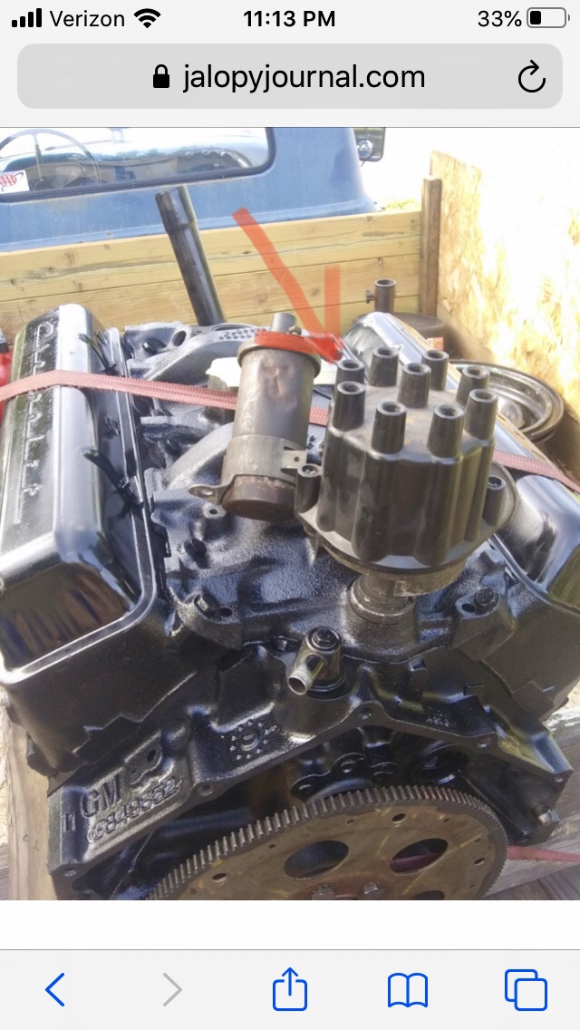

    Pictures.

  10. Fordors
    Joined: Sep 22, 2016
    Posts: 6,303
    Fordors
    Are you referring to the missing plug wires when you say distributor not installed? In the photos I see he marked TDC on the dampener and has the mark lined up with TDC on the timing tab. The distributor has the clamp in place, but that may only be snugged down and not tight. Take the distributor cap off and see if the rotor is just before the position I noted on your photo for the no. 1 plug wire.
    If the rotor is in that position it is as the factory did it at assembly. If not, no matter, just put no. 1 where the rotor points and continue on clockwise with the wires.
    He may have left the valve cover gaskets off because the lifters are not adjusted. Remove a cover and check that there is no lash (clearance) between the rocker arms and valve stems. Also, he has put the fuel pump plate on the block, is the fuel pump push rod in there? You will want that push rod on the heel of the lobe when installing the pump. See that 3/8-16 hole on the front of the block that intersects with the fuel pump rod? Using a bolt long enough to hold the push rod up against the cam lobe just tighten it (even finger tight should do it) and after you get the pump on remove that bolt and put a short one in that hole to prevent a leak. Before you rotate the crank be sure to check your rotor position and mark it on the cap if you don’t have plug wires yet.
    ffr1222k and Mister E. like this.
  11. Mister E.
    Joined: May 4, 2018
    Posts: 475
    Mister E.
    from USA
    I installed the dizzy and had to reach down inside to turn the oil pump shaft to line it up tdc.
    I forgot to check the fuel pump pushrod, will do that tomorrow.
    I have no plug wiresor new plugs as of yet. (That's not an issue)
    What I was referring was the carb not installed and setup, dizzy, coil, valve covers, and the oil filter adapter kit which we discussed multiple times, so I don't know how or why this stuff wasn't done.
    But anyway, I did a finger tight job on the lock down for dizzy and coil, found the bolts for valve covers and did some of the stuff that I saw.
    I will get it together, I just wish it was done like he said he was going to.. I think the biggest thing be the oil filter adapter kit and the distributor/ carb. Otherwise I guess I'll be learning more as I go

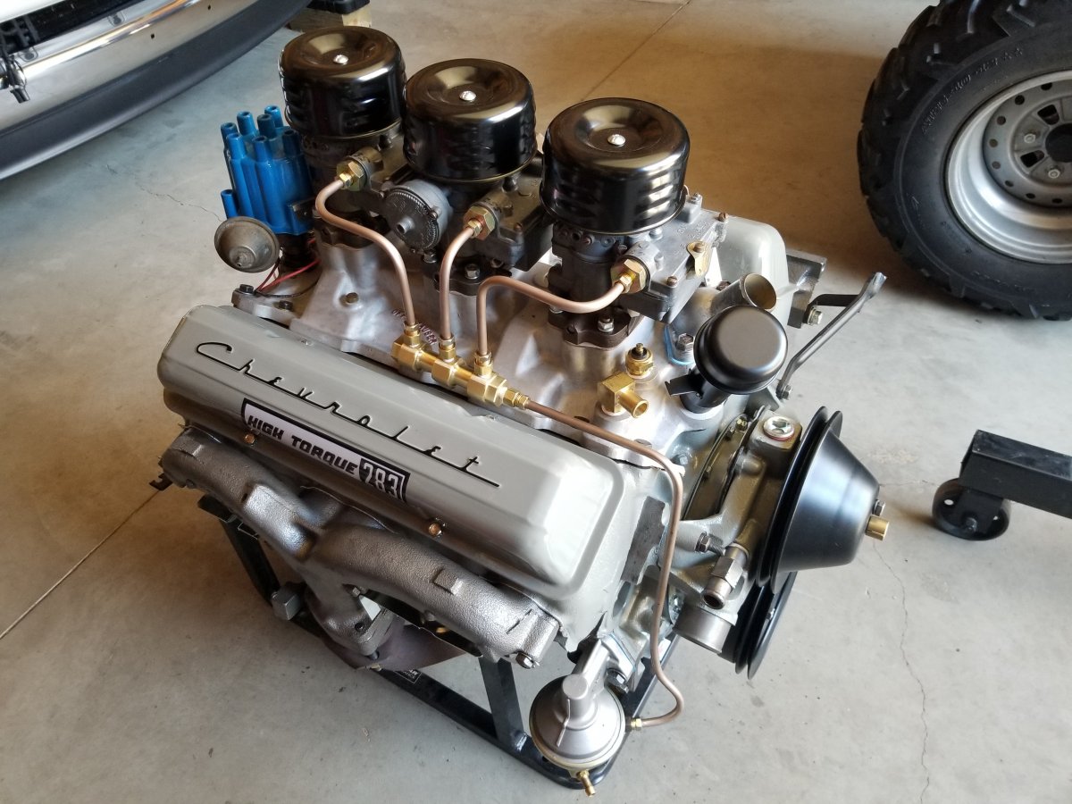

  22. Nitro450exp
    Joined: Dec 26, 2018
    Posts: 23
    Nitro450exp
  23. Nitro450exp
    Posts: 23
    Nitro450exp
  24. Mister E.
    Joined: May 4, 2018
    Posts: 475
    Mister E.
    from USA
    WOW! Sweet looking setup!
    I only just saw this, for some reason I did not receive any notifications of a new post to my thread.
    Anyway, Appreciate the post, it looks good.
    Mine is almost complete, a few parts to get and then should be ready to finalize the install and get back to driving.
