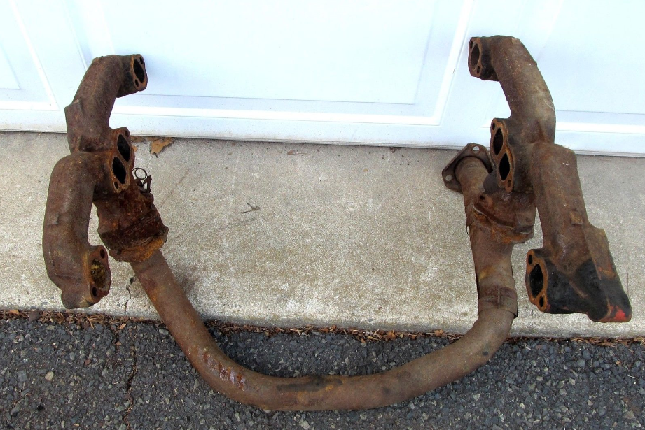

    This is what I would do too, though I might up the diameter of the pipes to 2 1/4" to the muffler, 2" from the mufflers back to the bumper. Taking it all the way to the bumper is really key to avoid droning inside. This would give a very nice mellow tone, not loud, but free flowing, avoiding that "whoooooosh" sound of a stock heavily muffled car, but not annoying or obnoxious. You would still enjoy quiet country roads and not scare animals, unless you were putting your foot into it and hauling ass, but just cruising along it would be mellow and sound great, you'd hardly hear it inside.

    That sounds good. As it is right now I keep having to adjust the manifold studs in the block of the I6 nous they keep loosening for some reason. I've even double nutted the flange to control that part, but now the manifold is leaking by. (Sucks!)

    On a stock 57 Chevy the RH pipe runs around the front of the engine and the LH side tees into it.
    It is a terrible system. seen here.
    On our car we set it up like dual exhausts at the front. The R/H pipe crossed over between the bellhousing and the transmission . this gives adequate ground clearance .
    Where the 2 pipes merge we used a 90 deg bend and spliced it in smoothly to the L/H pipe.
    If you want to save $$$ [as We all overspend] Use your existing exhaust from the muffler back.
    A screaming 235 would probably push more air down the exhaust than a higher geared 283

    As far as exhaust, are there any Y pipes ready made, like I know they have for 350 and 400, or would I need to have a Y pipe fabricated?
    Also, I noticed you mentioned thats for a 57 chev, and I know for some parts even a year off makes a difference. Since mine is a 58 I'm wondering about that.
  6. Mister E.
    Joined: May 4, 2018
    Posts: 475
    Mister E.
    from USA
    I saw one of those online for sale, was wondering about that and if I should go for it or steer clear of it.
    Anyway, I have a single straight pipe here trying to match it up to 1 of the manifolds and have been thinking of getting another one and starting the exhaust with 2 straight pipes and merge them into one behind the engine/trans.
    I don't have a diagram to show what I mean, but merge the 2 pipes at the cross member for the trans and then run a single straight pipe to the existing pipe that I already have setup with brand new muffler that I recently put on going all the way out the back to bumper.
