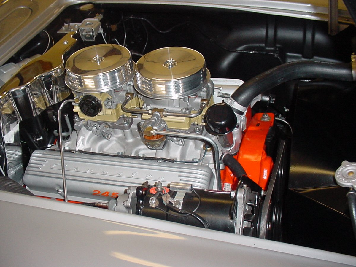

  17. You bet, If I were closer I would take it and even buy you a case of beer.
    What sbc could be considered more traditional? HRP
  18. That's a darn good looking engine. HRP
